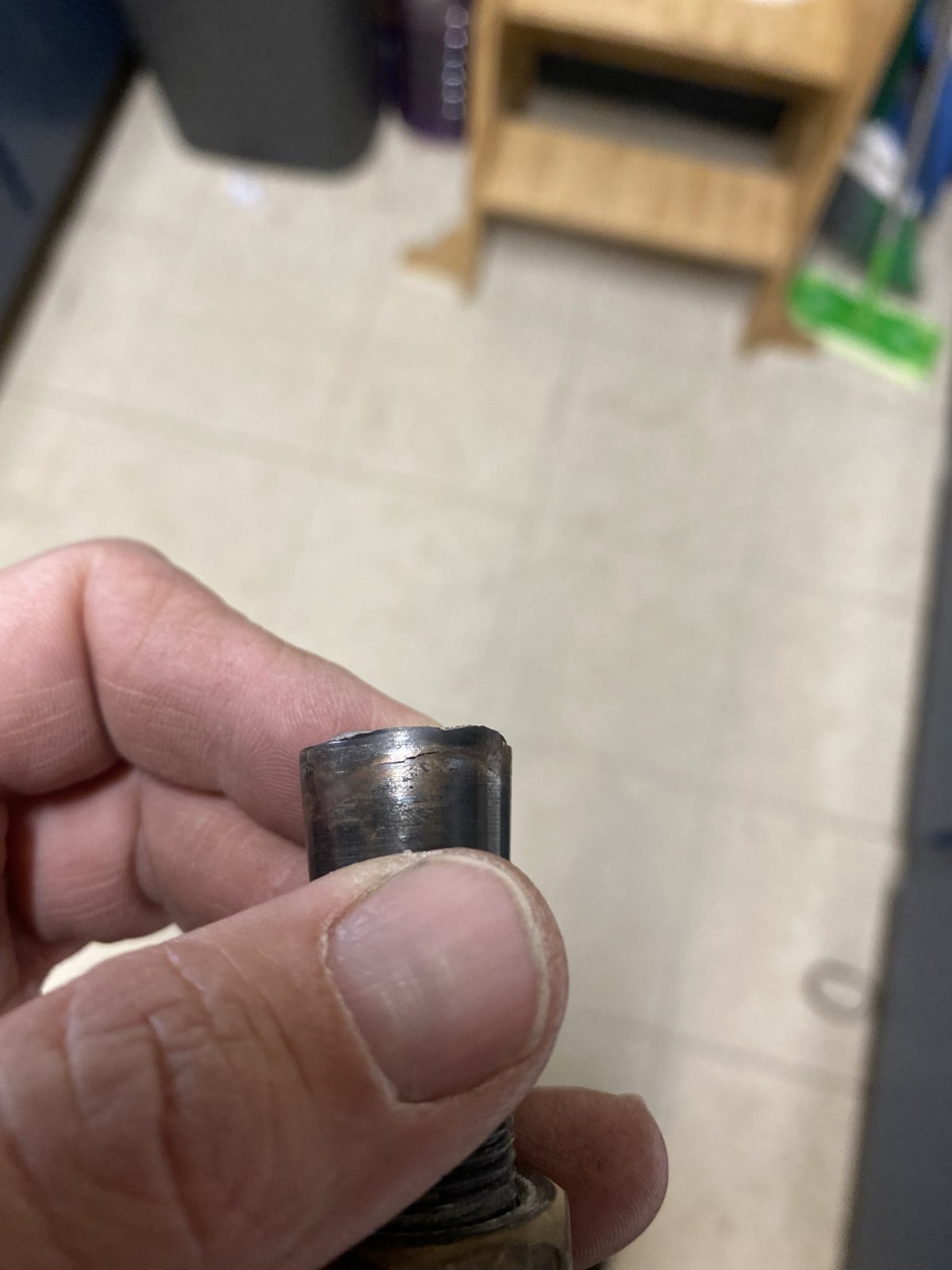

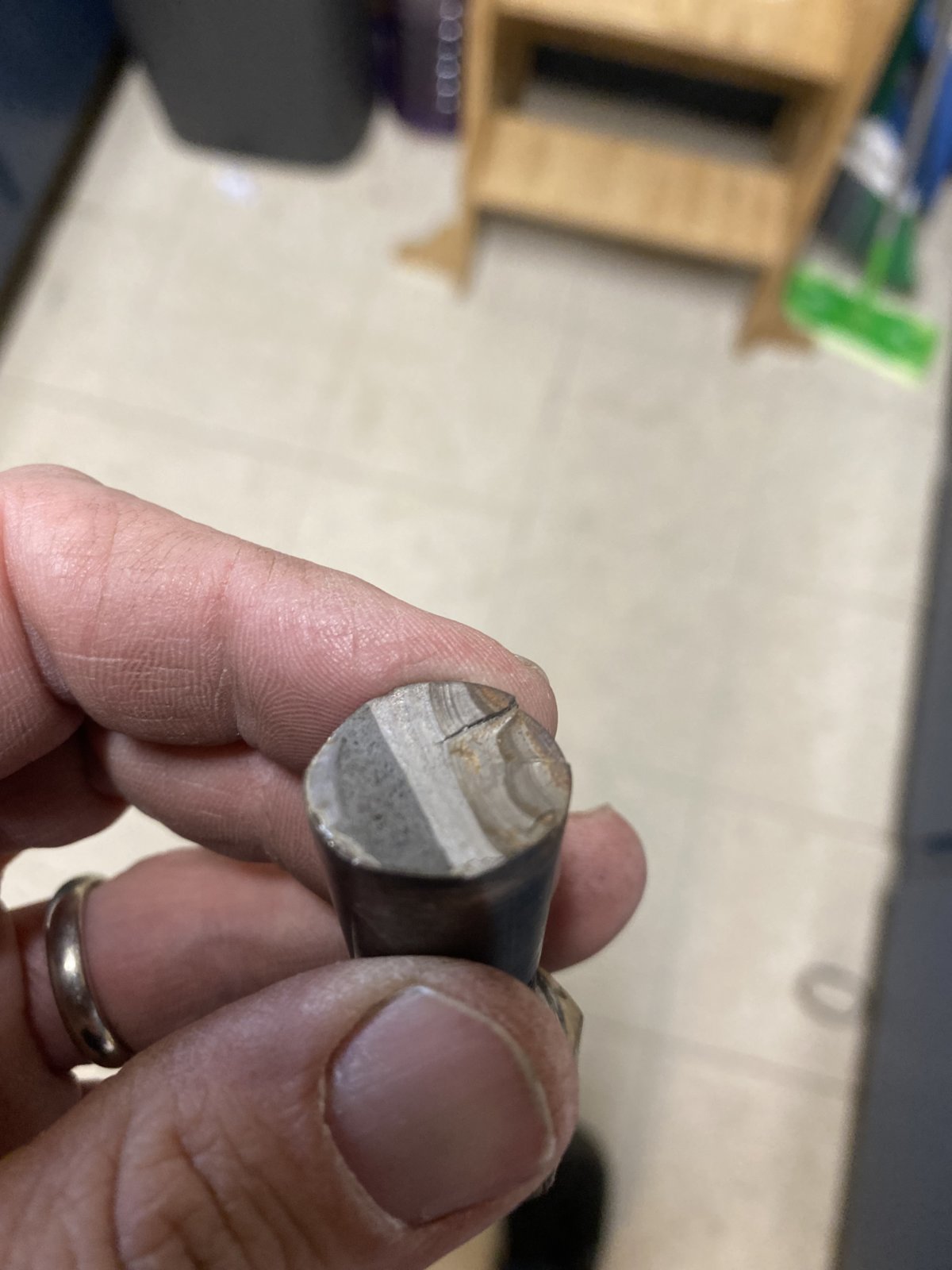

    This will highlight the one issue with the EMF. I have reached out to EMF themselves just to inform of thr failure. Haven’t heard anything back. More a FYI notice.
    We will measure the upper and be ordering to swap to UniBall uppers.
    I will say the longevity aspect of the EMF are nice. With their serviceability also. Maybe just not translating well to our application? I don’t know. I’m. Not an engineer by any sorts. I’m just the guy who builds and fixes the stuff engineers design.

    They just weren’t meant for the abuse we are giving them. All there really is to it. Uniballs should be able to make it a season with next to no maintenance. And that alone makes it worth it to me. I prep my truck every off season (as should everybody). So it doesn’t bother me in the least to replace uniballs at the end of every season.

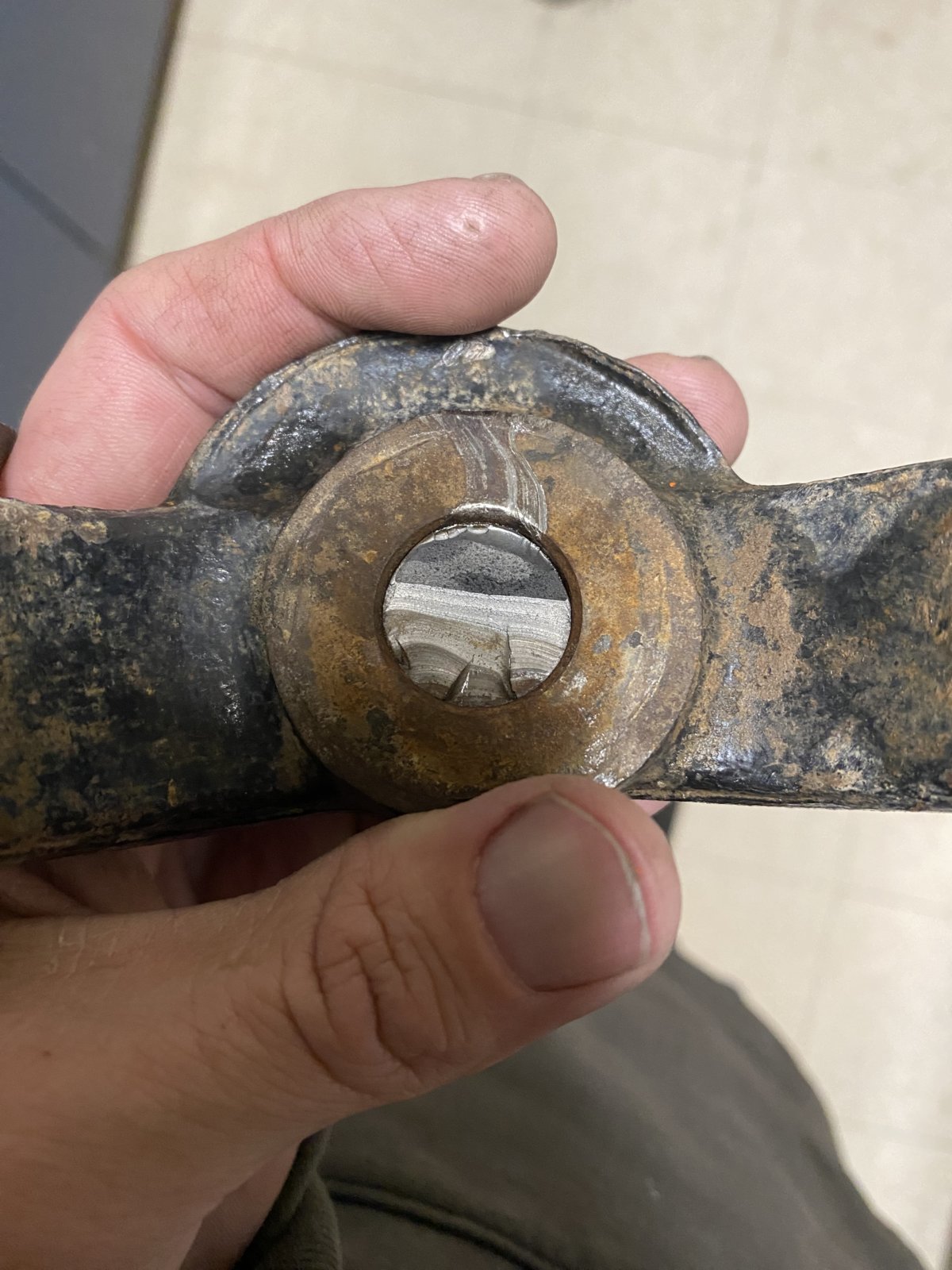

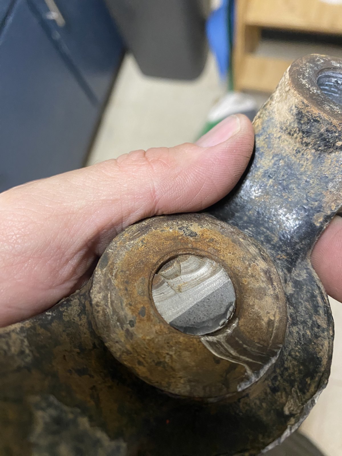

    One side swapped out. Can see where it started a second crack. Right at the transition from the taper to the non tapered part.

    After replacing the passenger side. It has and obscene amount of play it in for 3 months of use. Mostly street too.
