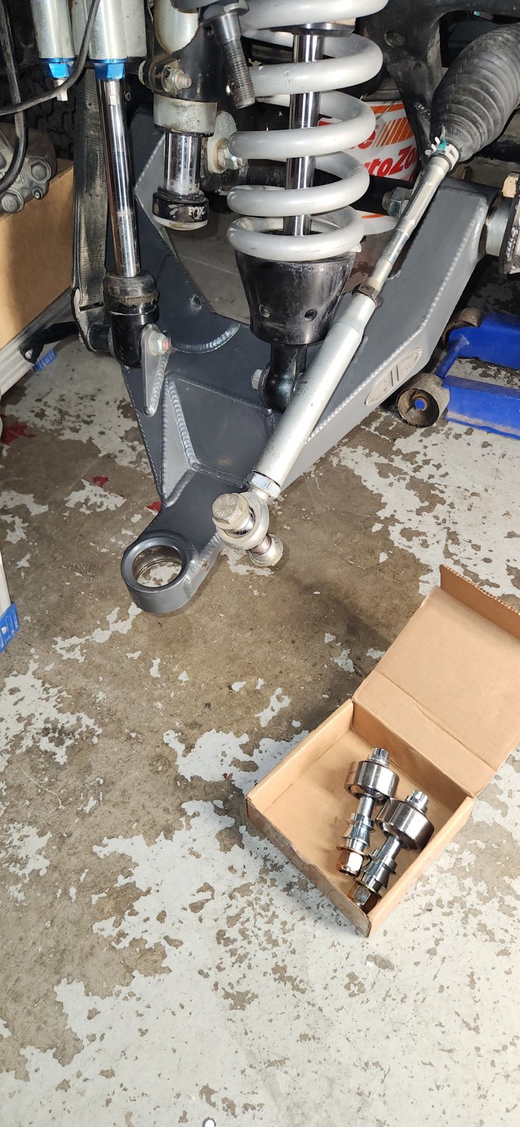

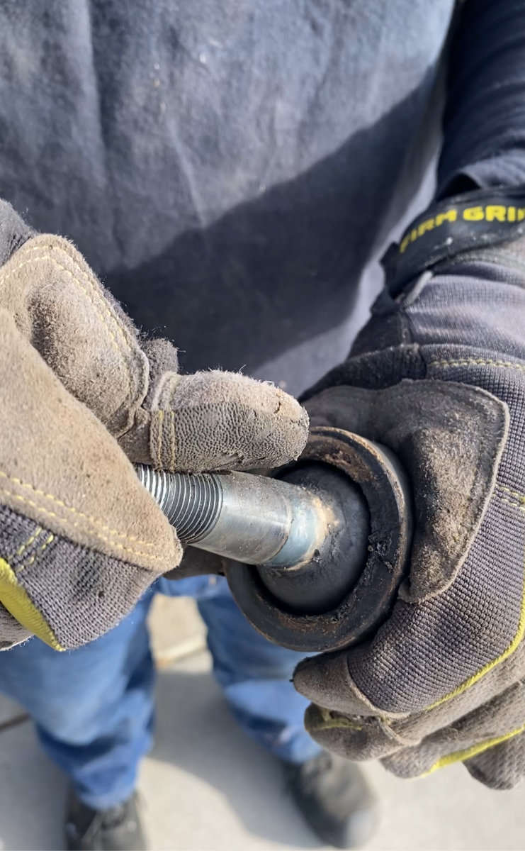

    My EMFs were fine. I always added more grease. Probably too much, as Harry and Christian would complain haha.
    The biggest issues was my top caps turning.
    I'm happier with uniballs now

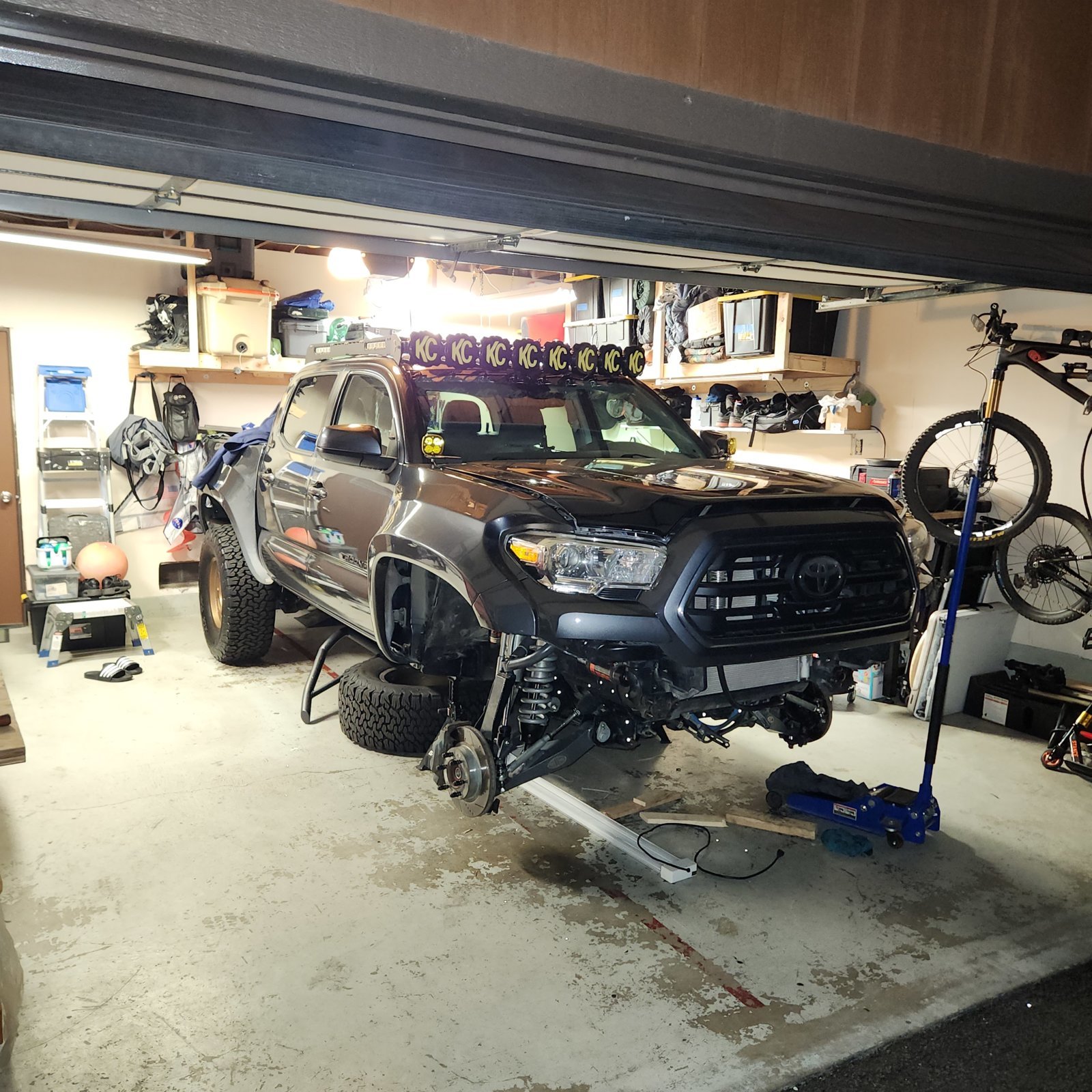

    Few more things to button up and ready for New Years in Ocotillo after a quick stop in Parker to laser scan some F550 parts
    JD FAB front to back

    That’s probably what happened was the top caps backing off or something. Idk all speculation. Lowers good now. Uppers will be swapped soon.
    Nothings perfect. Unless you stay completely stock never leave pavement and just replace all at 100k anyways.

    That’s exactly what was happening. Paint marking told my story. There is an immense amount of pressure being applied to these top caps, then you add steering in. They won’t tighten, but they sure will loosen.
    I feel like lots of guys are probably just fine with the EMF’s if they aren’t jumping or blasting whoops. But for those of us who are. Uniballs all day long.

    +4 with ADV fiberglass

    Didn't lose any steering feel with the LCA uniballs compared to EMF. Maybe a stock truck with smaller tires would feel stiffer, but +4 on 35s feels the same at the wheel. Steering returns to center well also.

    Considering mine were apparently wearing like poo. My steering got better. So it’s definitely a YMMV deal.
