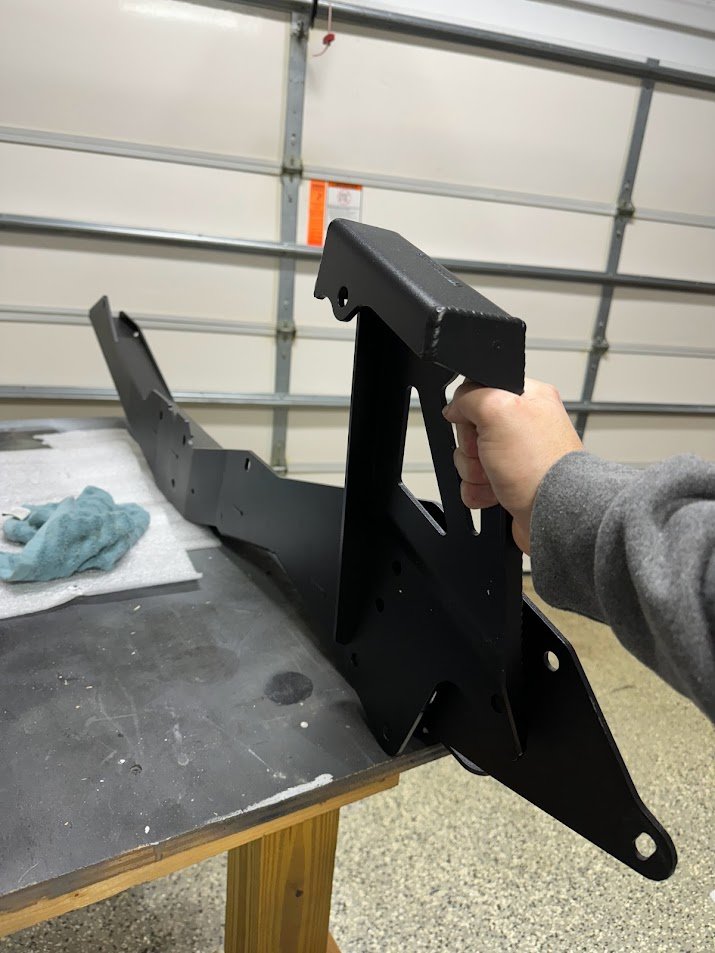

    These are BEEFY.

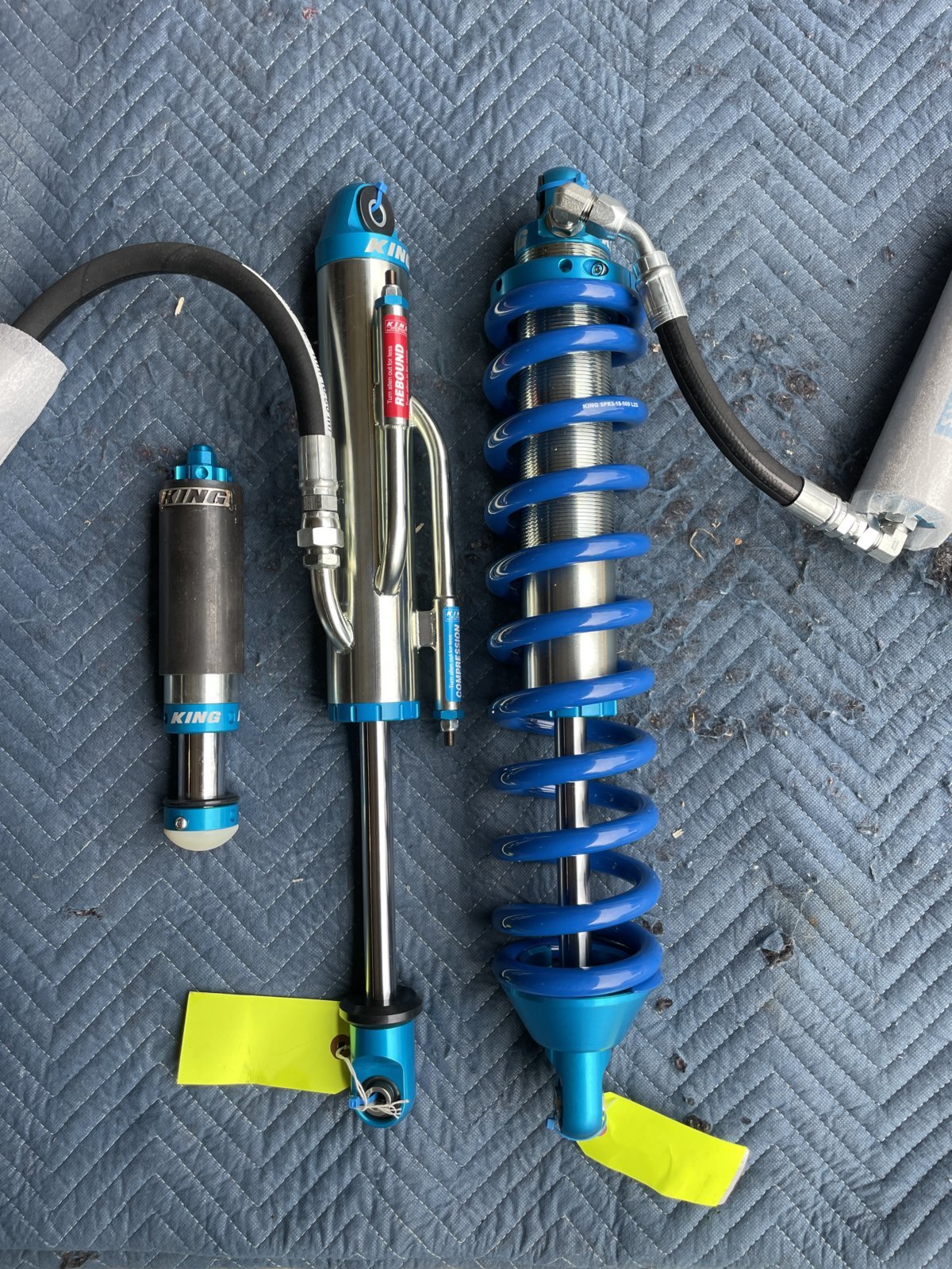

    Shocks arrived today. And was told the 2.25 kit is a 6-8 week wait ;(
    Edit: added picture of said shocks. Found out I need a taller spring plate…ffs ;(

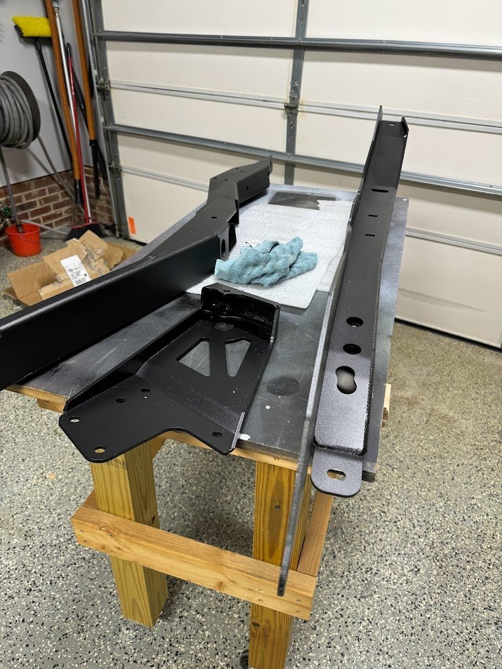

    The Frame Brace Kit is no joke!! It's all beef..
