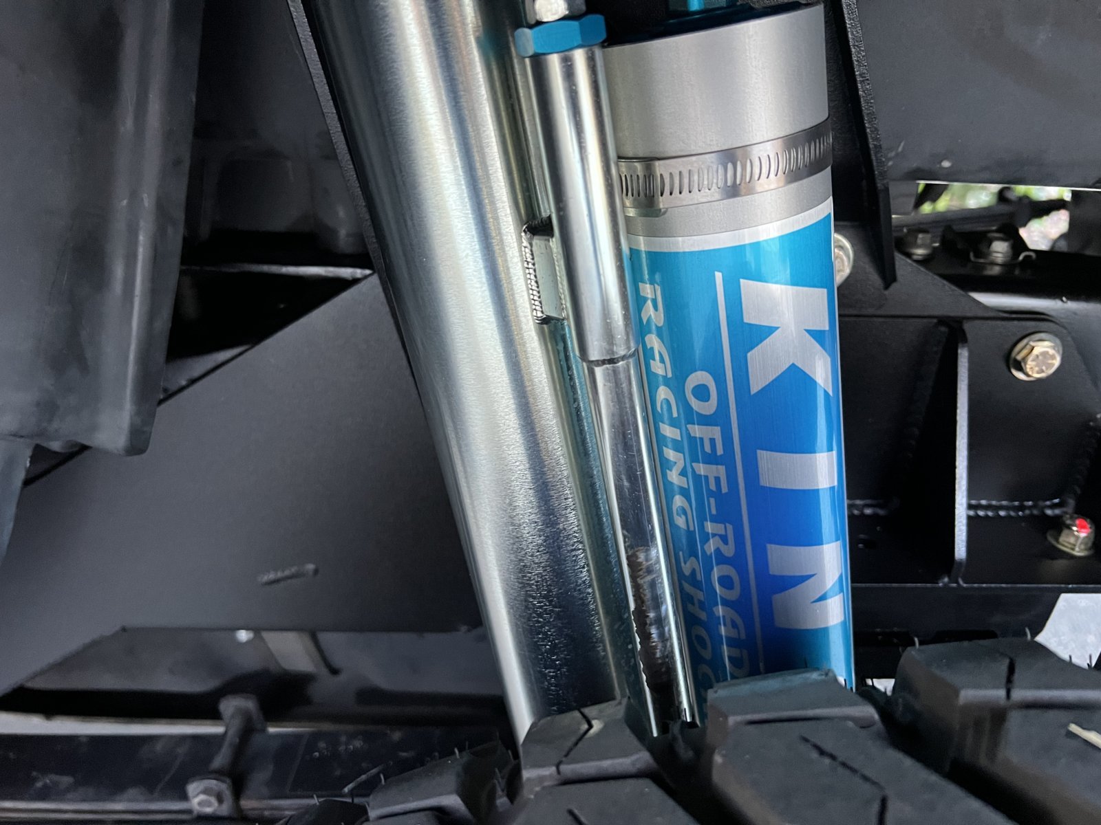

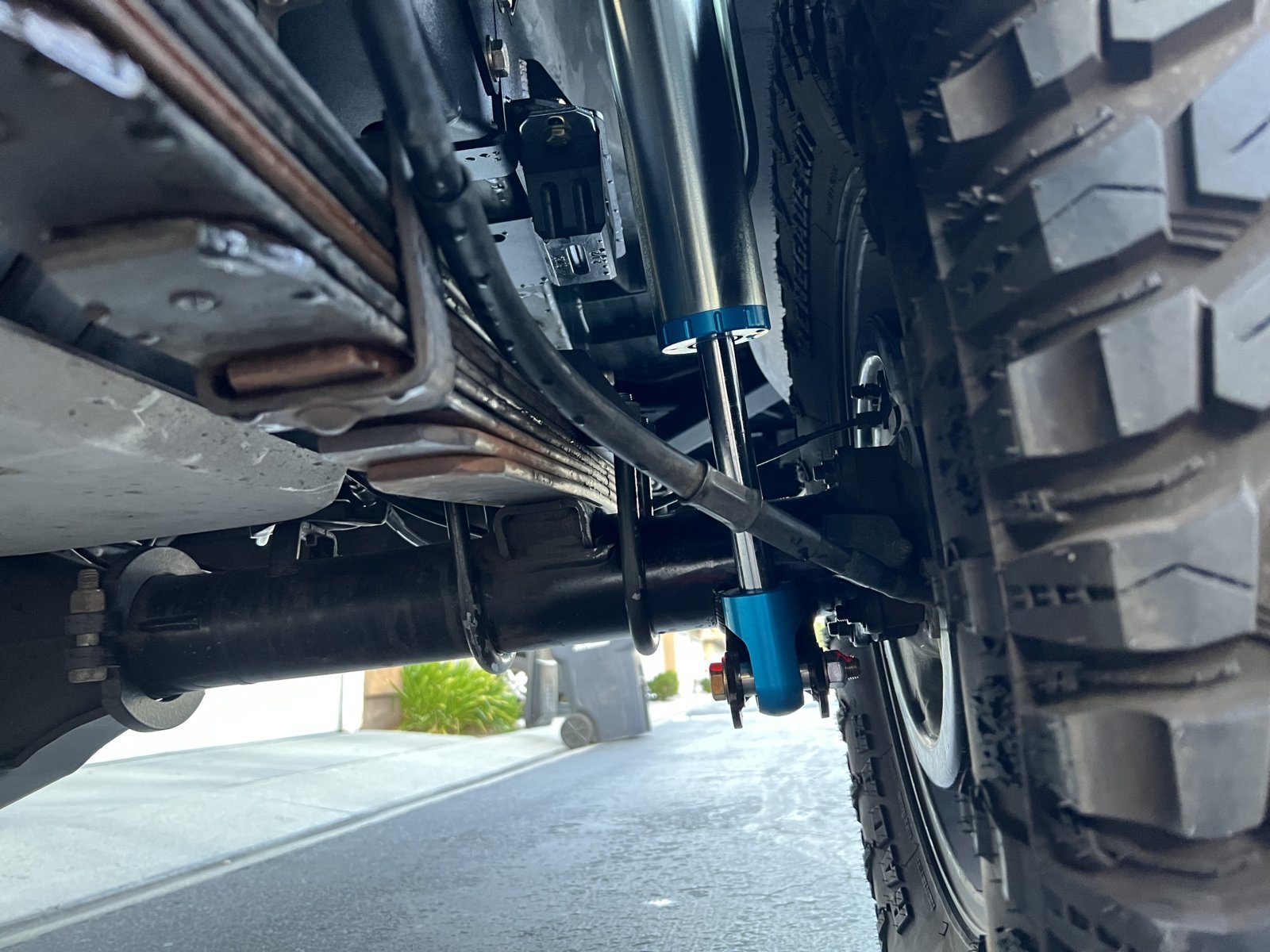

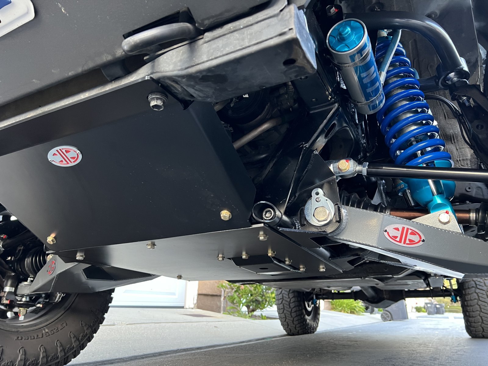

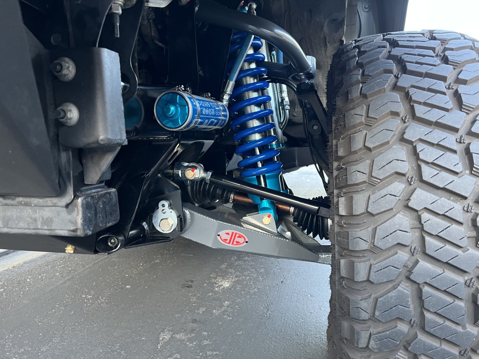

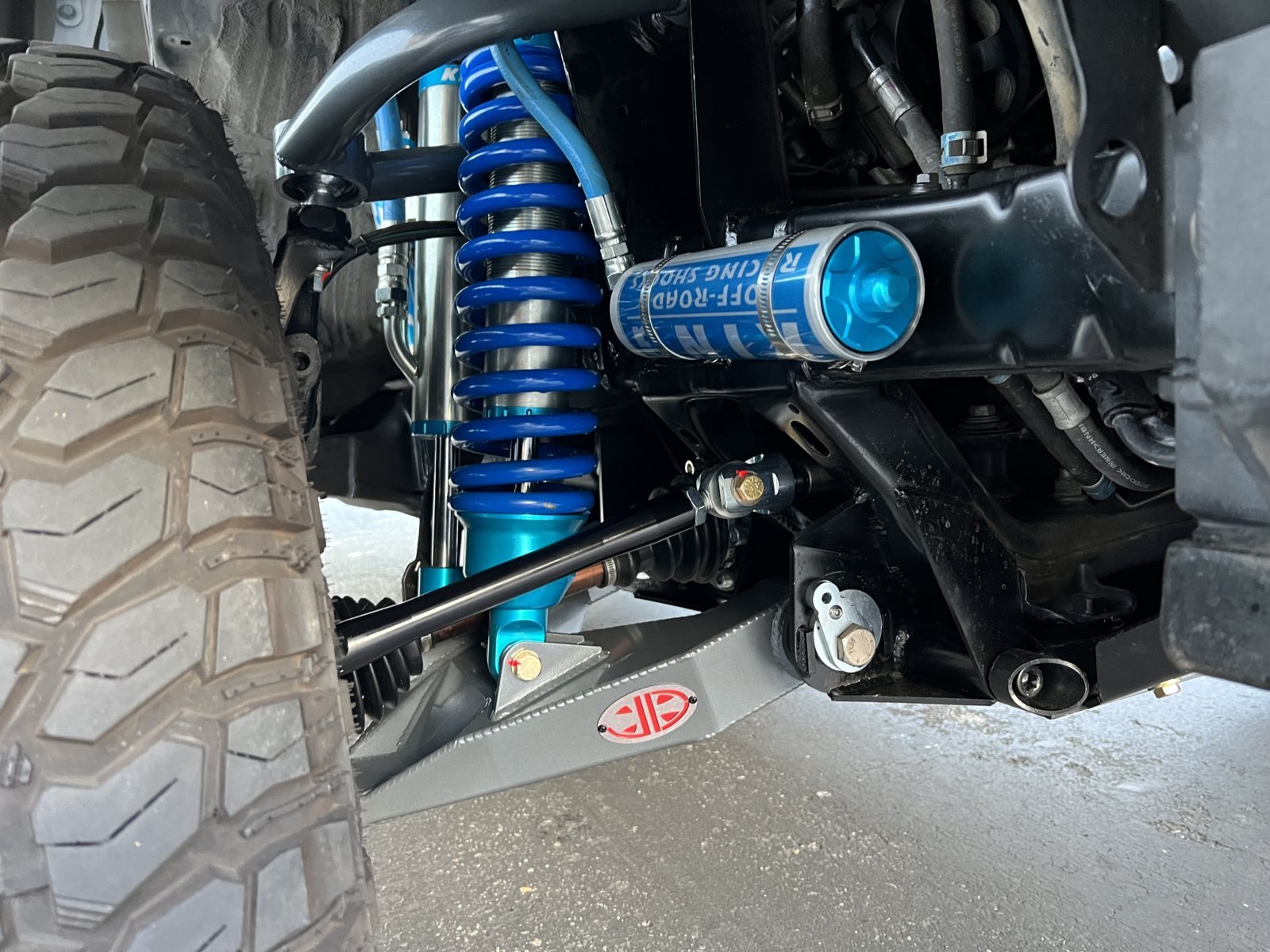

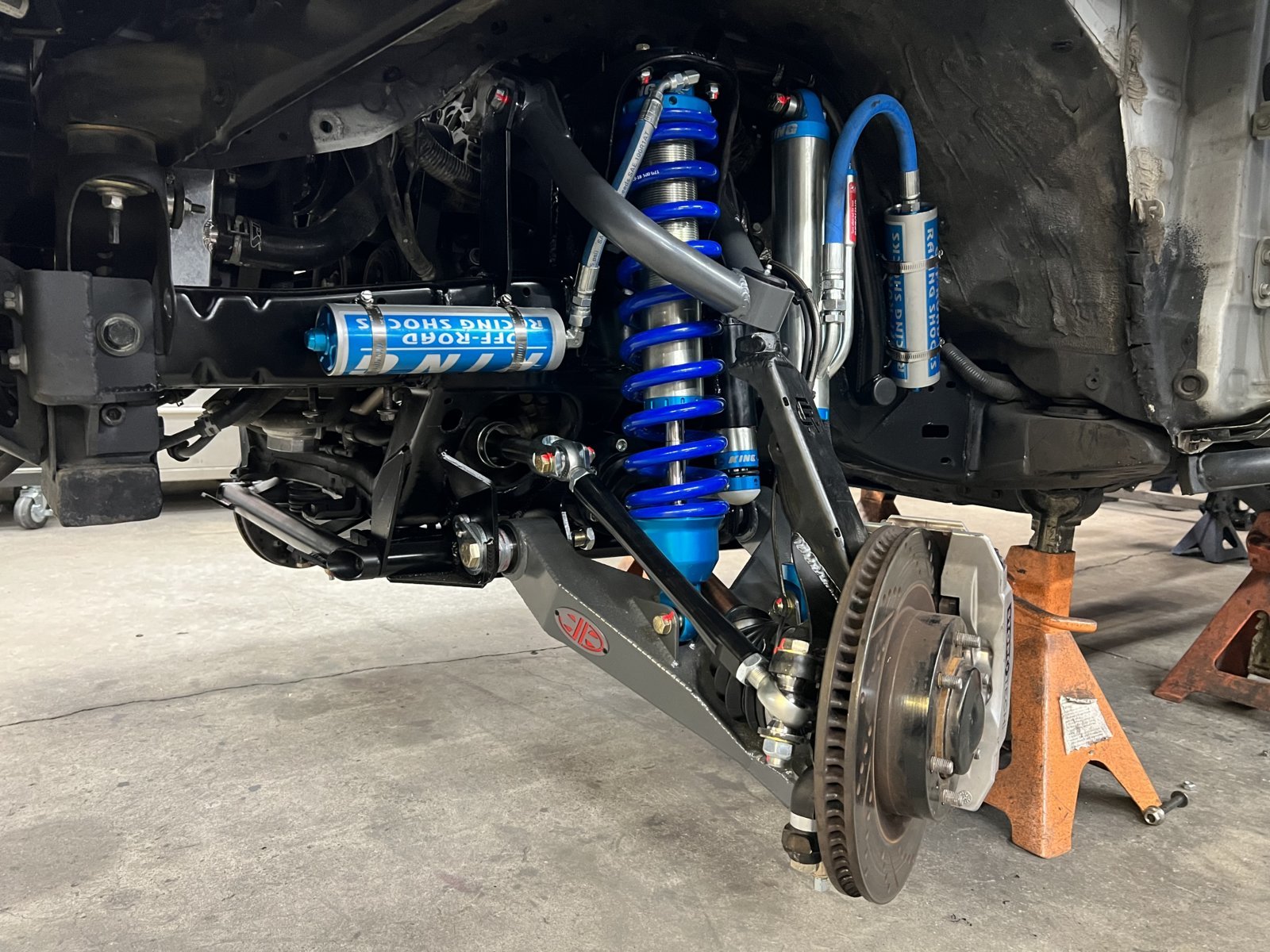

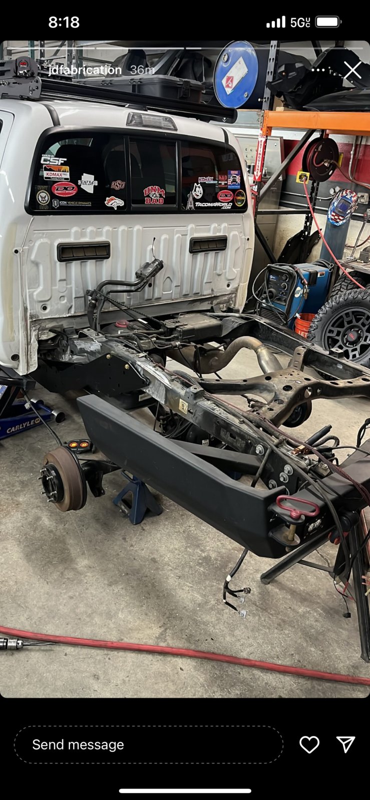

    Huge shout to Jesse and crew at JD Fabrication.
    They did a phenomenal job installing their 2.5 LT kit with pivot kit up front. The rear has the frame brace kit with shock relocation. Will eventually add SUA as well as adding the Howe TC pump steering kit.
