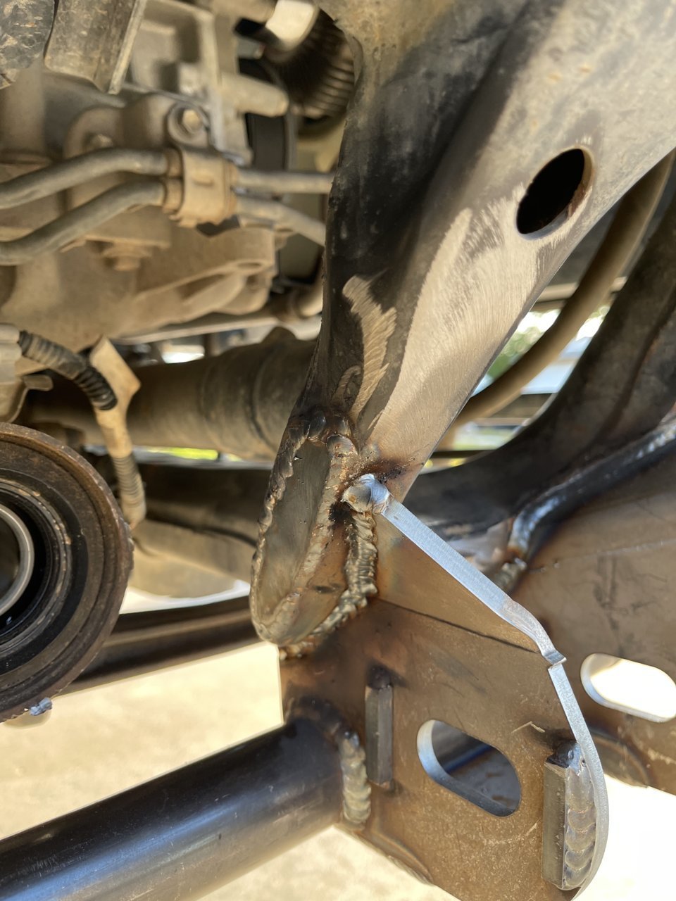

    I’m looking to call JD fab and see if they can make a complete set of axles with the 934 CV’s for +3.5 long travel. However Im using the dirt king cam tab alignment gussets. Will 934 cv axles work with these or do I need to convert to JD fab cam gussets?

    The cam tab gussets don’t matter what CVs are in there. Or vice versa. I’m sure they can make you something for +3.5, you’ll just need to notch and cap part of the frame for the CV.

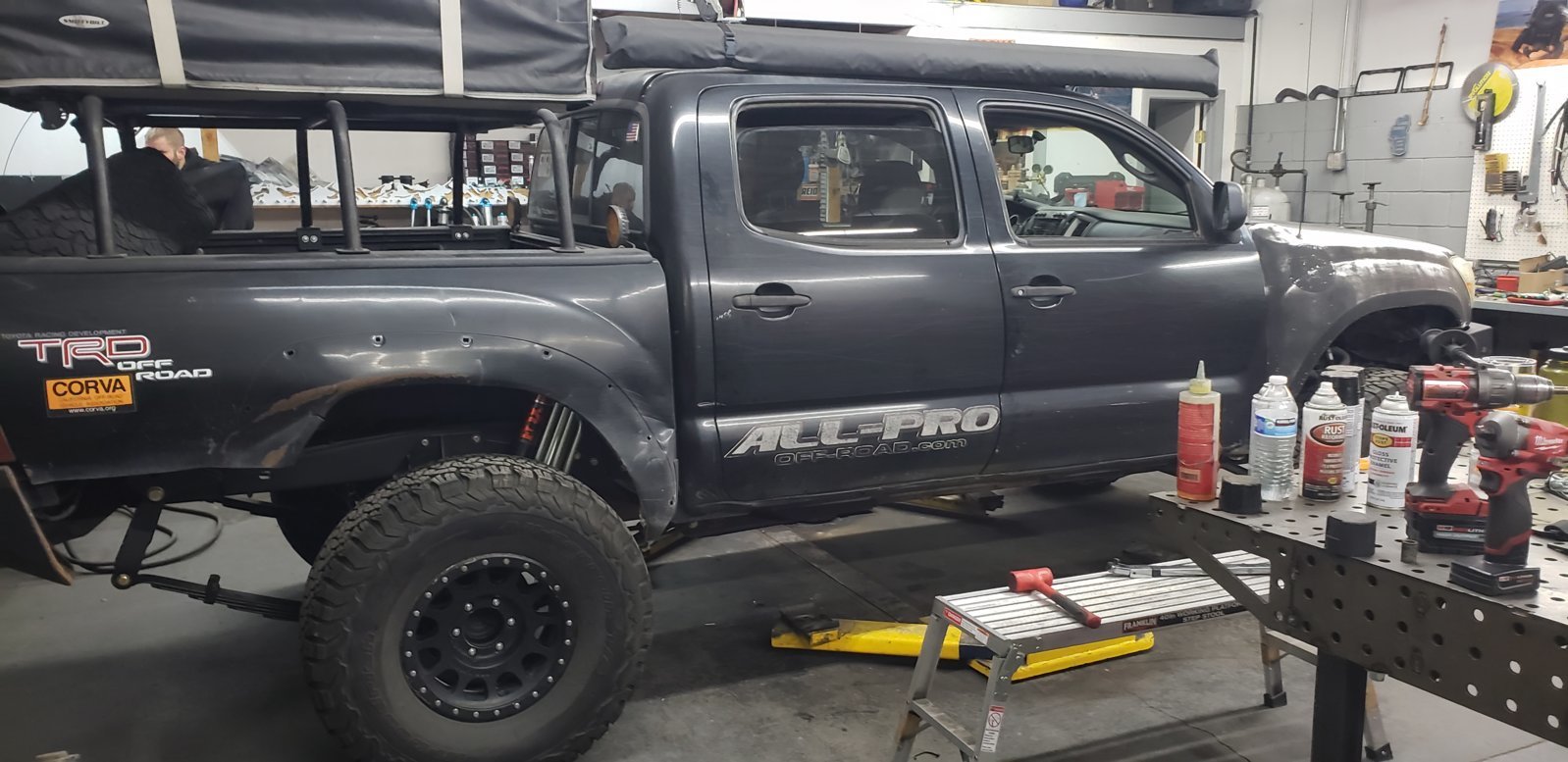

    Wonder if these bypasses will make a difference..
    Slashaar, Ricardo13x and RonRon23 like this.

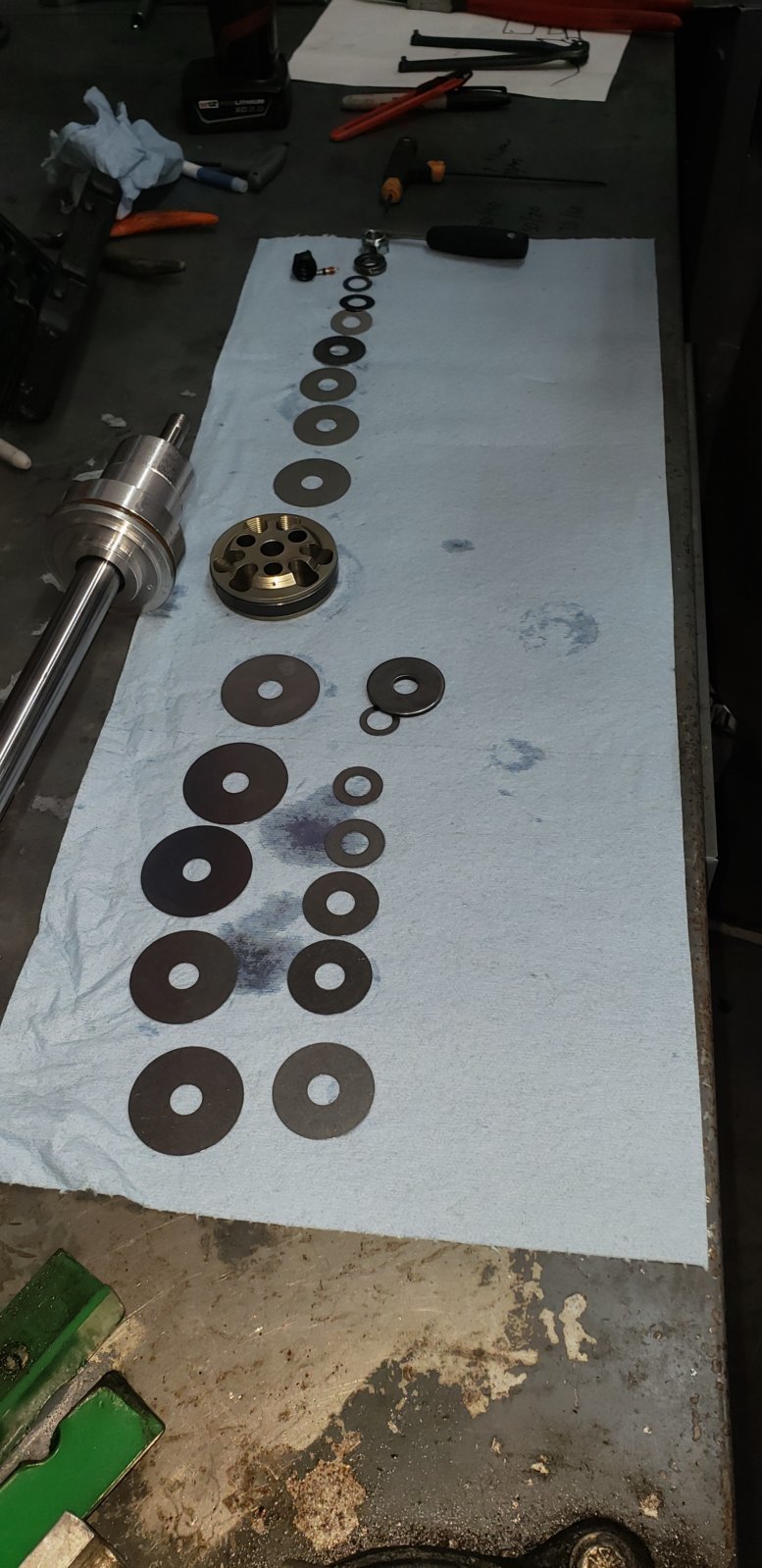

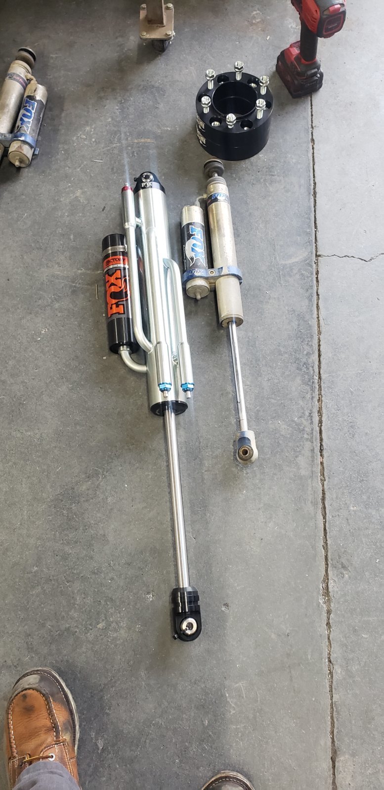

    A peek inside..
    Shim stack 15/12 and a nice thick stack of face shims..

    Are you planning to revalve?
  13. Feb 18, 2024 at 4:22 PM
    MonkeyProof
    MonkeyProof Power Top
    Oct 7, 2008
    #9774
    12,839
    SoCal- SGV
    I'd like to get a few rides in and get a base feel first before anything. We just wanted to see what the valving was and how much oil we needed to add. Both sides were about 1.5 - 2 cups low.

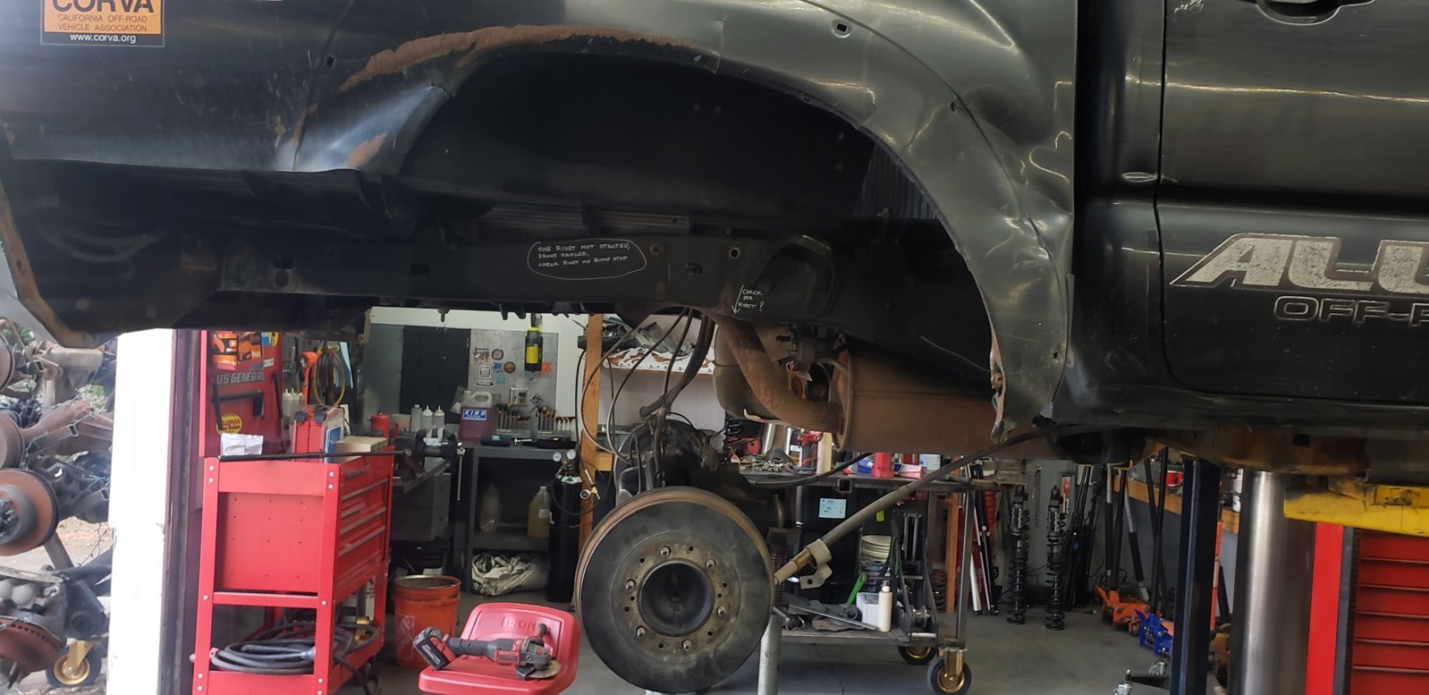

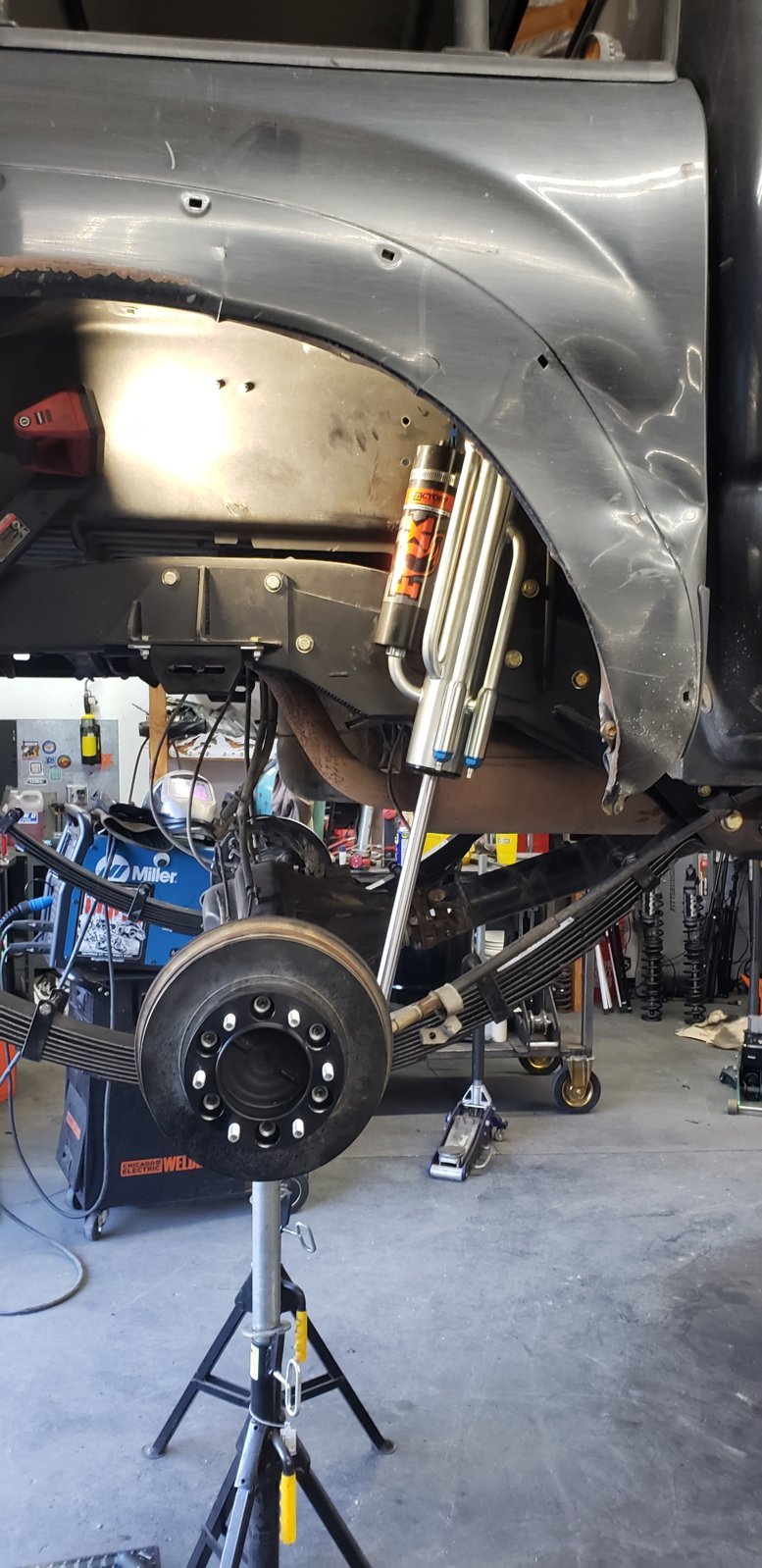

    Wheel base before install 129"
    after install - 127"
    Slashaar and BEAR_KNIFE_FIGHT like this.

    Back to stock lol. What springs?
  17. Feb 18, 2024 at 6:48 PM

    Check your axle hits the bumps. Looks like you got the same ones I did. For a truss, Need to modify and move the bumps forward

    Things just got interesting. Why the drastic wheel base change? I’d also like to see way more shackle angle at ride height. I was advised to shoot for 35-45° shackle angle at ride height
