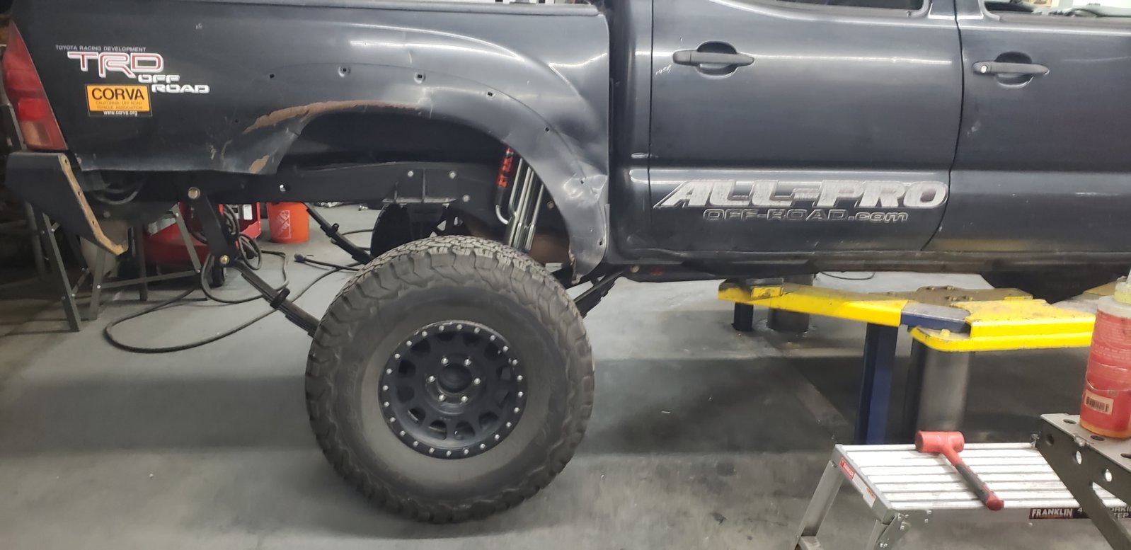

    That ride height shown was the first time back on all 4 wheels after lowering the lift all the way down and not what its really at now. I just got back home after driving 2.5 hours from the shop. Ill get some pictures tomorrow at work during day light and see how the angles look.
    Edit: The Spring Perches have one hole for the leaf pack centering pin, probably be a good idea if they had 3 holes. I think our solution will be to drill a new centering hole on each perch to bring the axle back.

    Here's the ride height after about 120 miles of straight highway
    Full droop before resting on the ground for the first time

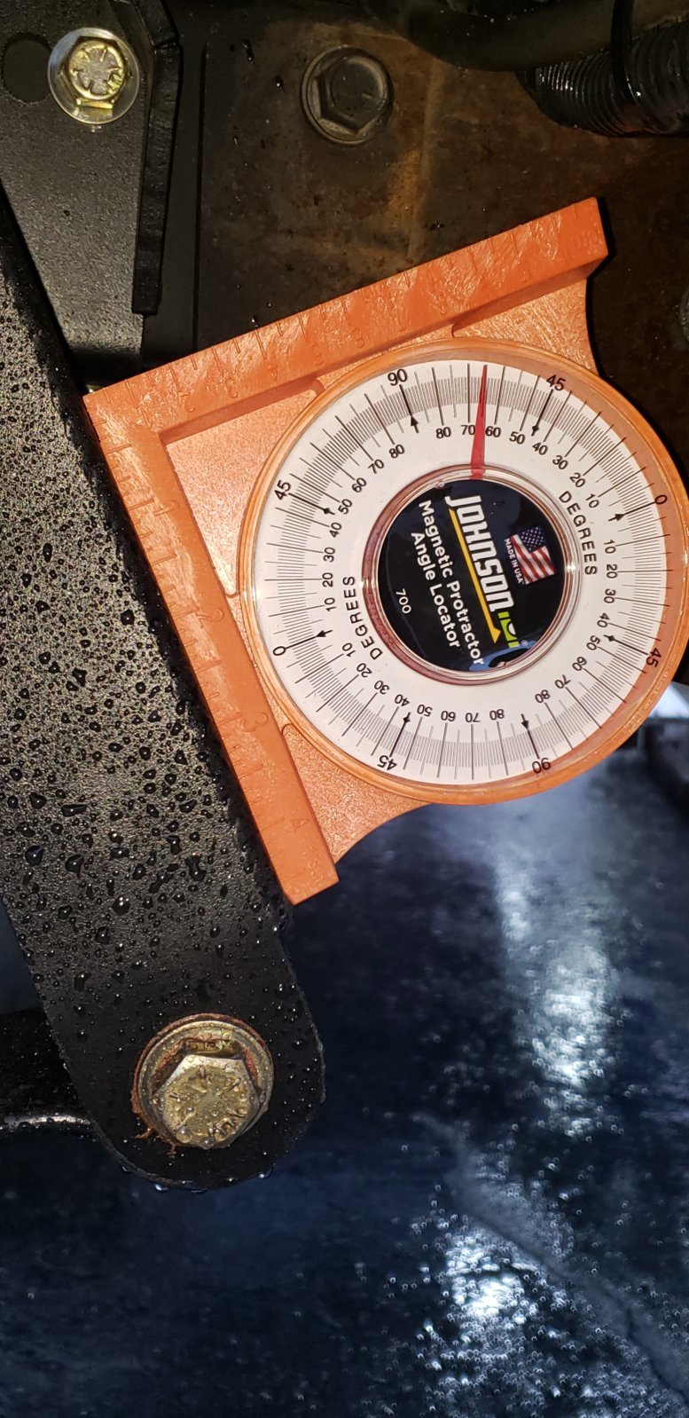

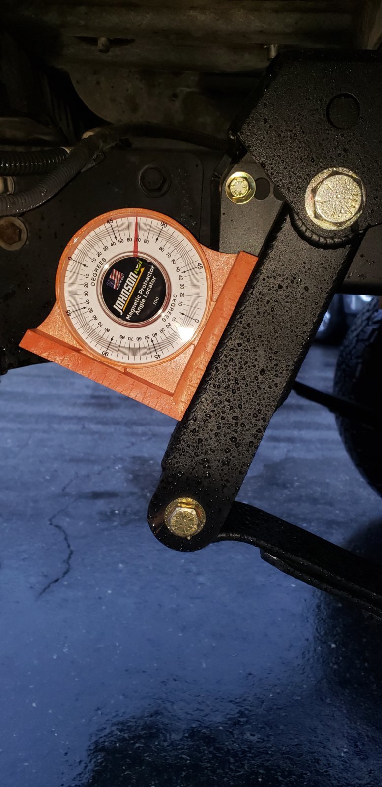

    @MonkeyProof to give a my numbers. With the truck light right now. Aka very minimal for DD. With my super scientific iPhone angle finder. My shackles are 28-29° at right height. 3/4 tank fuel.
    H70D and 9” shackle.
    MonkeyProof likes this.

    MonkeyProof
    MonkeyProof Power Top
    Oct 7, 2008
    #9774
    12,839
    SoCal- SGV
    Right on!! Ill take a peak later and get an angle hopefully tonight. Im so busy at work I havnt had time to look anything over yet.

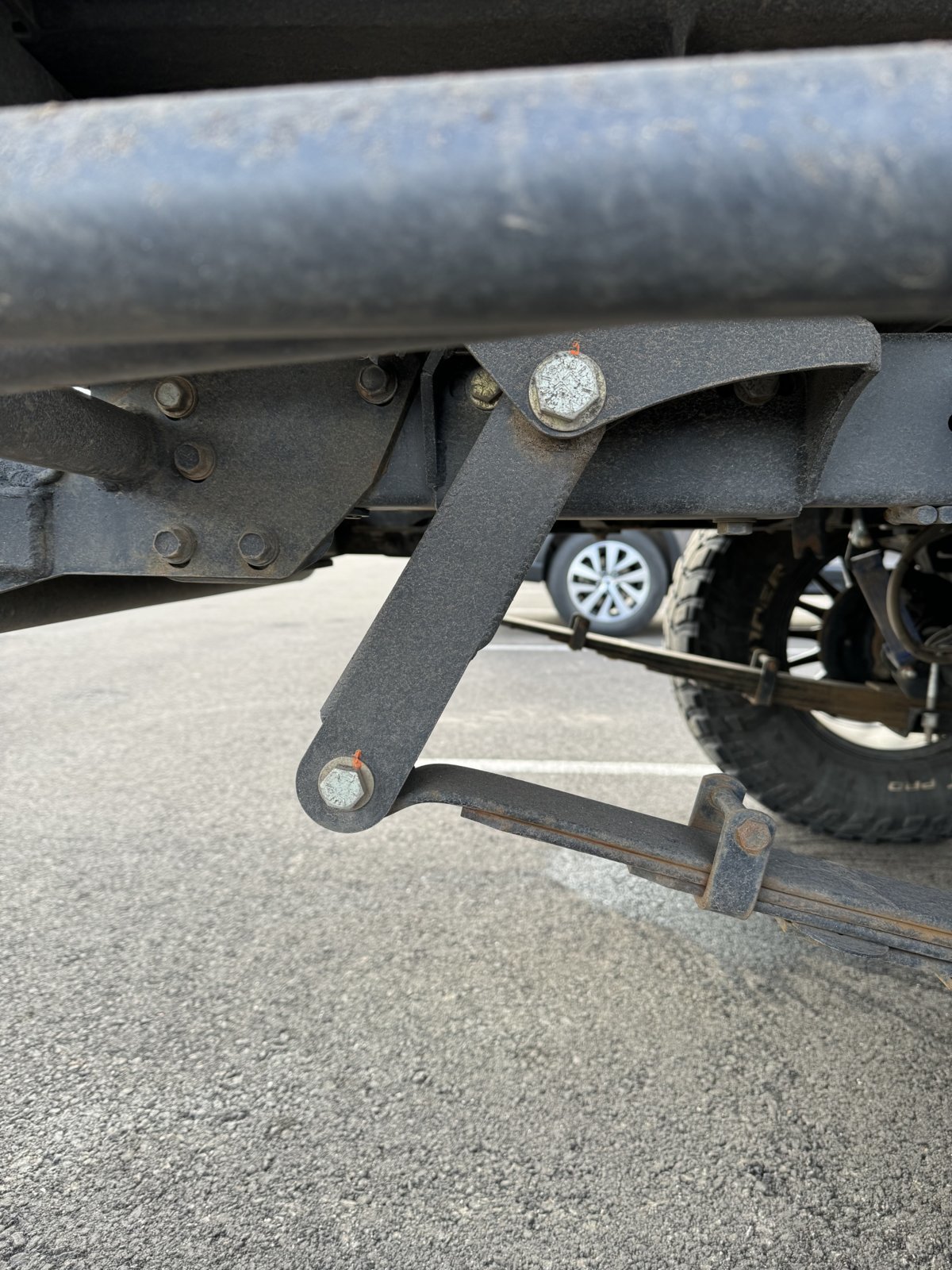

    One thing I'd like to know is the distances of the Top Shackle Bolt with the Hanger in the most forward position and the front Leaf Spring Bolt between the Non Frame Brace kit and The Frame Brace Kit. Trying to figure out why my wheel base decreased so much.

    That I couldnt help much. But my rear shackle mounts are in the middle position. Planning on moving them to the one spot forward to see if it lifts its a little bit. Or rear? Idk, have to call to verify

  16. Feb 21, 2024 at 5:59 AM
    Slashaar
    Slashaar Trail Limo Supreme & Certified Hole Massager
    Nov 23, 2017
    #236717
    15,553
    Josh
    Kansas City, MO
    2015 Tacoma TRD-Sport DC LB
    Coastal HC Front, 6112s+650lb King Coils, JD 62 Swap + 14" Fox 2.0s
    Closer to the cab will lift.
  17. Feb 21, 2024 at 6:47 AM
    MonkeyProof
    Oct 7, 2008
    #9774
    12,839
    SoCal- SGV
    Angles with full tank of gas and full size spare with maybe 130 miles of pavement..
