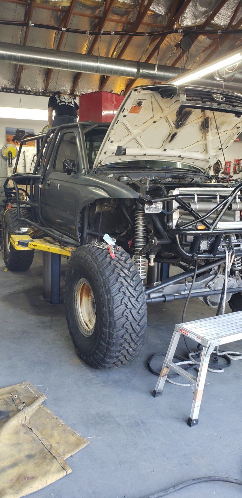

    Im at his shop at this very moment helping to get this thing road worthy..

    Nice! Though I'm not sure how road worthy that thing will ever be haha

    lol...more like "road worty"
