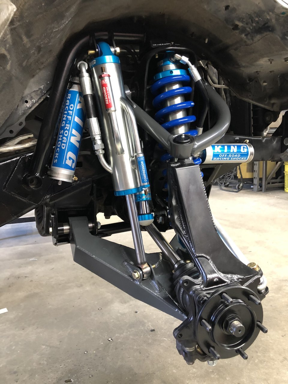

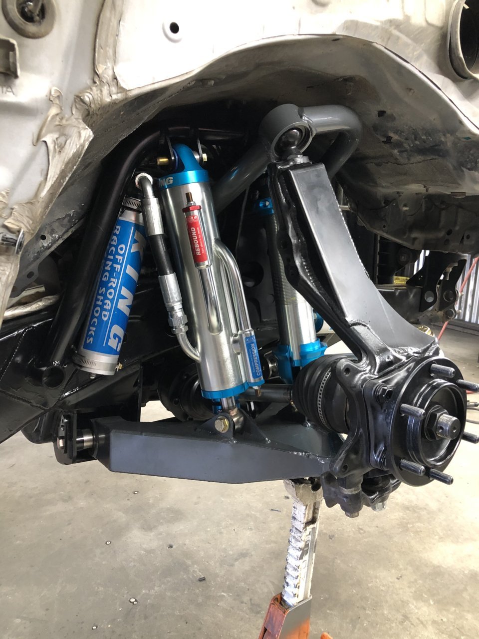

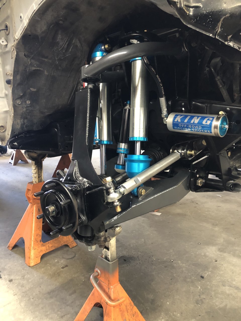

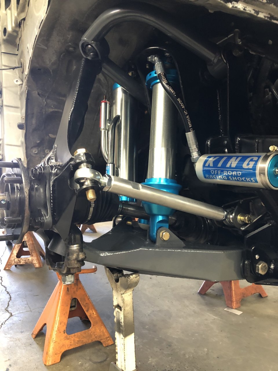

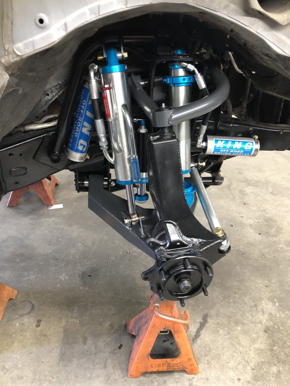

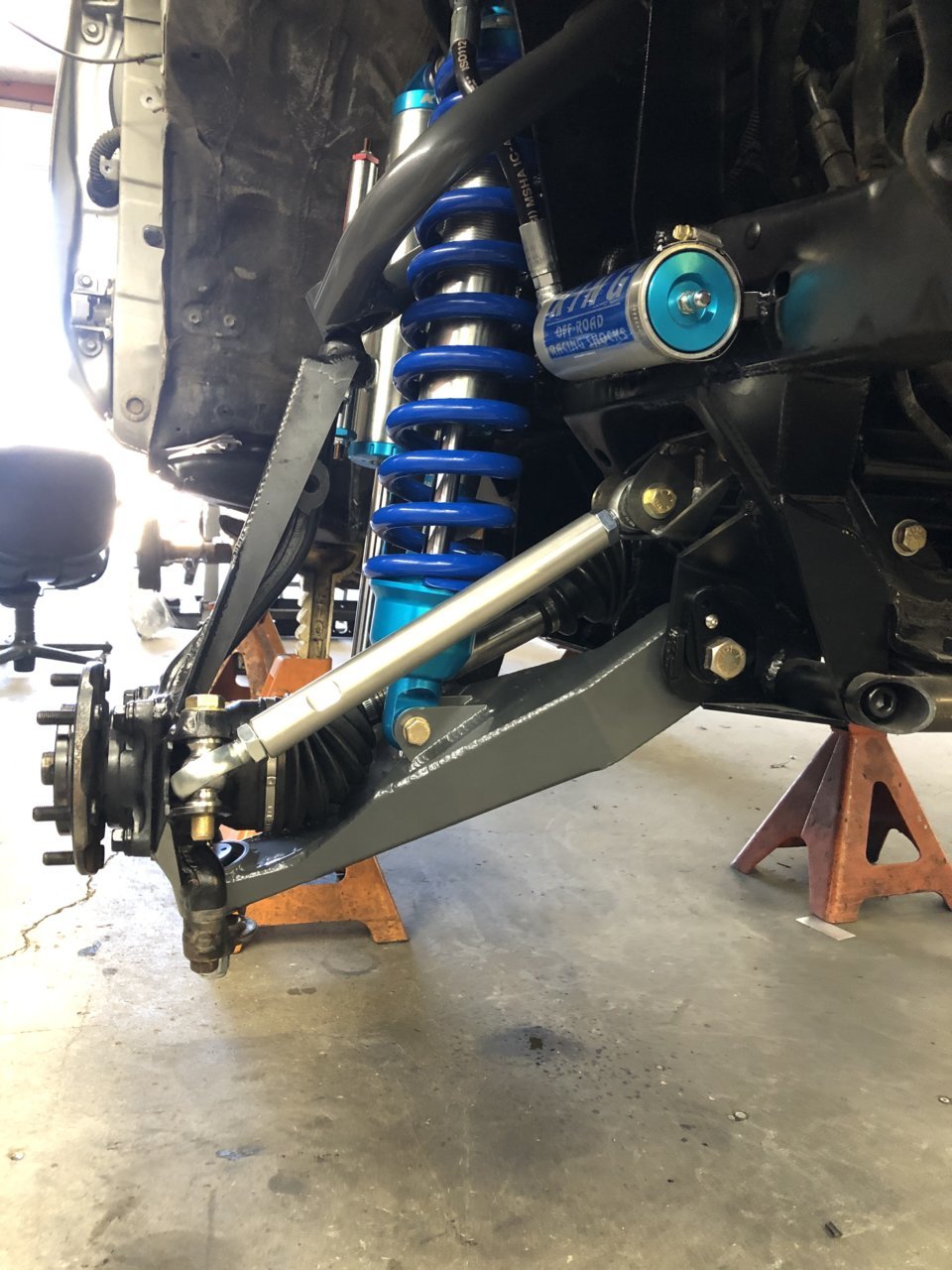

    She’s all done! The final specs are-
    LCA pivot kit
    2.25” high clearance long travel
    Custom slide rack
    934 CV kit
    Double shear and gusseted spindles
    Custom double shear upper arm mounts
    Custom tie rods
    King 8” x 2.5” coilover
    King 8” x 3.0 2 tube bypass
    King 2” hydro bumps
    13” travel
