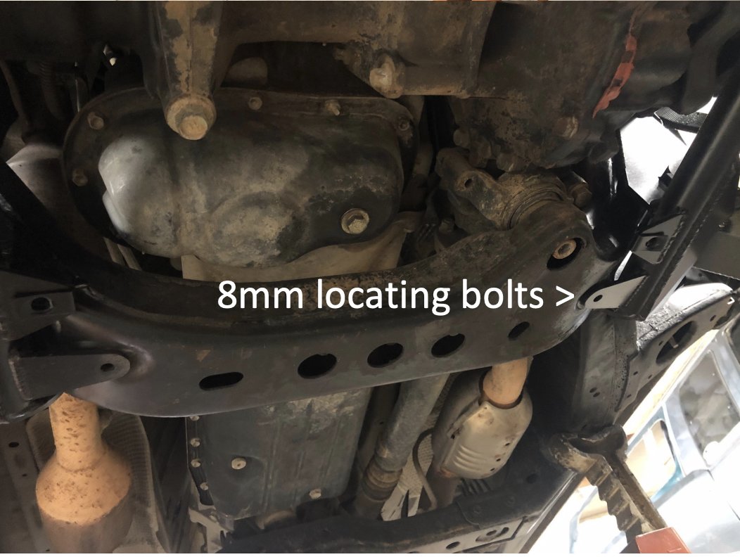

    Does anyone run a transmission skid with JD's inner pivot kit? It looks like the RCI will fit but it uses the same holes as the pivot kit does for it's rear locating tabs and the 8mm bolt to the frame, e.g., attached. I guess I should stop being lazy and drop the pivot skid to see if the RCI trans skid can even contour around the pivot kit correctly.

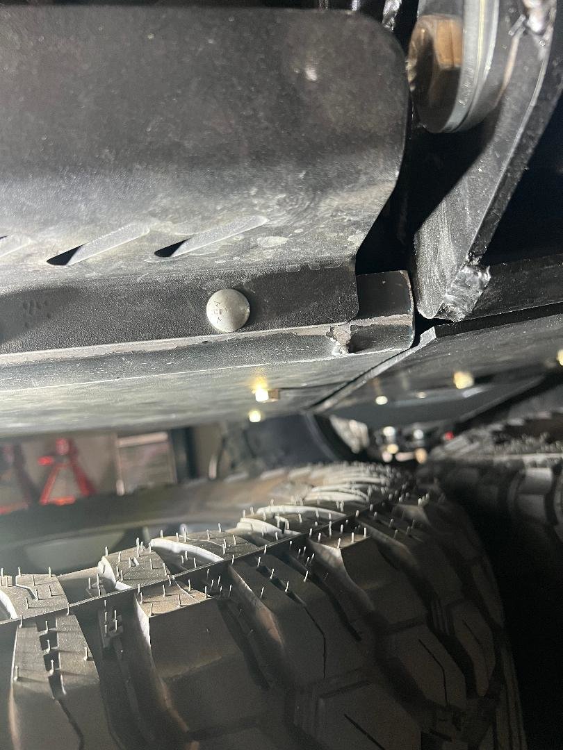

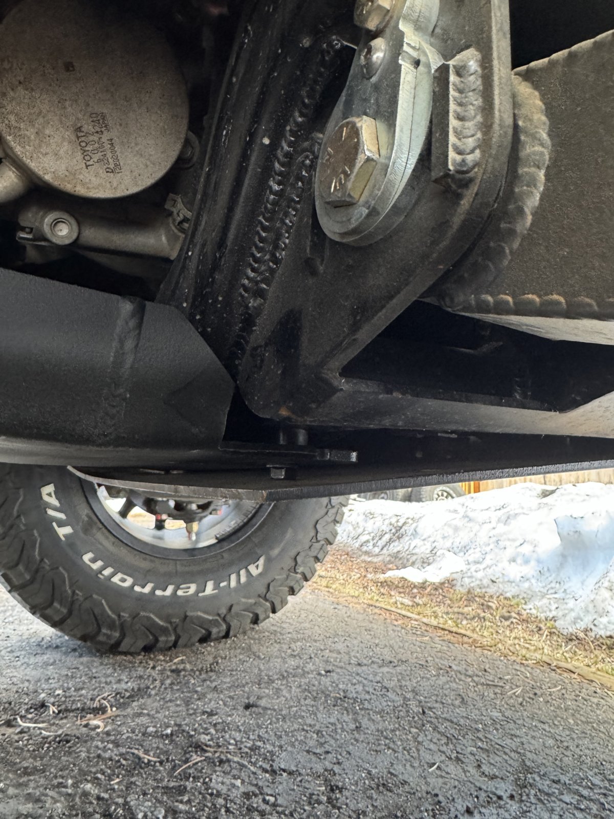

    I had Jesse cut the RCI trans skid to mount flush to the pivot kit skid. He then weld 2 mounts to bolt up to the cross bar.

    I asked Jesse to just cut it flush with the pivot skid. I think it should work fine. It has about an 1/8” gap from the pivot skid.

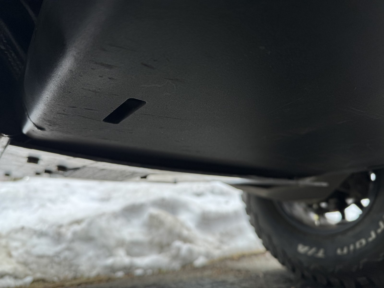

    I got it installed but it’s pretty ghetto right now. I think the best thing to do would be to drill a new hole through the pivot skid and sandwich the transmission skid between the pivot skid and the frame, reusing the original 8mm locator holes that the RCI skid normally uses. The downside with this is that my driver side hole is now hollow: the nut that sits inside the crossmember came loss and is gone at some point. So I just pinned it awkwardly between and I’ll cut the transmission skid shirt when I’m back with my angle grinder.
    Second picture shows how clean it would be if you drilled a hole through and used the original m8 spot.
