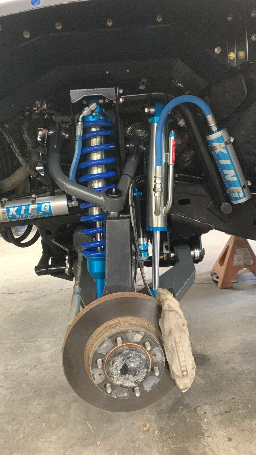

    Did you guys see the new shock tower on a recent JD post on IG? Those guys are always on top of constant improving. I think it allows a longer lower rod end on the coilover and then more steering clearance. Jesse Just sent me templates to reverse engineer for production. ****maybe im not supposed to be talking about this:anonymous:

    Tell them to stop. If I think they may come out with something new I may never change from their stock length setup to the 2.25. But making more room for steering is not a bad thing. Perhaps to accommodate the 74Weld rack, a steering box with a swing set or a steering box with a Howe rack.

    would just be an add on. Ill update my +4 with this tower and longer shock rod end when it comes back from laser. Not really any wasted money. just updates and no trash except the leftover metal cutoff the frame bucket

    I wonder if that changes existing JD coil bucket gusset/bolt double shear

    no, the portion of the coil bucket that houses the UCA bolt is the same structure. Just cut the bucket top off and weld new cap on. You can see the UCA bolt double shear plates in the picture you shared.

    Would the extend height tower require the JD inner fender?
