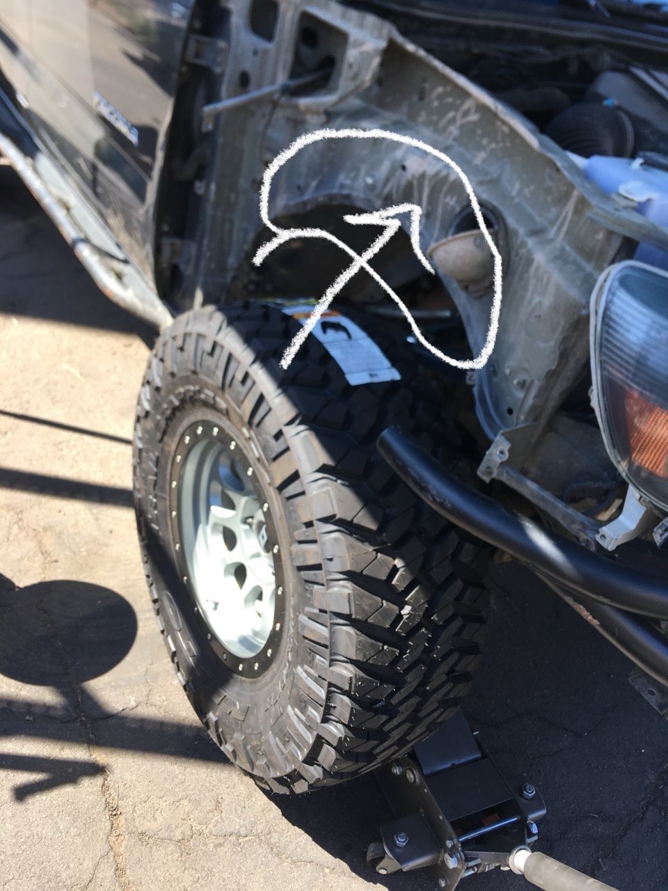

    I don't really follow this thread closely so I didn't see this until now, but the truck in that IG pic is mine! The modified coil bucket top was to raise the coilover up 2 inches to clear the tie rod. Since I was putting 37's on my truck, they moved the LCA's full forward in the pivot kit, and with the JD Fab tie rod ends, the coilover was slightly rubbing on the tie rod.
    -Brian

    The truck in question is mine, the stock inner fenders were already cut out when they did that new coil bucket top, but it sits pretty damn close to the JD Fab inner fenders, so I don't see any way it would work with the stock inner fenders.

    Yea my JD tie rods definitely rub the coil

    35 sometimes hits factory tub at compression uptravel

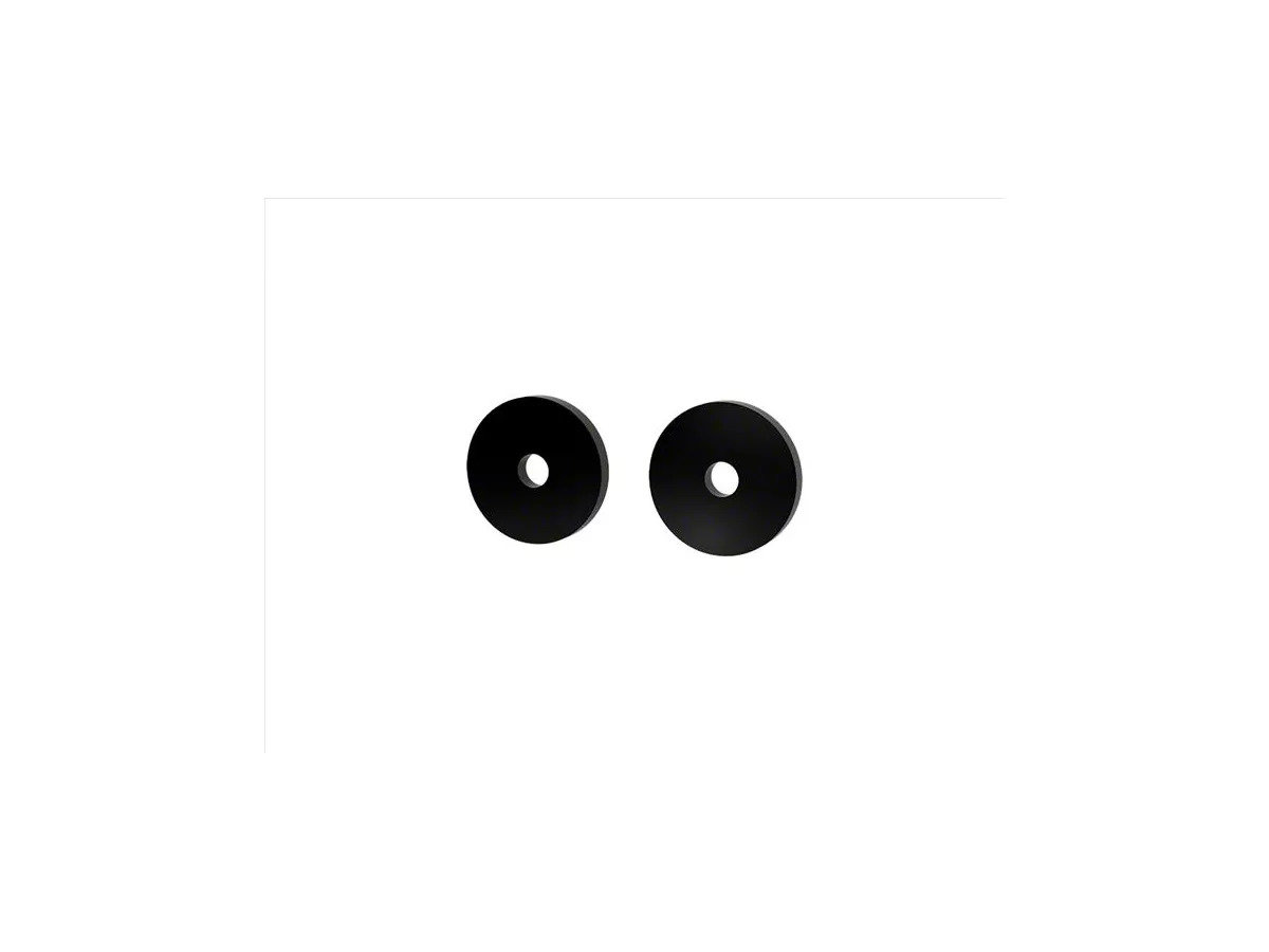

    anyone fix this? Am thinking of trying Icon 1/4” bump stop spacers that claim to resolve this
    they also have a bigger one. Hopefully 1/4 works. They’re cheap.
    Looks like it would still leave enough room for bump stop to thread in.

    All you'd need is longer bolts for more spacers. But, its part of trying to fit 35s. They start to hit places, also quite a few of us are running JD inners or guys are just caged.

    If you need to sacrifice travel for tires I’d just go to a tire that doesn’t force sacrifice. Otherwise, tub it.

    I mean you have a point.
    Going to ask what my bump stop supplier recommends and maybe try 1/4 either way and see what happens.
    I expect it to be less of a problem when I get done making sure the lift height is set right, as well as correct springs and springrate. Now that 1.25” spacers on to move the tire out a bit.
    But mainly crawl. Where downtravel seems more important than uptravel.
    It’s only at the very end of uptravel it does it. I can see that being more of a problem if it was doing jumps and desert pre running.
    I don’t know if it becomes more of a concern with LT, and if LT allows for more up travel.
    bump stop spacers would just be a quick cheap easy temporary bandaid fix attempt.
