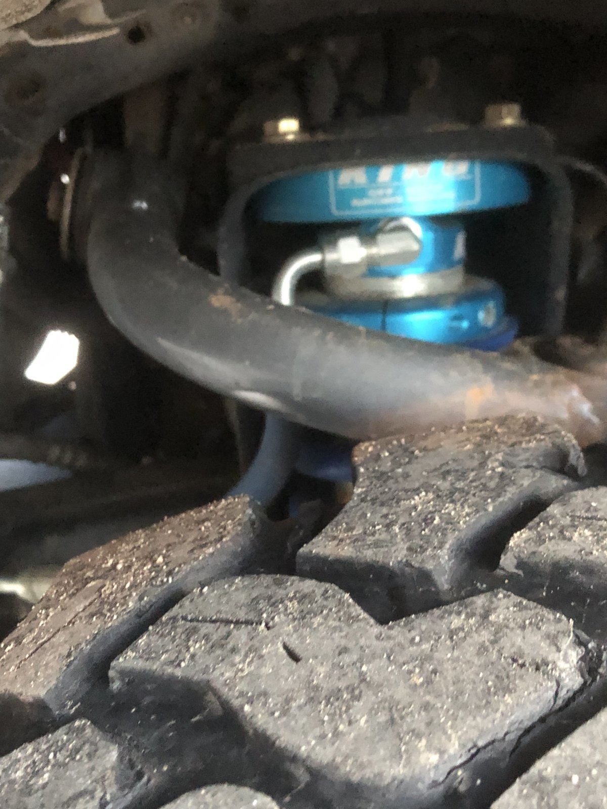

    anyone know a rattle can that matches the grey paint on the UCAs? my tires have rubbed off quite a bit of the finish

    how is your tire rubbing the uca ?

    tires are too big (35x12.5) and I need to get some spacers to make it stop rubbing the UCA

    but it could also be alignment problems, a very big motorcycle crashed into my truck and hit a tire. been trying to sort out that mess for a while.
