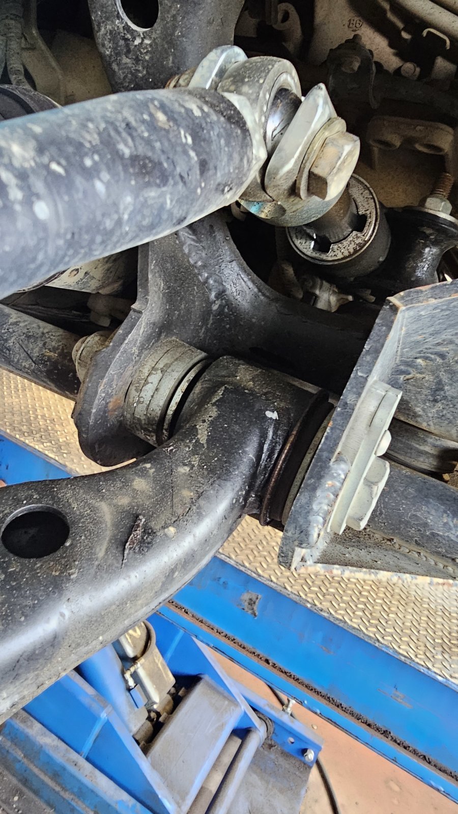

    They do! Although i'm 4hrs away with a ferry, unfortunately aren't able to pay them a visit as often as i'd like. But have only dealt with them from the start & wrenching on my own. Learnt many things on the way and i've been enjoying it. If i'd be closer i would def have brought it over for alignement ...
    Thankfully i've got 24/7 access to a shop, some tools & a lift, just sucks running into issues when you know you didn't mess it up

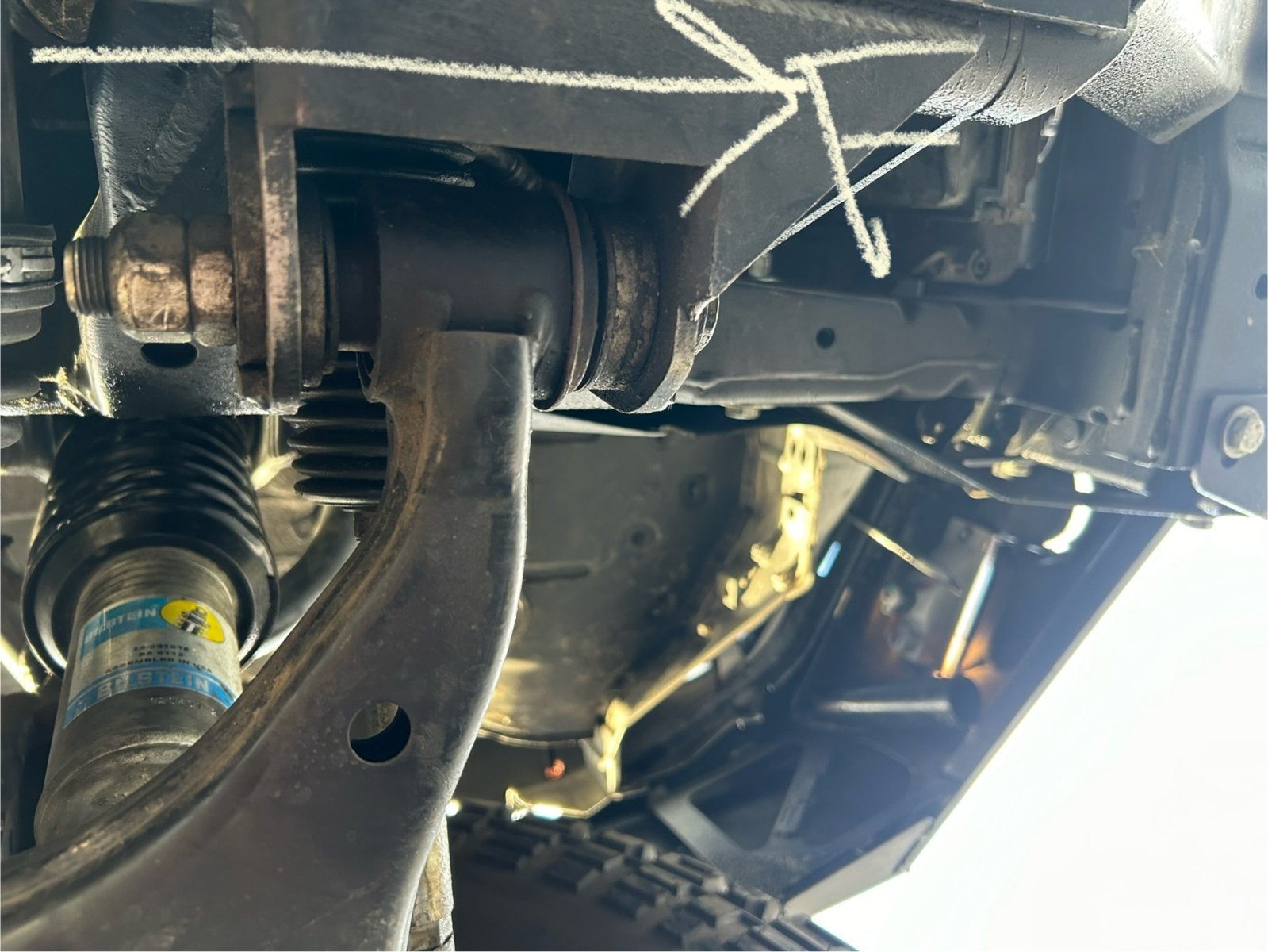

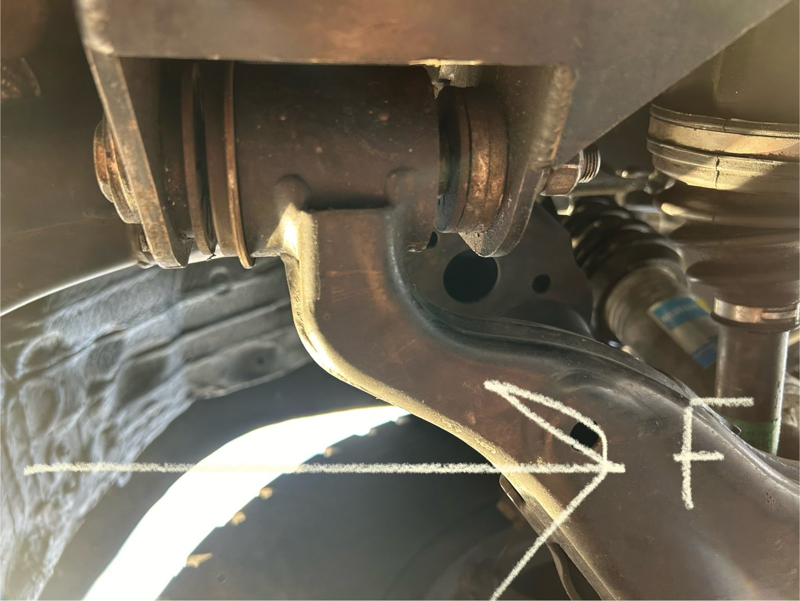

    anyone know how the pucks are supposed to be
    found two articles saying they should be in the rear
    Looks like mine are in front pushing the LCAs back to rub pinch weld
    want to make sure I get it right before doing another alignment since I just changed my springs
    you can see mine is 1 puck rear
    2 pucks front
    Which pushes the LCA back
    as opposed to pics I found of this 4runner
    3 pucks rear
    To push the LCA forward

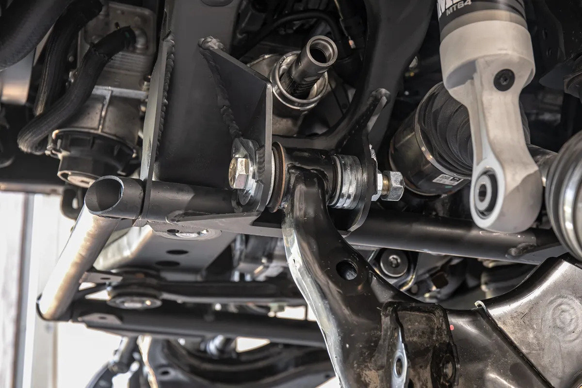

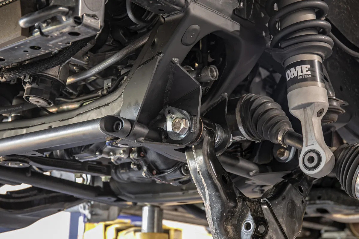

    Spacer pucks should be at the back of the LCA to push your arm forward.
    Cam tab lobe ->, small shim -> LCA -> however many pucks you want to space forward -> rear tab. Cam bolt & nut -> jam nut

    Forgot to reply the msg^ but just flip your pucks around to the back. Photo above is my pass. Side for reference. Front being right side of photo.

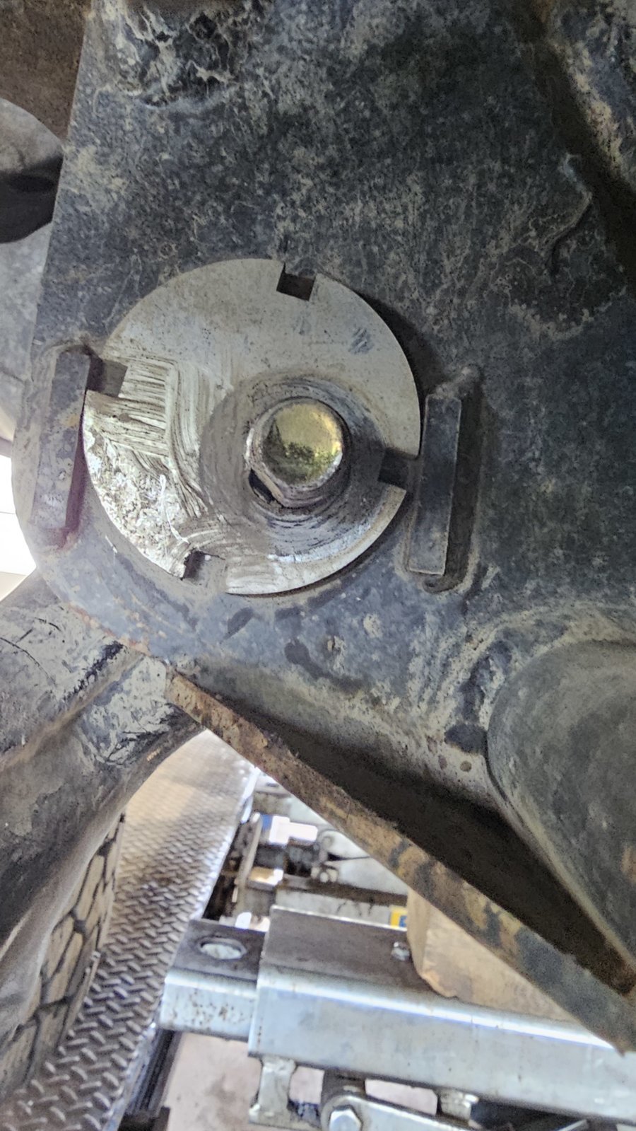

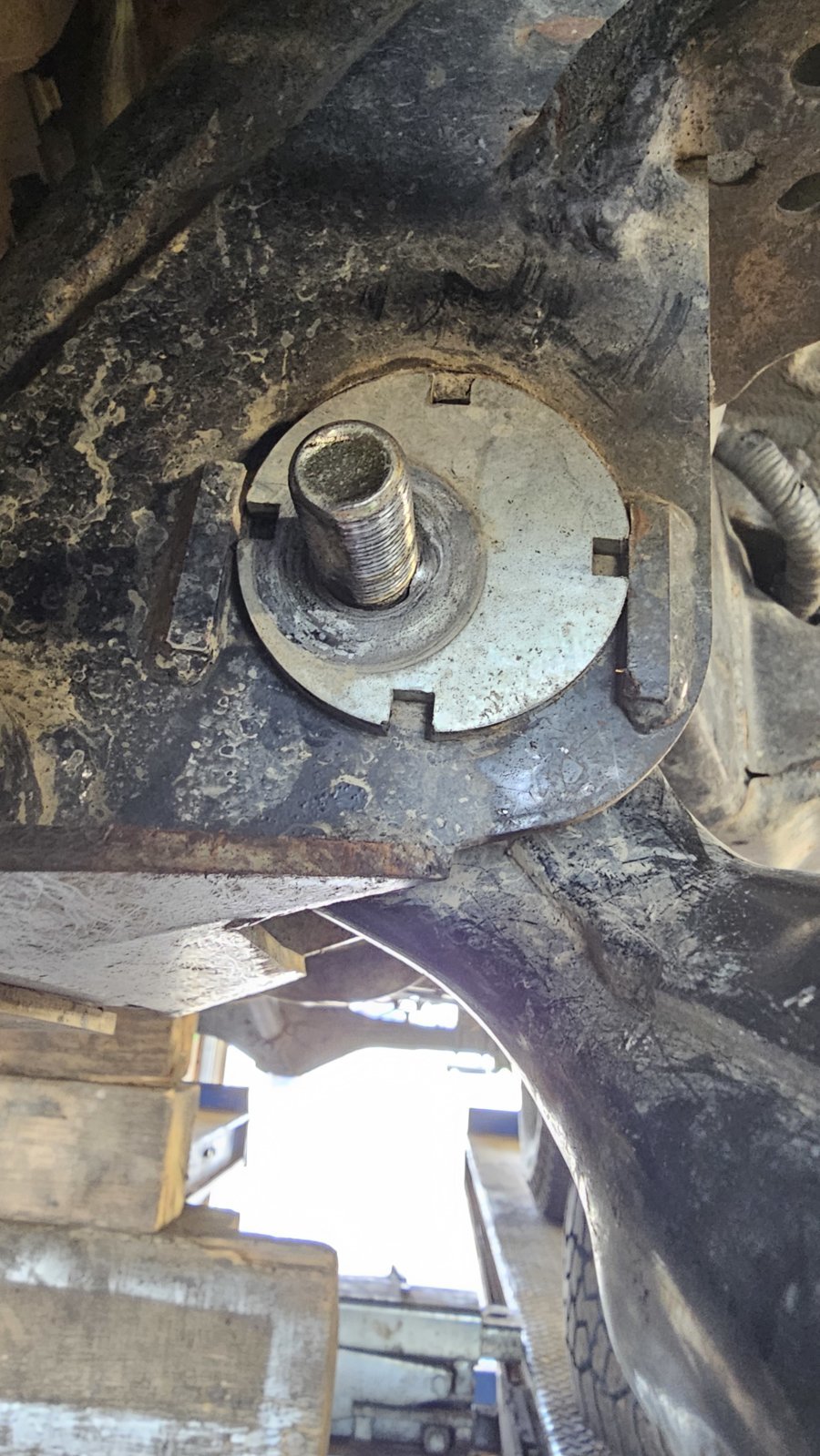

    Has anyone adjusted front ride height after a setup that had the Cam bolts drilled out already? Thinking of lowering my front a bit and pretty sure Ill have to adjust the cam bolts but not enough to get complete new thru bolt locations on the lower pivot tabs

    So here’s my opinion. I don’t use the locking bolts and have yet to have an issue. Those bolts, properly torqued have so much clamp force it’s ridiculous. The 3/4 torque spec is 315ftlbs. 5/8 is 180.

    Likewise, never locked the cams in and never had them spin. Too many other variables that may require alignment to commit in my opinion. Even a gusseted spindle can still bend pretty easy

    I love the confidence i get from having those cams locked in.

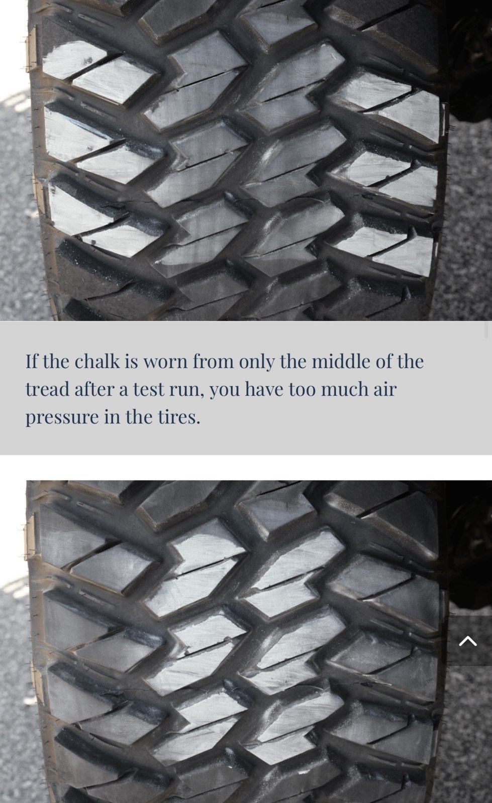

    What PSI are people “fitting” into their 35’s?
    alignment should be good
    I’ll double check
    getting cupping on the front tires.
    Tire shop said they think the door spec (29cold) is too low for these tires and should be run higher.
    am thinking of trying chalk test to see how it looks and if that guides towards determining a good road pressure.
