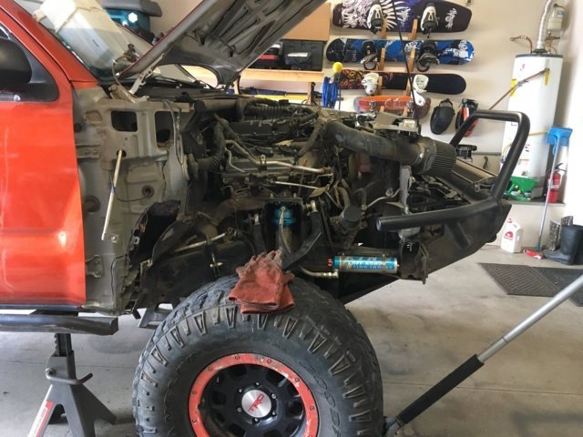

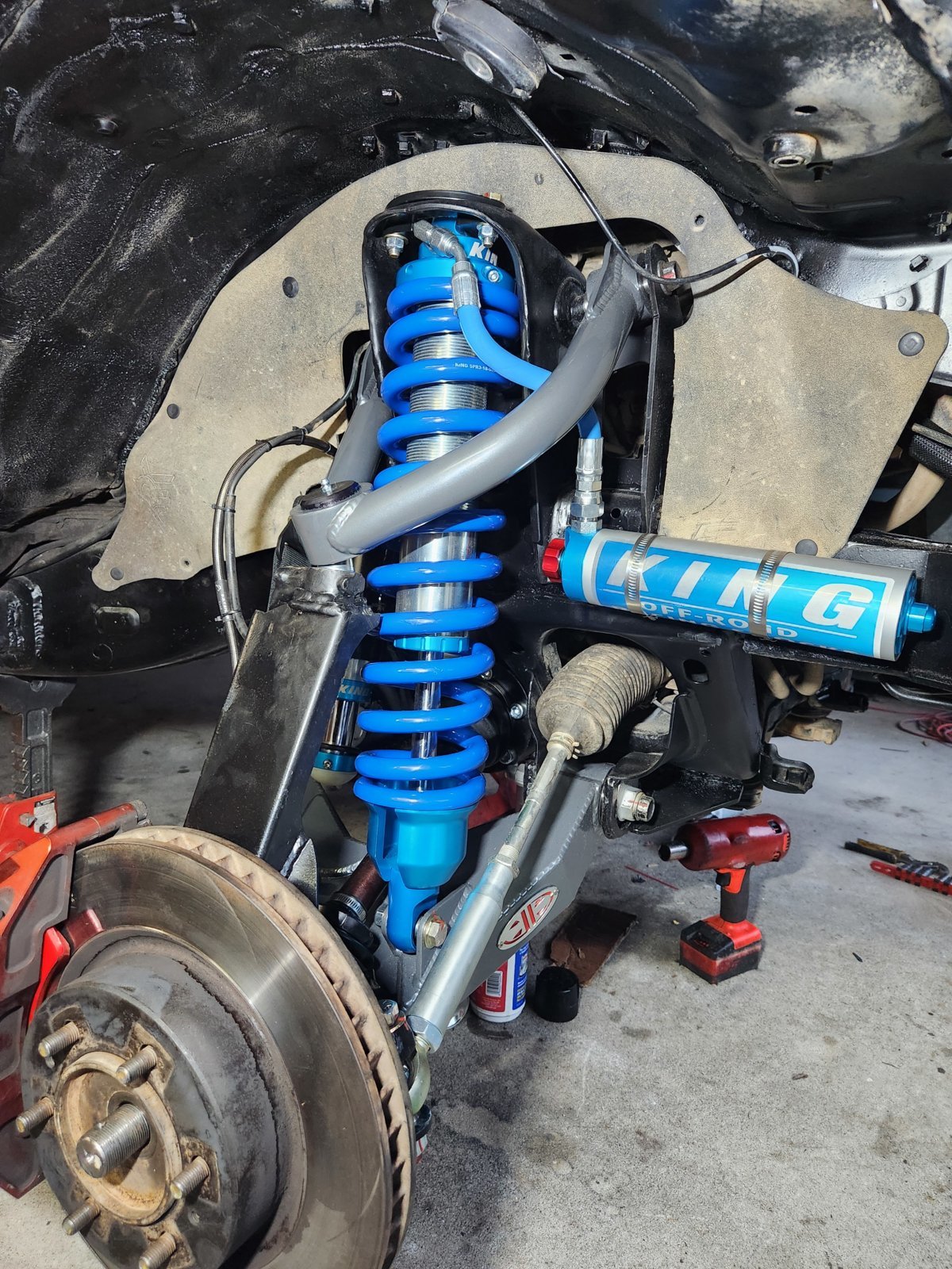

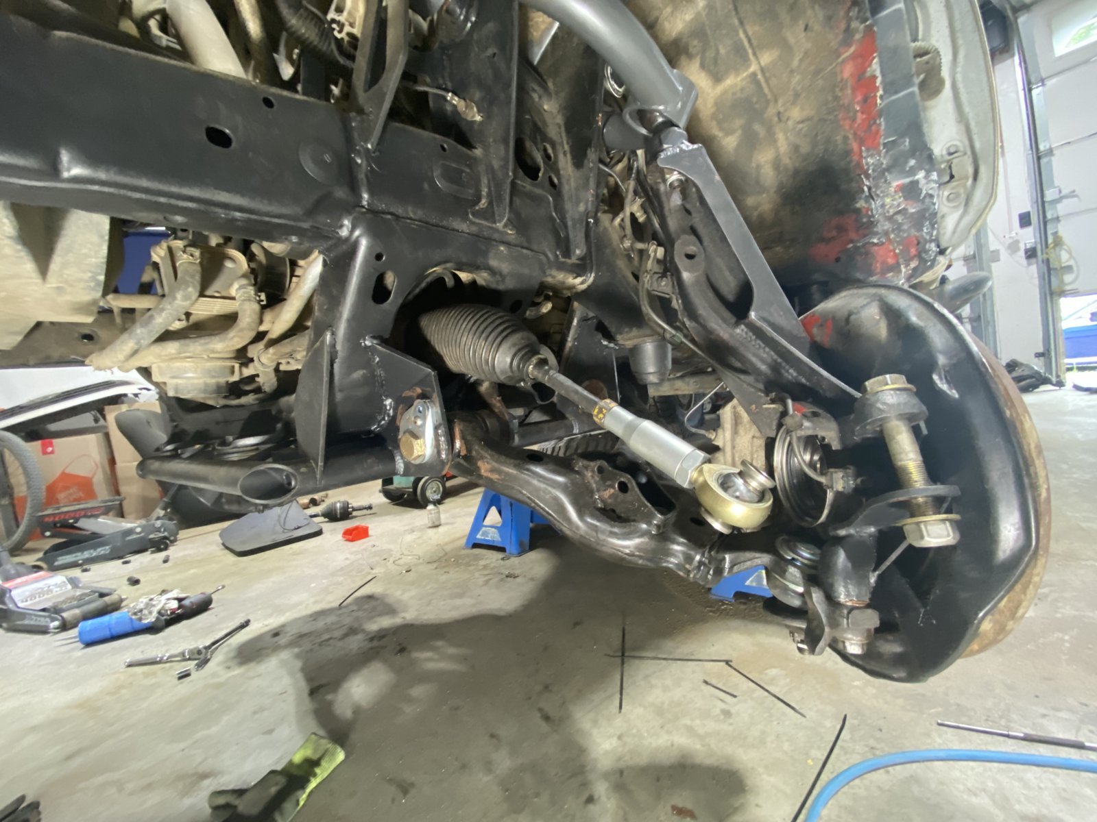

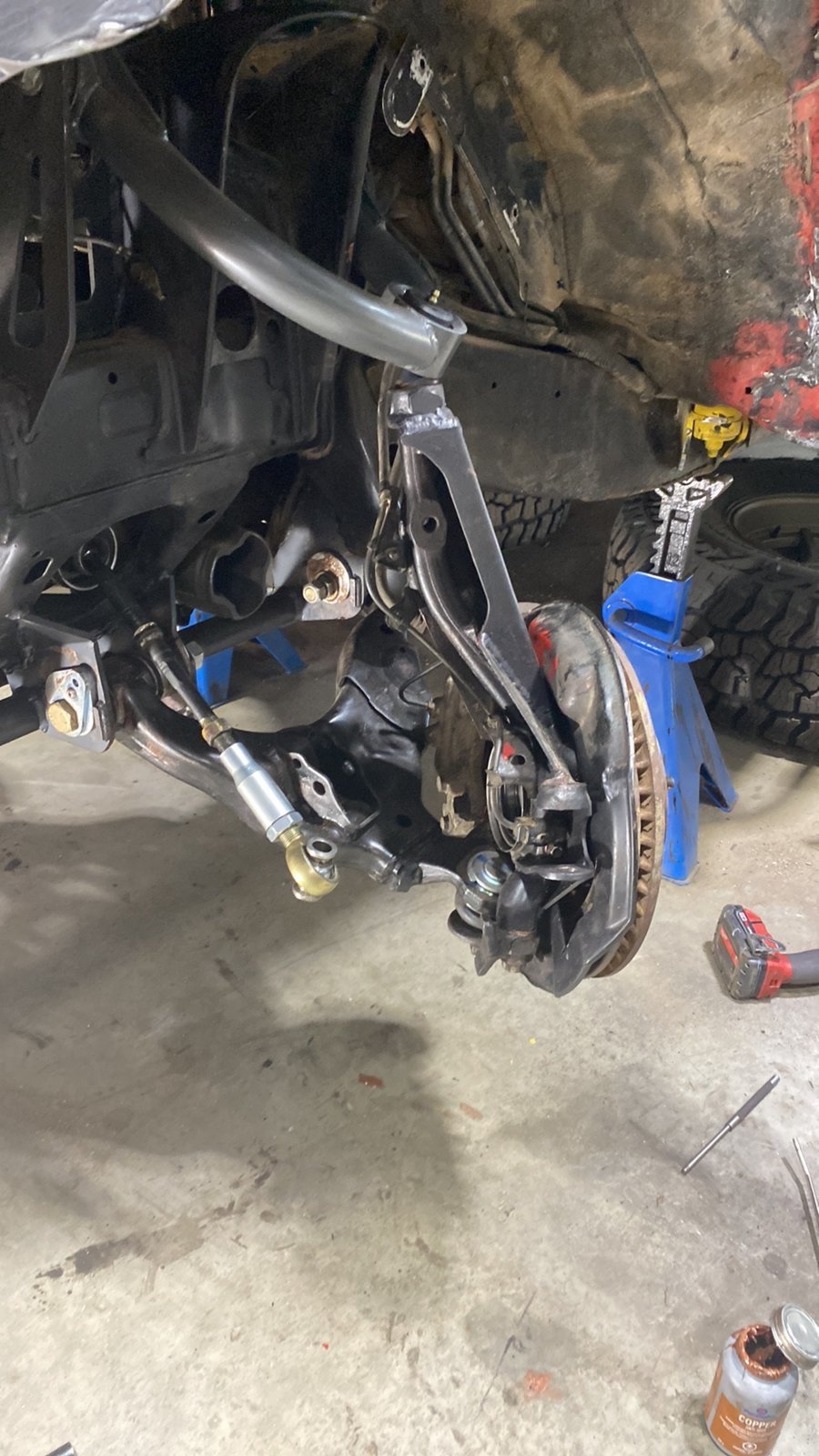

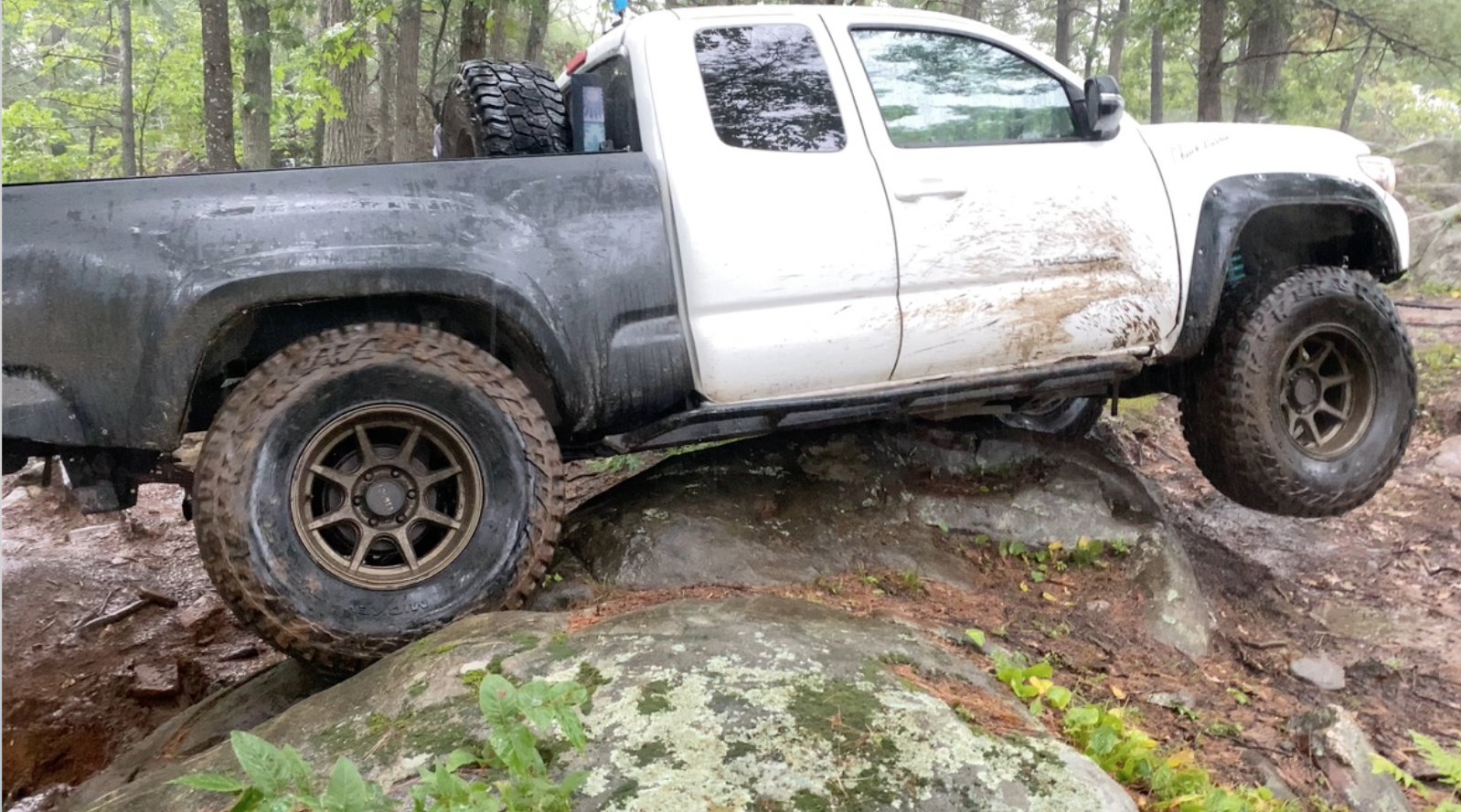

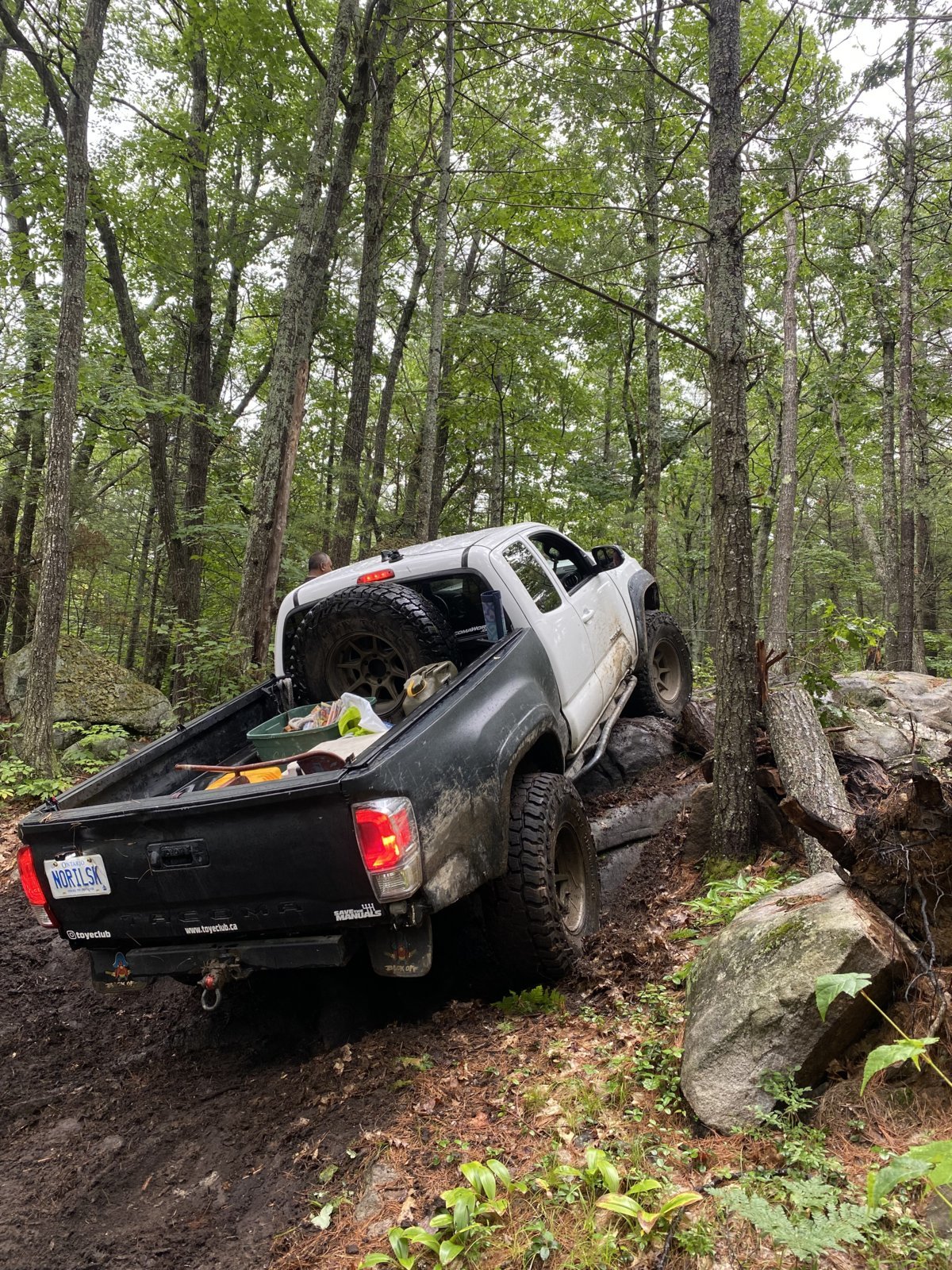

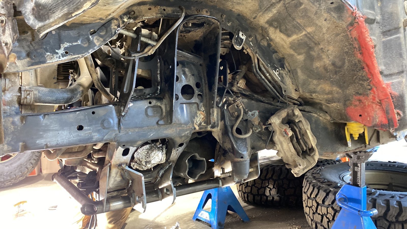

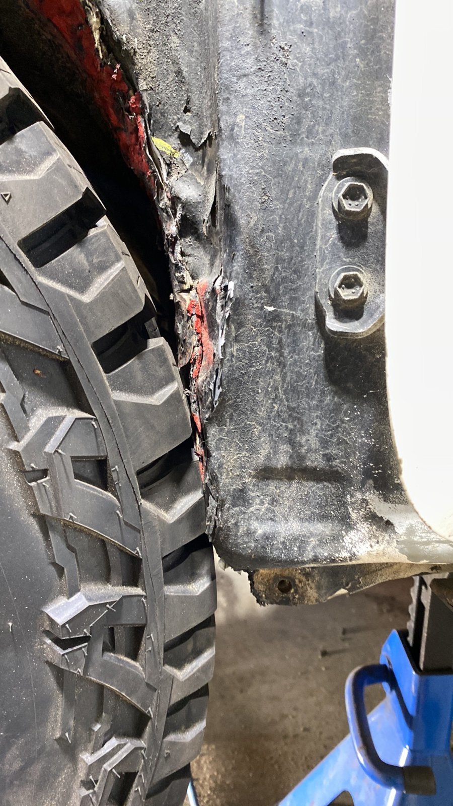

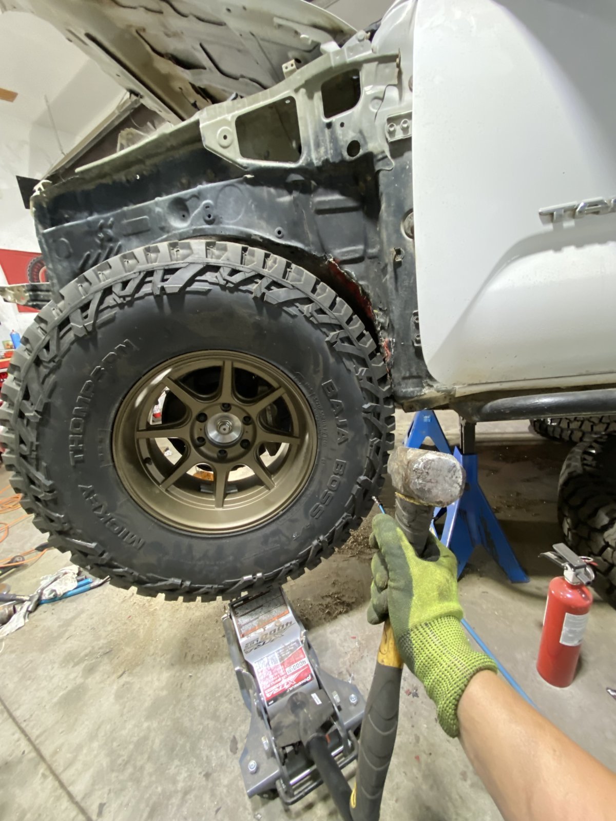

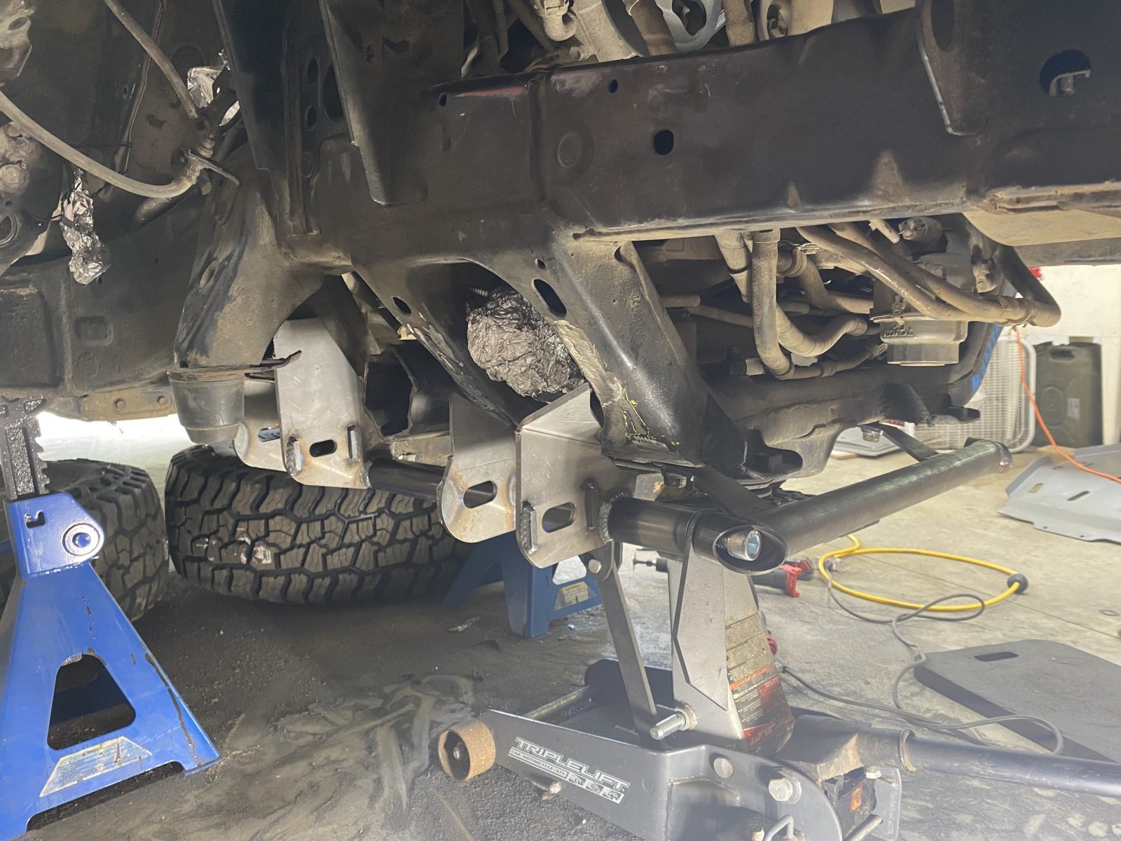

    I am still in the process, most was done between 2020 and 2022. At the front I did JD lower tabs relocation, UCA and spindle gussets, steering heims, cab relocation, lot's of hammering on the fire wall, Basik Biker tundra rack - back when you had to cut off the original steering mouting points and weld new in. Rear is 12" shocks, BAMF hangers, ICON leafs. Front rubs slightly at full flex during max turn, but it's been fine for the past 2 years.
    Next is to cut through the cab, make new inner fenders and figure how far can I tub (i have manual, need room for clutch). But that's a project that needs patience and time.

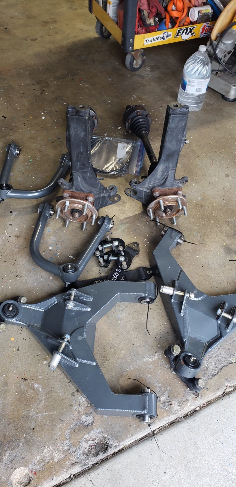

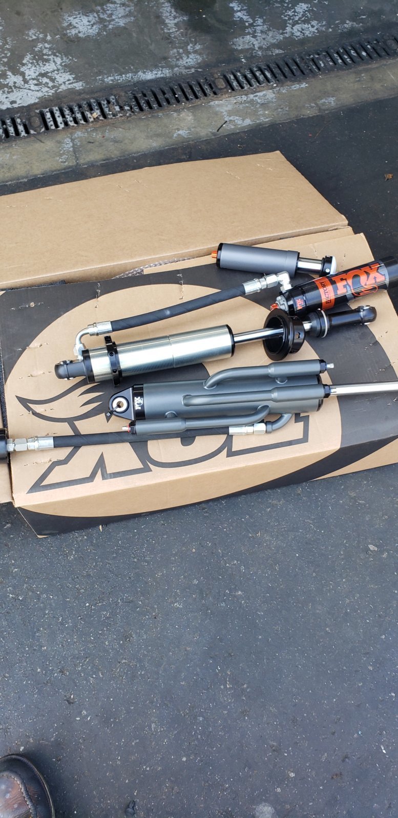

    Last weekend I bought @RonRon23 JDFabs +4 Kit, pretty pleased with the transaction and with him being upfront with some known issues with the Lower Arms. Thanks again @RonRon23!
    The Arms are now at JDFab and being looked at. JDFabs customer service has been outstanding so far. Taking care of a Used Kit is pretty awesome. They really do stand behind their products!!
    And this morning I stopped by JDFab in person to pick up the rest of the goodies needed for my upcoming front end install..
    Pretty excited about those Fox 3.0 - 3 Tube Bypasses!
    JDFab offered a screaming deal on the Coil/Overs that I couldn't pass up. They are the DCS flavor so they'll have to be re-valved to work with the Bypasses..
