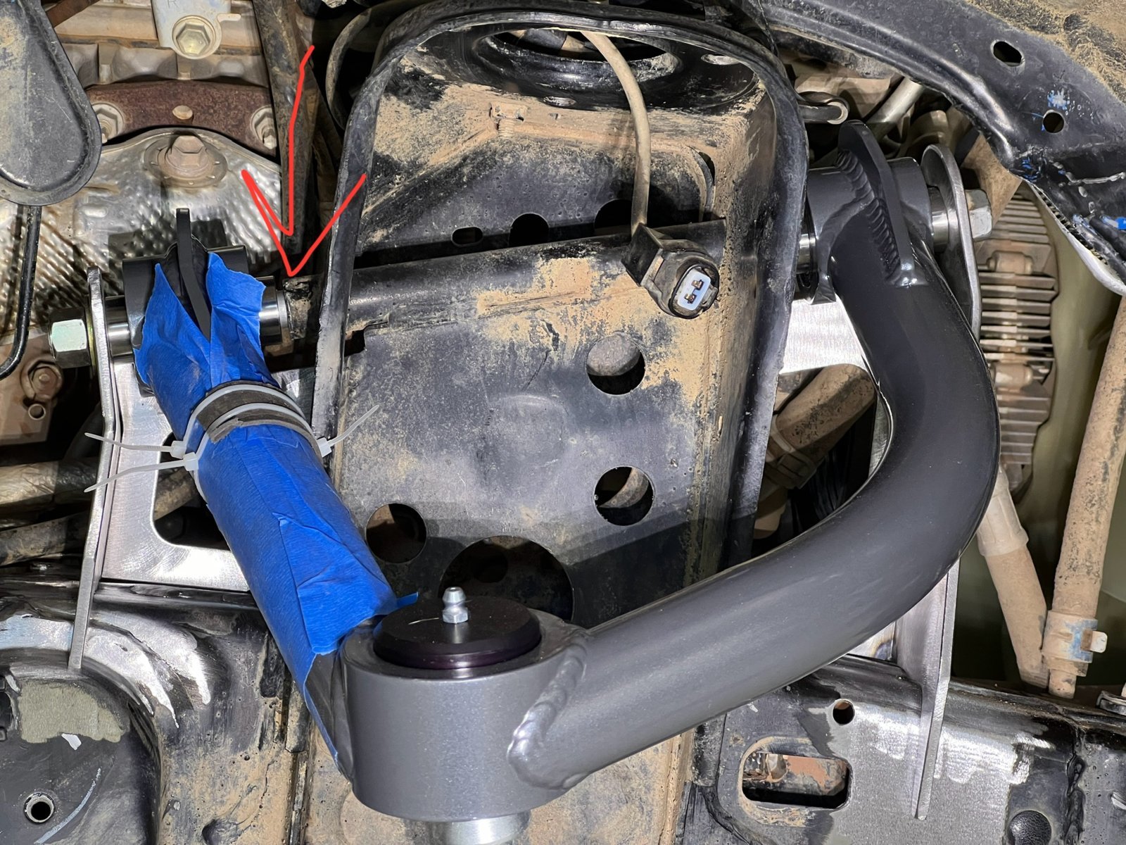

    Hey guys who have done the UCA double shear gussets, do you just clamp down on the pivot bolt before welding and deal with forcing the UCA into a narrower slot later?
    Photos are with a mockup-regular-non-locking nut finger tight, you can see the UCA is a little more “spread” between the legs which would be perfectly fine to install later if the double shear gussets weren’t going to get in the way.
    2.25 kit on a 2020 if it matters.
    I have a lathe so I’m going to turn some .020” axially over sized spacers instead of welding with the arm in there, but this mockup is scaring me a little that I’ll have to do something weird like ratchet strap the arm “legs” together for assembly after welding.
    Gaps as shown currently are .190” on the left side, .090” on the right side

    Honestly I would make a spacer to take up that gap and then weld them in, that’s a lot of stress induced to the arm to pull that kind of gap closed. Wonder why there’s so much gap on yours…might be worth a call to jd to ask about it. Last dual shear kit I had was a Dk set and they included some small washers to add to the outside of the uca when welding them in to make sure I had a small gap after to help with assembly.

    I planned on holding off on burning them in until I called them on monday. the UCA misalignment spacer / seal ID surface spacer baggie had some washers in it too, but the tie-in to the tower gussets would end up with a big gap to the tower if I were to add spacers.
