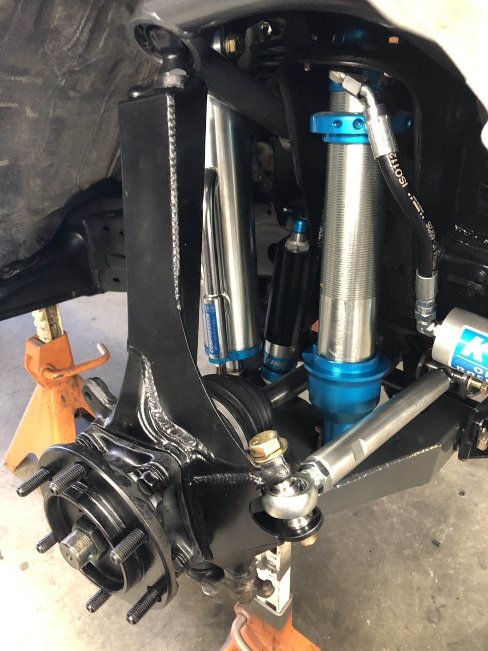

    Everything tucks in real nice at full bump

    I don't know man.....looks like you can get another 1/2 inch out of that bypass ;);)

    I’ve got shorter delrin bump stop ends coming from king that will squeeze another 3/8” :)

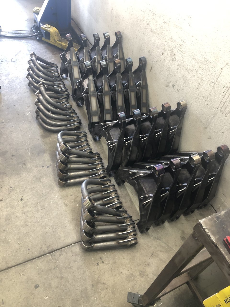

    There are 3 kits left right now :)

    Still have 3 kits left...

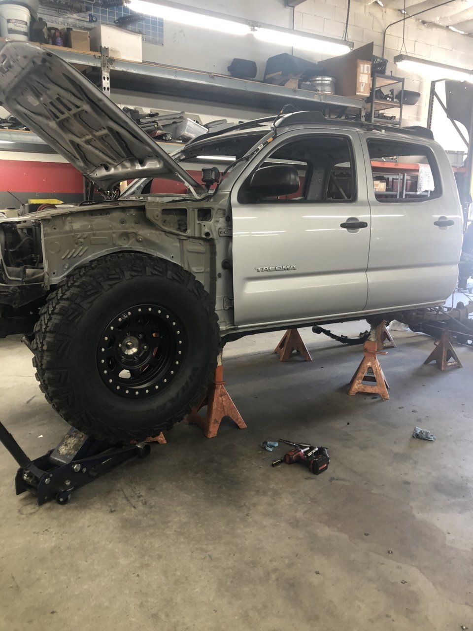

    37’s anyone?

    *whistles* those tires go ALL the way to the top...
    What wheels are those? method 701s converted to BL?

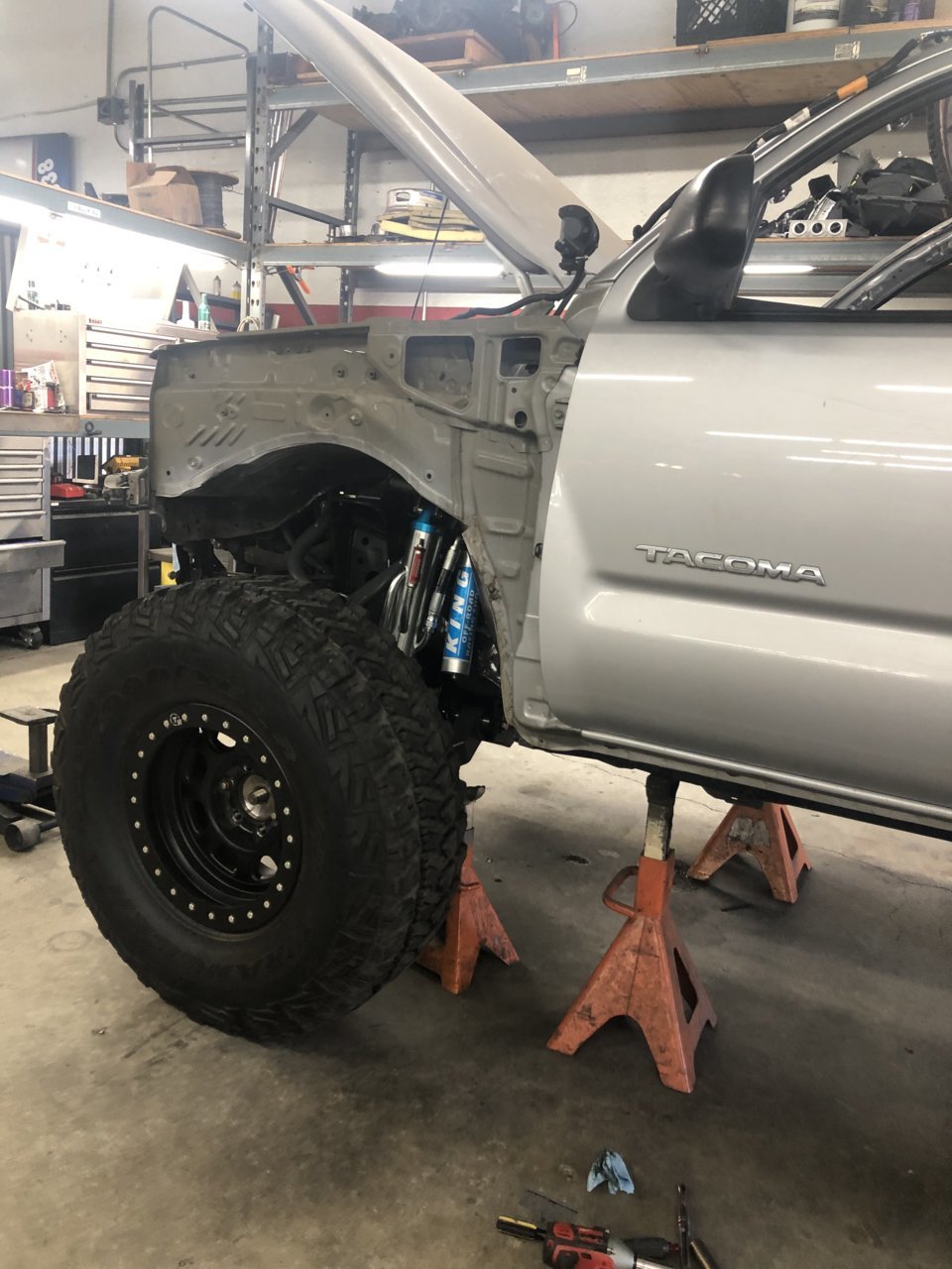

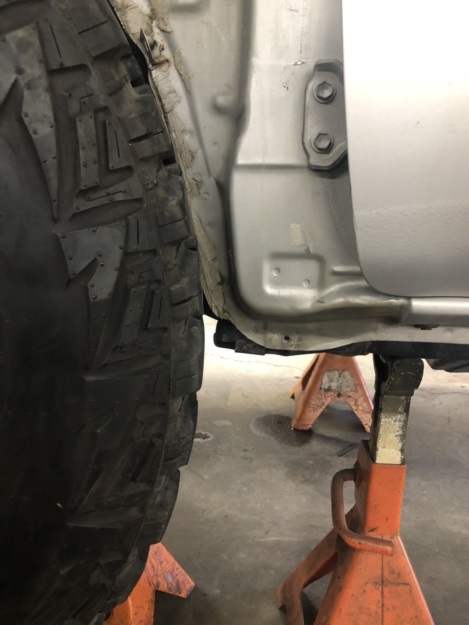

    We have to cut the entire inner fender out to get all the uptravel. We will be making a bolt on inner fender that will allow for all the travel. I have a feeling the taco crowd is going to love the new inner fender design :)

    Those are the wheels and tires off my 81’. They are forged Trail Ready real bead locks...big $$$ specials

    Are you going to fix the rad support at the same time?

    The rad support fails because the tires smashing into the core support tears everything apart. The new inner fenders we are doing will be out of laser cut/bent .90 wall plate that bolts to the cab and then grabs the rad support in multiple locations. We have done this a few times with Ford broncos which have the same issue as the Taco and they work great

    Best wheels money can buy, we have run them on our class 8 and now on the 6100 with zero issues through countless races

    I’ve seen the rad support fail (cracks form) because of washboard roads and vibrations and whatnot, not the tire physically hitting it.
