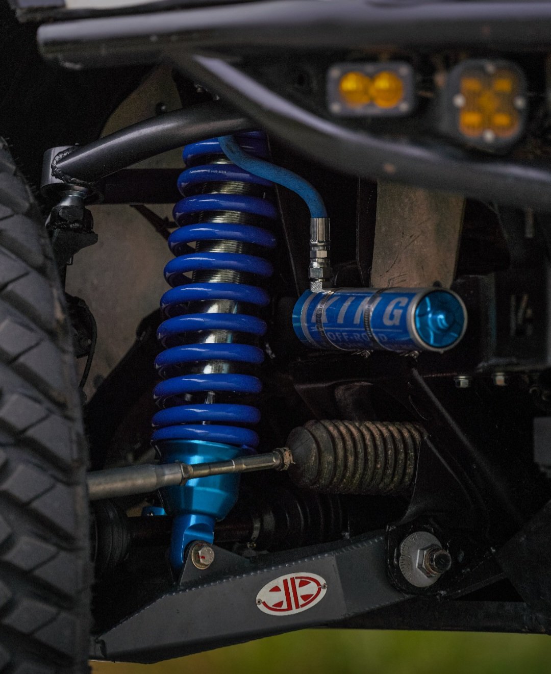

    Yeah:

    Yea JD pushes them up through the top of the tower

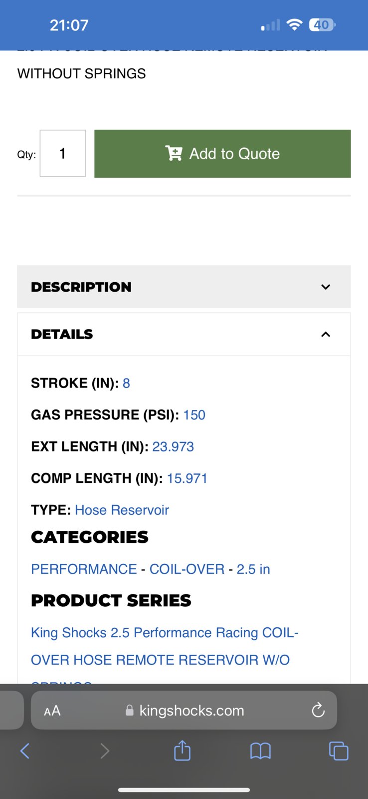

    Now I'm even more confused.

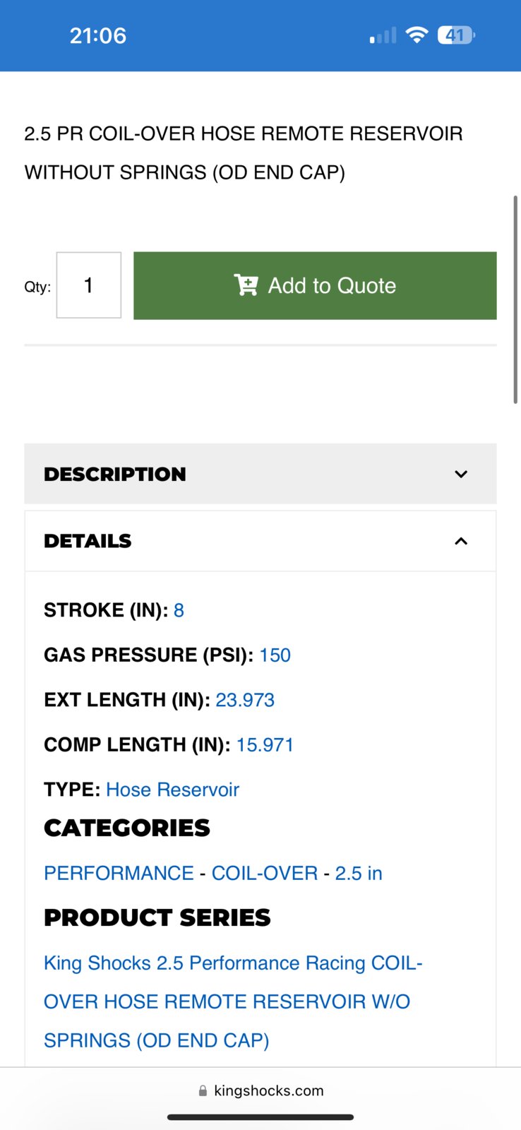

    Called King. They said the PR2508-COHR coilover is going to be a 2.5x8" coilover that's the same as what's used elsewhere. Top hat and rod end may differ, as well as the rod end.

    Not that I know off. The only thing I know they specced was a to add a internal spacer to make sure only 8" of travel. with a total length

    The two shocks have nearly the same dimensions. I suggest you get the longer rod end and shorter spring plate and go from there. Possible you might have to do some sort of custom top hat mount. But the shocks are identical as far as compressed and extended measurements. I don’t know what the difference in shock body lengths are, but it shouldn’t matter. Stroke is the same, kind of.
    They added an internal spacer to limit extended stroke. 7.5” of shock shaft will show. Which I also suggest he has removed as the kit wasn’t built around it being used with the internal limit.

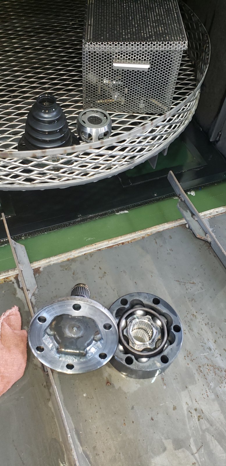

    One of my outer cv boots tore last week, is there anything stopping me from buying an OEM cv boot kit for $38 and a 934 inner boot for $25 and changing out both boots on an axle?
    trying to figure out why JD fab wants $275 w/shipping for their CV boot kit.

    Only thing I could see being different is the grease compounds and clamps. But CV grease is CV grease :notsure:
    Welp, ordered two OEM kits for $85 (ca tax), and gonna order a couple 934 boots and hopefully call it good for the front axles. I just hope the outer joint itself is still good. Could feel it grinding on turns. This is gonna be my first time rebuilding a CV.
