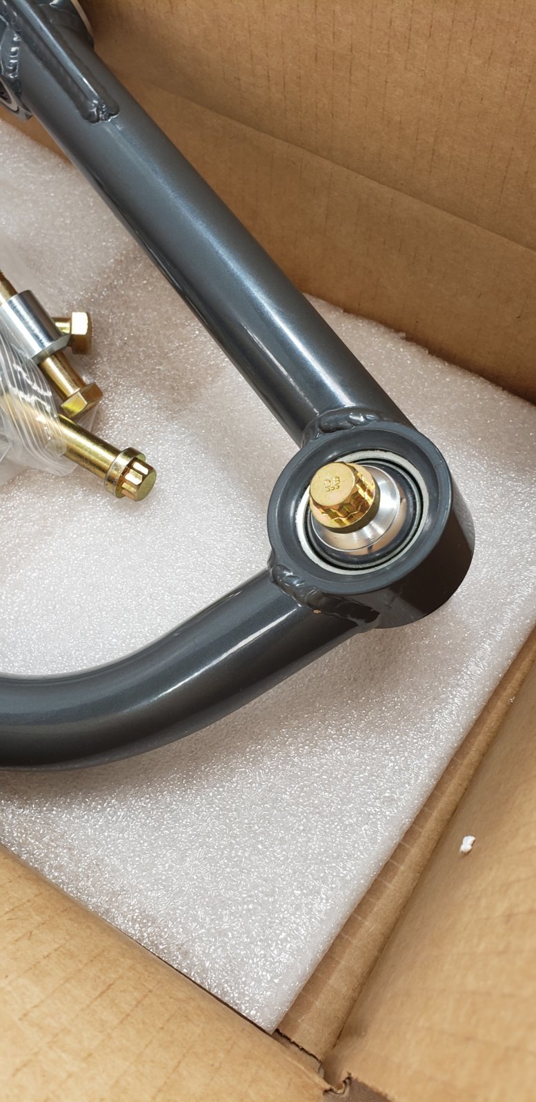

    A Used +4 Kit that I bought from @RonRon23.
    I took the arms down to JD a few weeks ago for them to checkout some loose uniballs on the Lower Arms. They came back in absolute new condition. All new Uniballs all around, and no more EMF stuff. They treated me like I was the original owner even though they knew I had bought them used.. Can't beat the JDFab Customer Service!

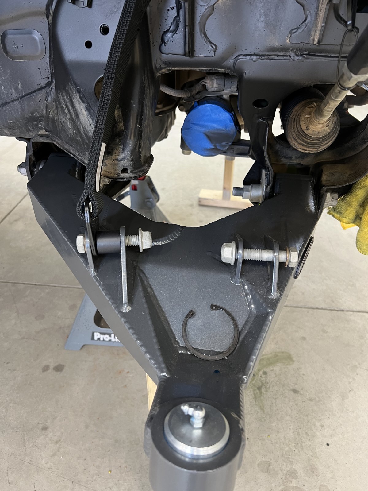

    Welp. Got the driver side emf out to swap with the 1” uniball replacements. Put the fk ball in the freezer, it gets 80% of the way into the cup of the LCA and stops. Put full spring pressure of the truck on to it. It will NOT go in. Anyone else experience this? I was told I wouldn’t need a press to get these things in. Not happy with this front kit right now.

    3lb sledge and tap tap tap it in has been all I needed for this kit, my dk kit, and others. If it’s off concentric and you just add constant force, it might not go. Need the shock load of a brass hammer.

    Yeah guess I’ll try taking the lower arm off add persuasion. At least the uniballs aren’t going to spin in the cup I hope. The EMF joint I removed was still nice and tight after 2 years of daily driving. I just don’t want to risk it sheering on the highway.

    Shouldn’t need to take it off the truck. Find a socket that fits over the uniball, tap the uniball in. Shouldn’t need a sledge to bump it in…
