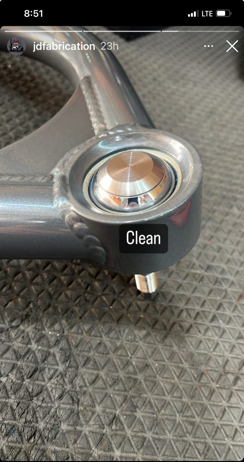

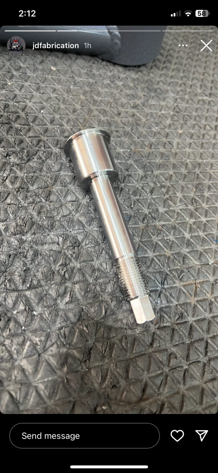

    I dont remember if it was this thread or the LT one where people were discussing springs spec'ed by JD recently.
    my Fox shocks just arrived yesterday and they came with 500x18s as expected
    Also they showed this on insta yesterday, should be their 1pc JD joint pins that eliminates the thin cross section of their prior misalignment cups. Hoping they can get these out soon!

    Jesse gave me some hints about this new pin design when I brought @RonRon23 old arms down to them to get refurbished, and that was more than a month ago. And its the only hardware left thats pending before my install.

    Yup, new pin was installed on my truck, a few issues with other spacers but should be on and in the dirt soon.

    Same, Jesse said the UCA pins and LCA pins were already sent out to the machine shop when I talked to him last month, but he didn't know which size was going to get completed first.
    Hard to tell scale from the instagram post but I do see an UCA in the background so maybe these are UCA ones?
    I'm hoping the LCA ones are done too as I'm also just waiting on LCA pins and new UCA set (that should come assembled with the new pins)
