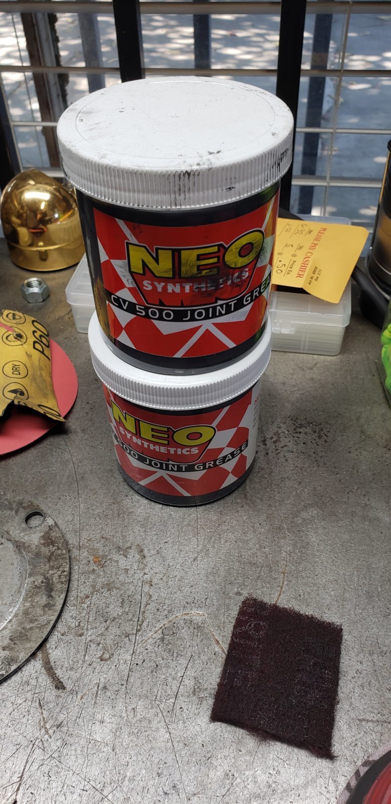

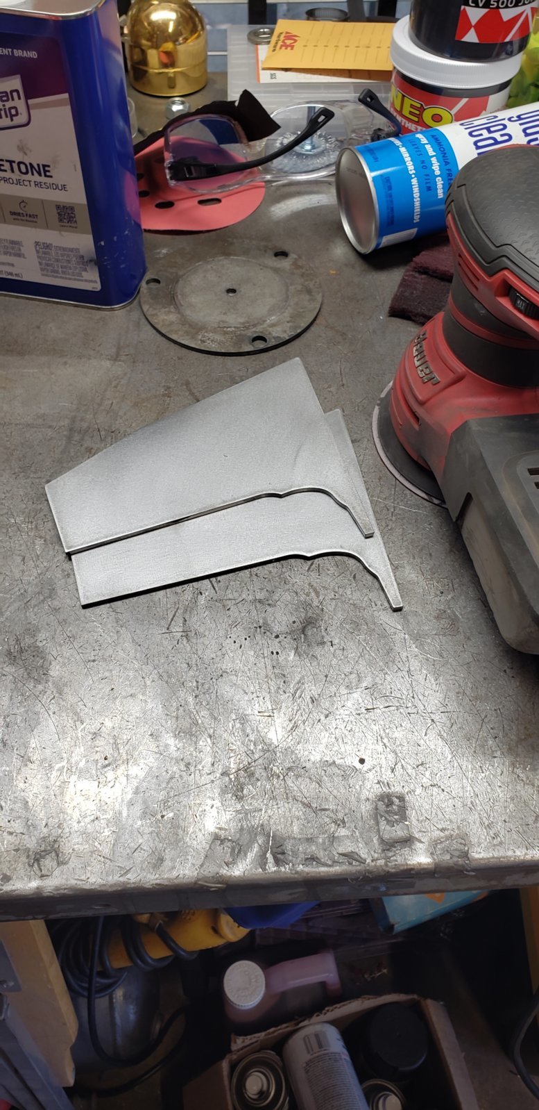

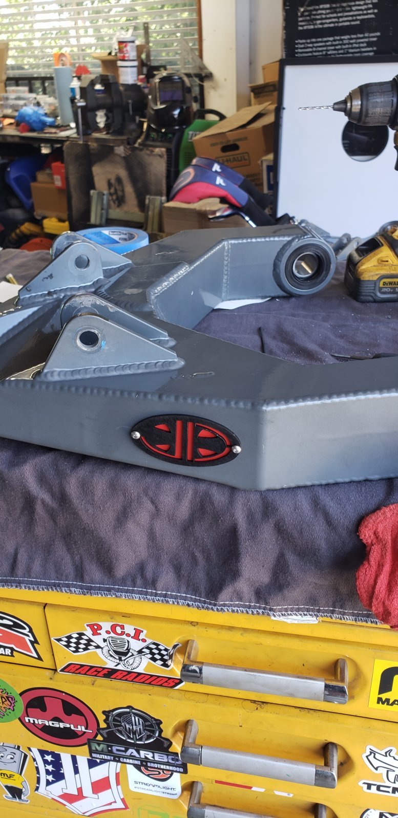

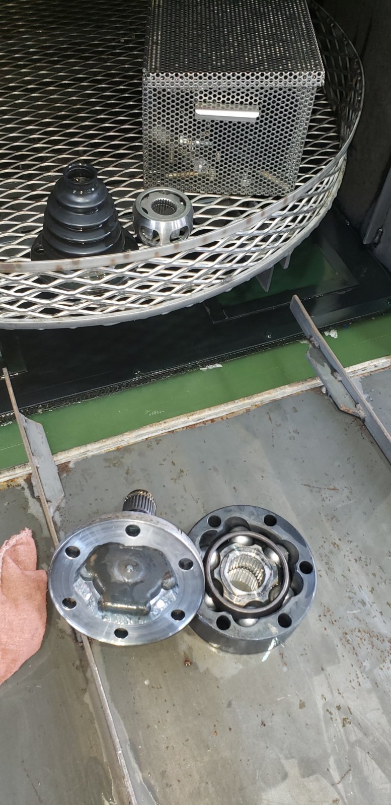

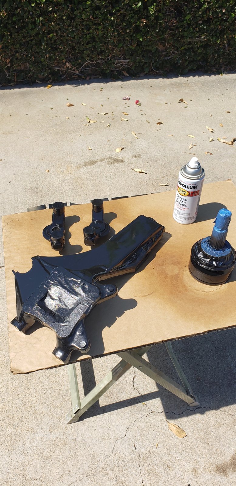

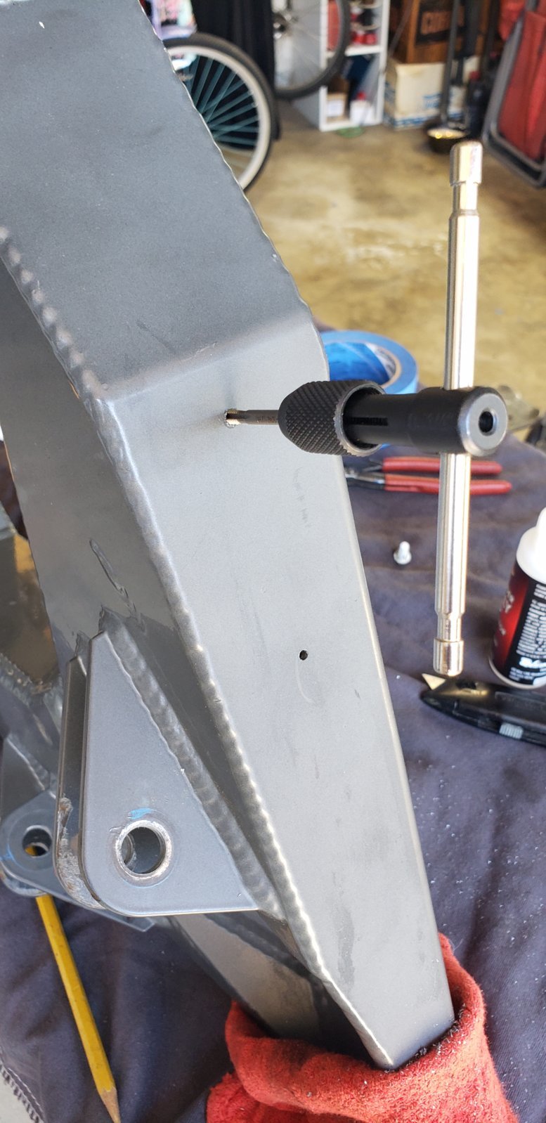

    Last minute prep details before installing @RonRon23 old kit that's going to happen this upcoming weekend..
    Drill and Tapped for the Logo
    DA'd pretty much everything I could
    Painted and cleared coated all the old stuff
    Rebuilt the CV's using the good stuff..

    You replaced the inner cage and Star on yours? I reused mine, is there a life cycle on those if there’s no obvious scoring?
  13. Jul 7, 2024 at 4:56 PM
    MonkeyProof
    MonkeyProof Power Top
    Oct 7, 2008
    #9774
    12,824
    SoCal- SGV
    Everything looked good so nothing was replaced. All I did was some 600,800 and 1,000 grit polish on the wear surfaces. Nothing fancy, just enough to break down the squared edges and reduce the high spots. Im pretty confident that we won't be replacing anything due to abnormal wear and tear with the 934's. We can always upgrade to the polished 300M stuff that we use on our Class1 and Class10 Race Prep if we happen to break the cage, but I very much doubt that will ever happen.

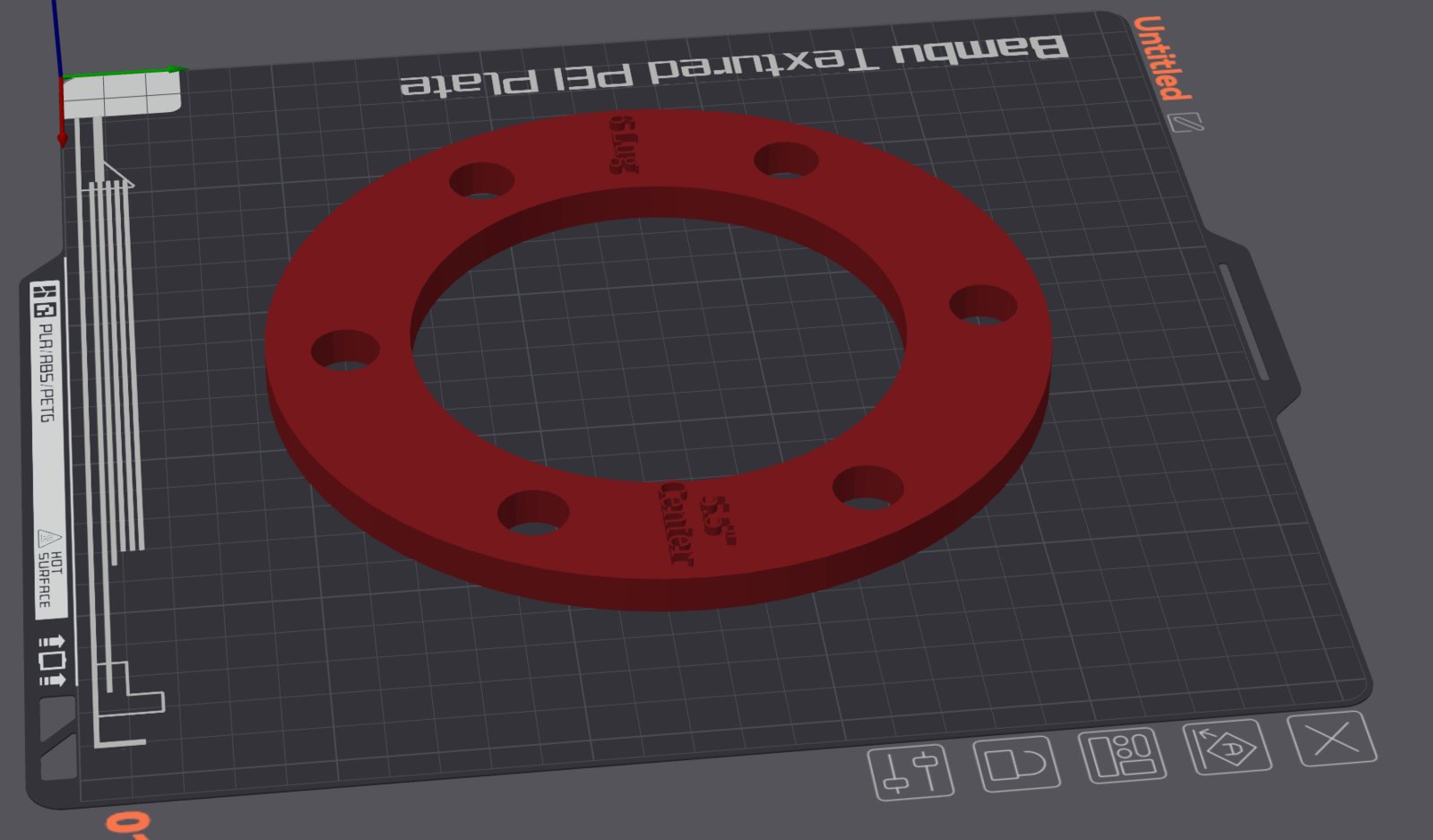

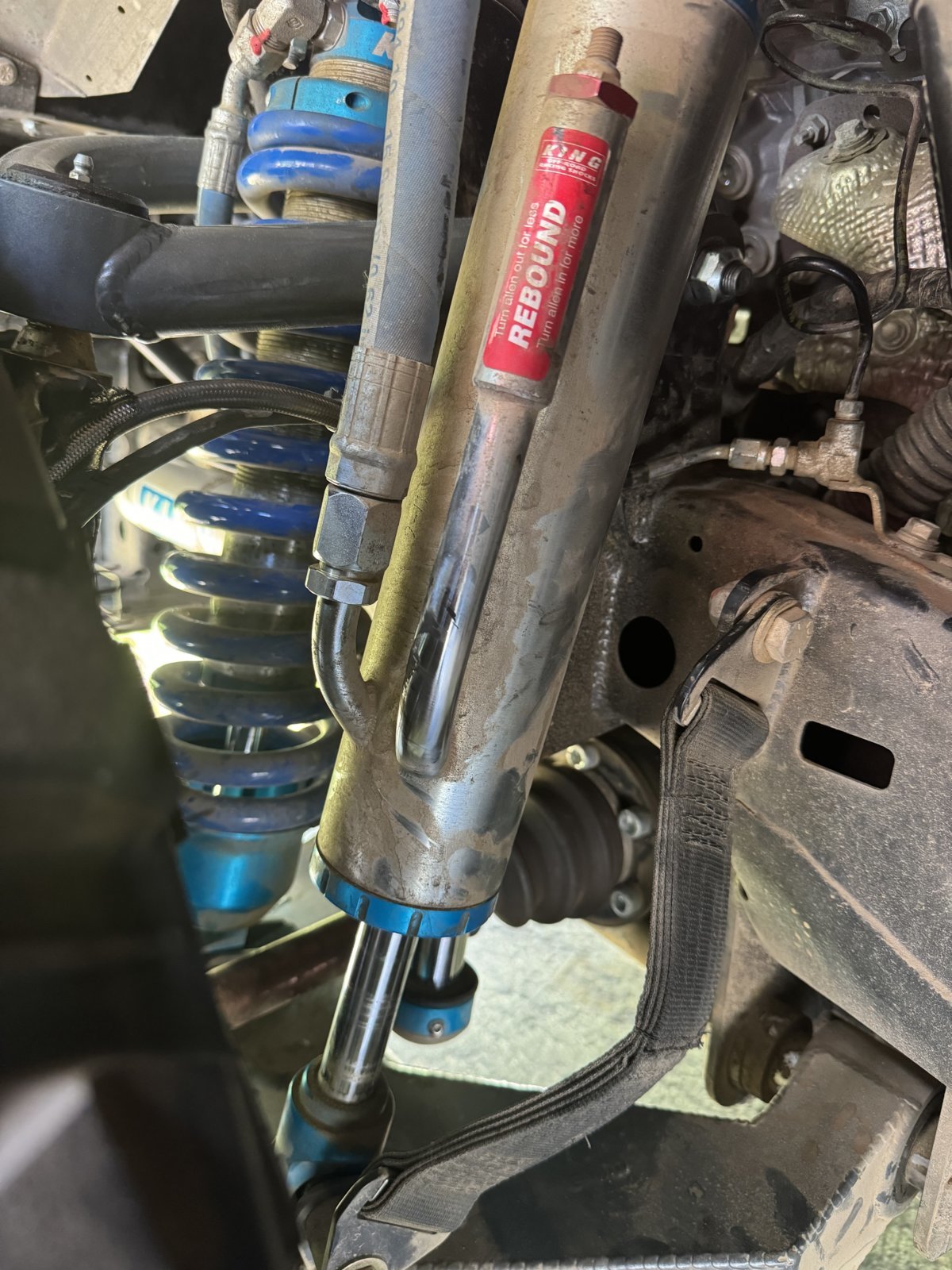

    For those following my search for the perfect offset with the secondary shocks on a 2.25 kit: I think it's probably 4" but I'll confirm the next time I can be bothered to fight my heavy ass wheels to do some test fitting. I'm currently running Method 703s in 17x8.5 +0 (~4.75bs) and I printed an ~8.6mm spacer to emulate a 17x9 -12mm (~4.41" bs) wheel and it still rubs pretty bad on the secondary shock bypass tubes. Going from 4.75" to 4.41" fixes the rub on the UCA, though, so there's that.
    This is with the ~4.41" bs. The fat lugs on these Baja Boss XS's don't help and neither does the tube layout, not that there's a lot of options for that.

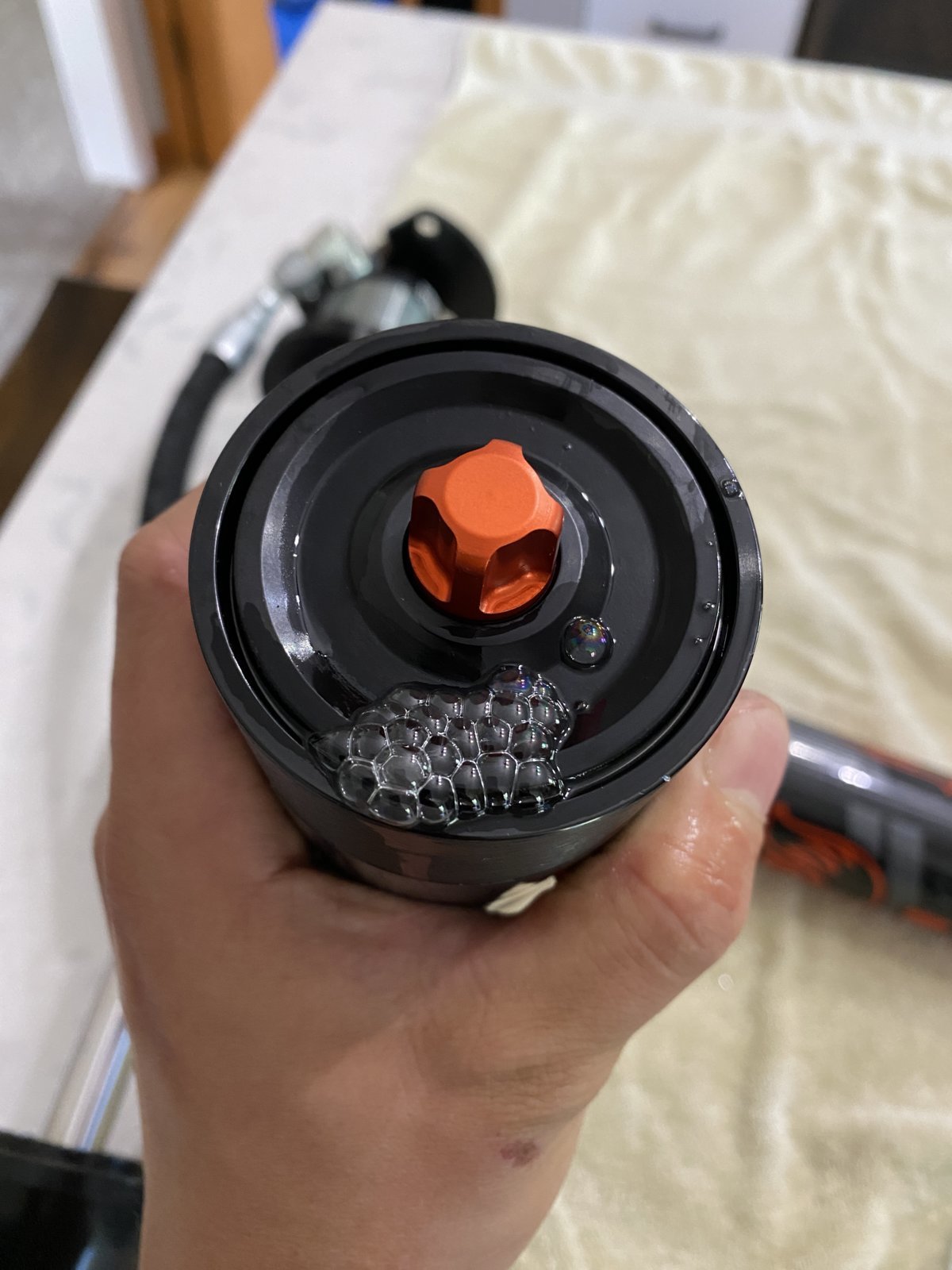

    well i figured out why one of my Foxes had no precharge.
    got all the fittings in to charge it myself and charged it up to 200 psi....
    got a bunch of bubbles at the end of the reservoir.
    Called up Jesse and he walked through "disassembly" of the end cap and what do ya know.
    some pube from the Fox assembly guy laying across both o-rings.
    Ugh.
    cleaned it up and reassembled and no bubbles with shop air pressure.
    I'll try a full 200 psi of nitrogen today (tank isn't at home) and cross my fingers this is it for hiccups!

  16. Jul 9, 2024 at 6:30 AM
    JasonT87
    JasonT87 Well-Known Member
    Feb 6, 2016
    #177280
    1,023
    Jason
    Southern California
    '16 TRD Sport DCSB
    Total Chaos mid-travel front. JD Fab SUA rear.
    At least it wasn’t a shop rag in the body
    Slashaar likes this.
  17. Jul 9, 2024 at 8:56 AM
    WormSquirts
    WormSquirts Armageddon
    Dec 18, 2015
    #172583
    2,909
    Braeden
    BC
    literally classic fox. its 50/50 with their assembly team.
  18. Jul 9, 2024 at 9:01 AM
    Blueberry.Taco
    Blueberry.Taco blueberry.taco (IG)
    Sep 14, 2020
    #340806
    887
    Ryo
    Fulltime Overlanding
    Long travel house on 35s with a custom aluminum utility bed and FWC
    some welding required
    yea, one shock is holding pressure, one was bad. 50/50!
