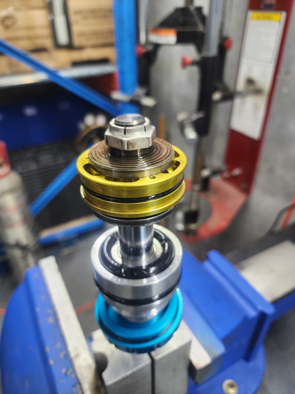

    Speaking of kings digressive piston...

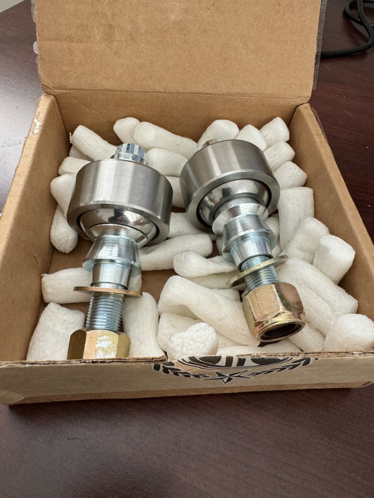

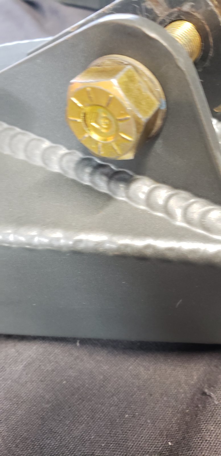

    The most up to date used kit courtesy of JDFabs excellent customers service..
    Bling Bling Hardware..

    Is that the new jd joint?

    definitely looks to be much different than the one I received end of 2023.

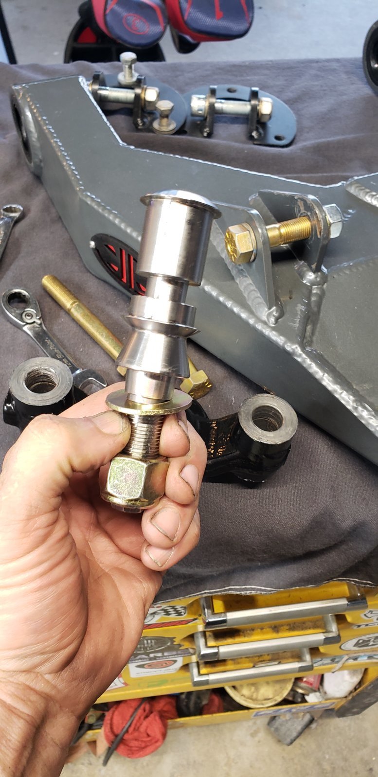

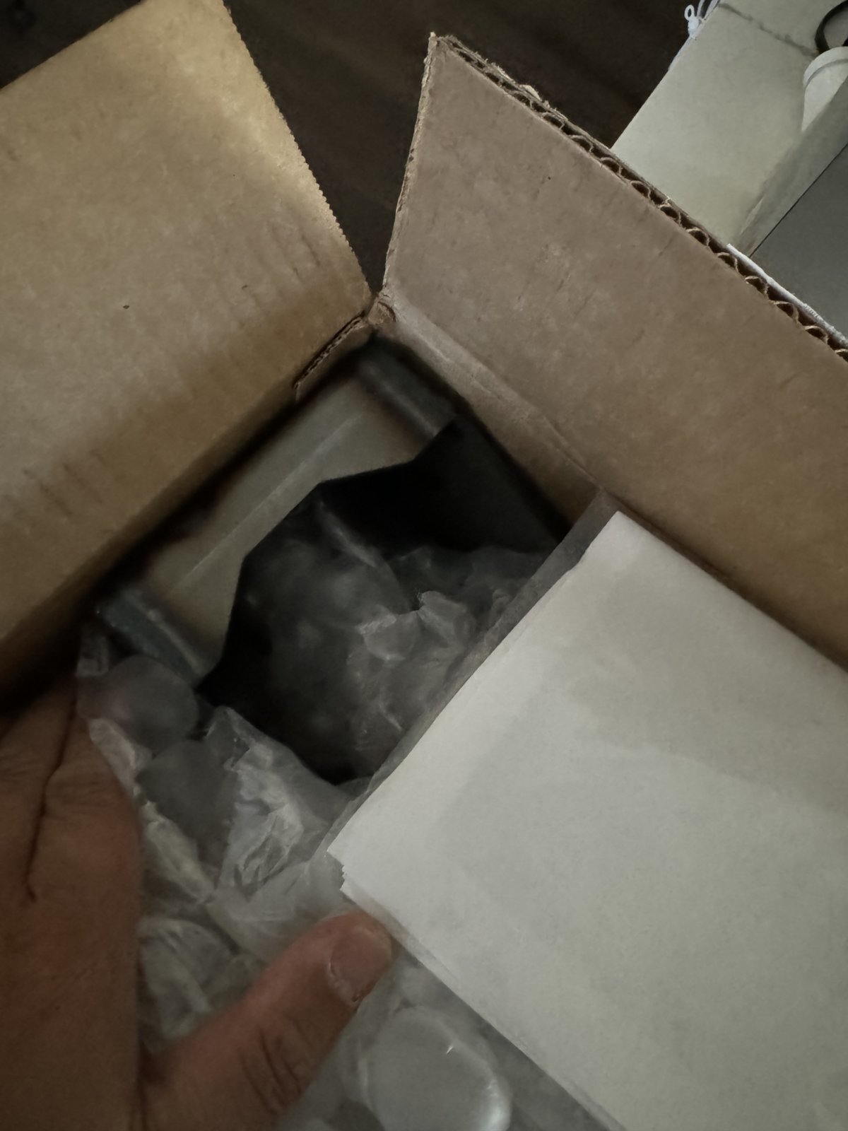

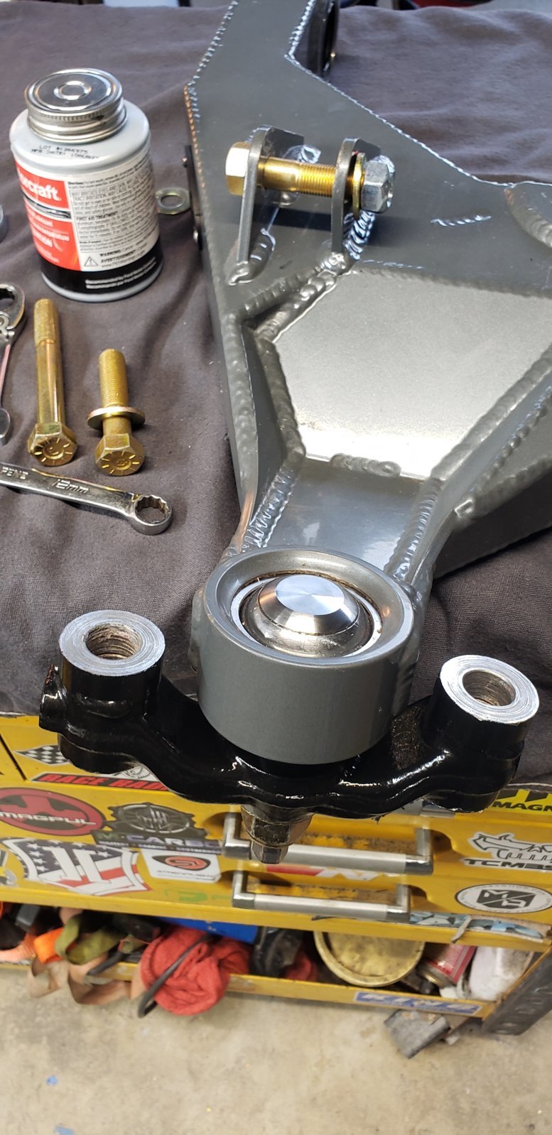

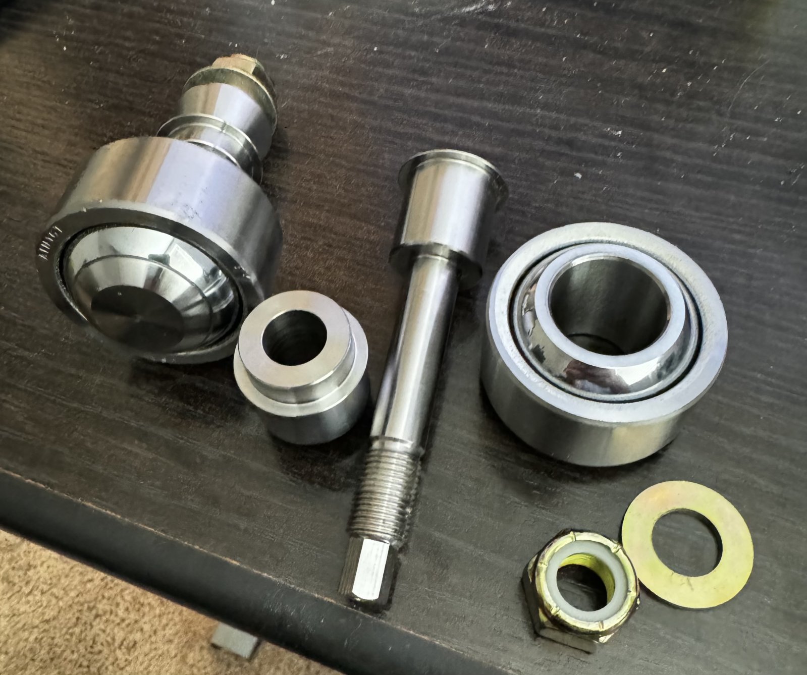

    Those are what replaced my EMF ball joints on my LCA’s. These are what I got yesterday to replace my uppers.

    yours came in quick. Ordered mine over the weekend. I’ll probably knock those out same time I do the towers.
