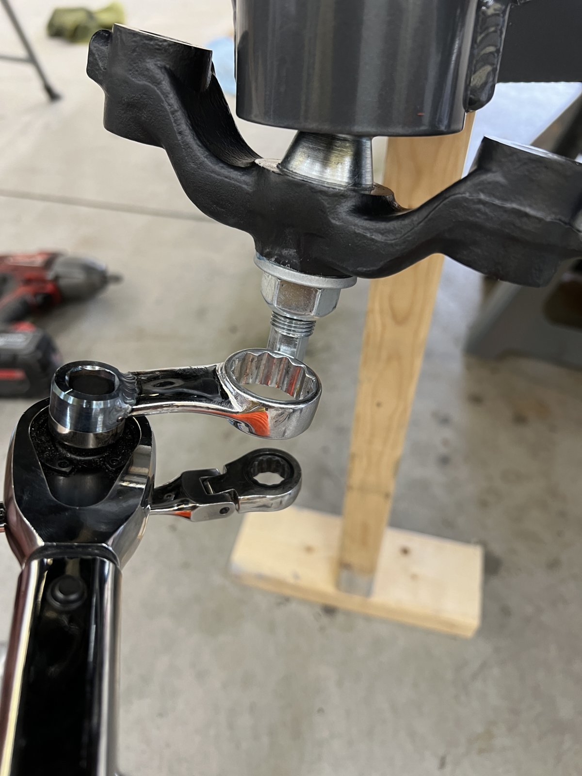

    Yea the new JD joints have a hex
    But like was mentioned, for spinning joints, just bind them up to add frictionIMG_5120.jpg

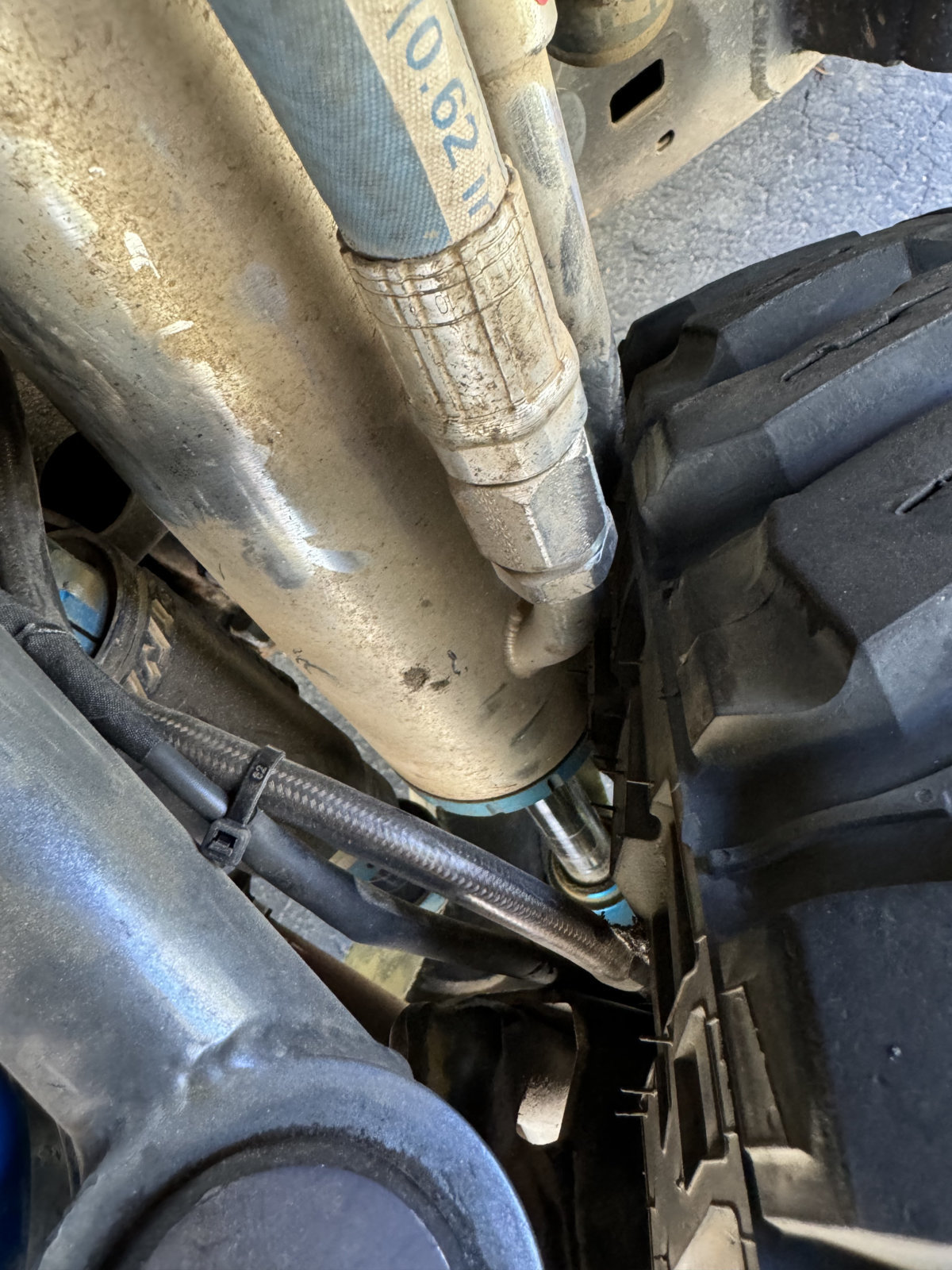

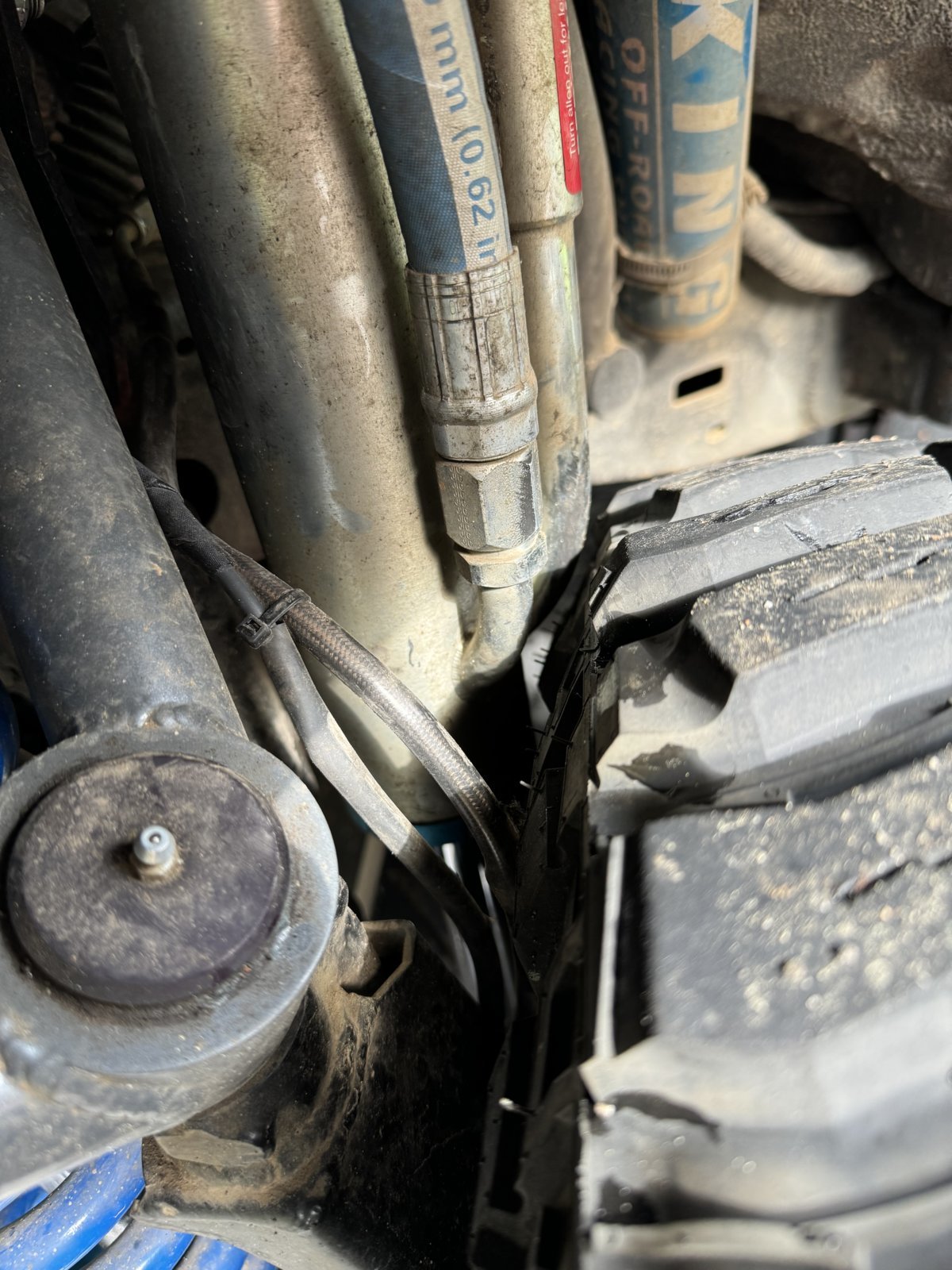

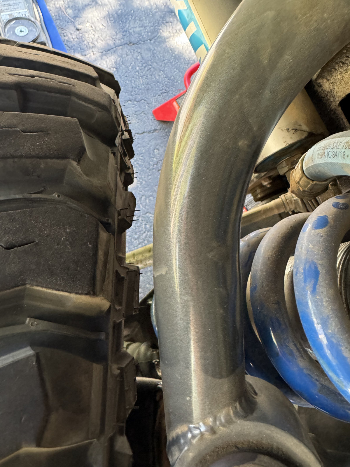

    As expected, 4” backspacing clears. This at _full_ lock with the wheel cranked and then the engine power cut and held. It’ll probably still rub at full suspension compression but when I’m worried about that I’ll be aired down anyways.
    If I was running a tundra rack I don’t think this would be an issue because I wouldn’t be able to turn that far anyway. Something to keep in mind.
    For now I’ll run the 0.75” spacers (I bought some hub centric Bora’s after testing) and see how I like the extra width. It’s pretty wide for a 2.25” kit. If I can deal with the width I'll replace the wheels and if not I'll pull the spacers. :bananadead:

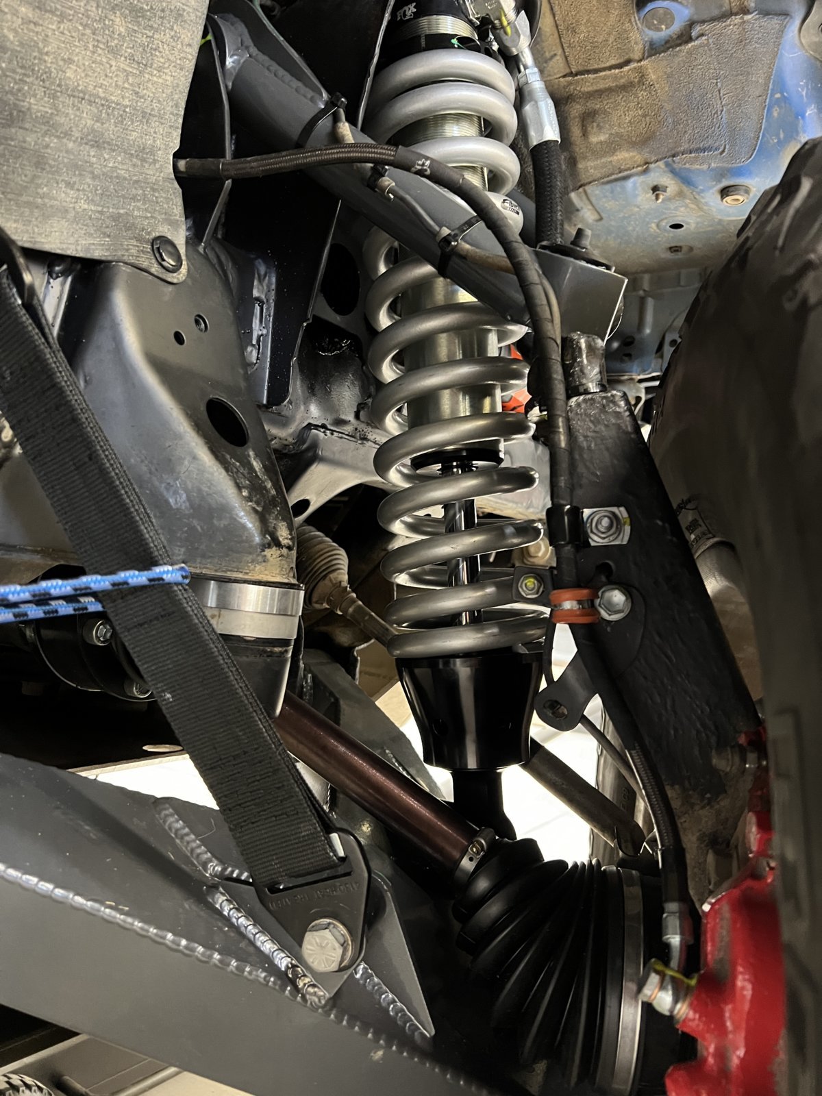

    Turns out doing exactly that worked perfectly. Clipped a little higher to keep it tucked to the upright higher and at least static checks pass. I’ll keep an eye on it on the next test drives. it does hurt me to stick a m8 through the tapered sway bar end link hole but I couldn’t justify turning an appropriate spacer just to hold a p clip. :(

    Pressure. Pickle fork (if you're replacing the joint as it can screw up the boot) or I saw a video where they used a bolt with a nut between the lca and the cradle and backed the nut off to apply pressure. Then any ol ugga dugga will pull it off. May have to adjust setup as you go to maintain pressure.
    Oh right EMF, Uh a pickle fork might still work but not sure if it'd damage anything.
    Suicyco[QUOTED] likes this.

    Like eatsleeptacos and blueberrytaco mentioned i just had to crank the adapter to the side to get some friction on the emf ball. Honestly didn't seem possible with all the grease but when twisting bolt by hand til it got just a little bind and hitting with an impact it popped right off. Thanks

    "Suicyco, post: 29989586, member: 210044"]How do you get the nut off the emf joint without it spinning?
    Isn't there flats on the top side of the joint? I used a crescent wrench ...Or is that just the upper EMF that I remember

    Nothing I could see on the lower

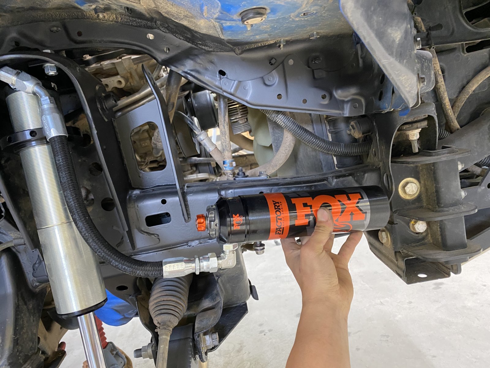

    I am SUPER late to this party but figured I'd respond anyway. The resi can mount directly to the side of the frame. The 90* fitting that goes into the resi does require a slight bit of adjustment but it's pretty easy to do. You can of course, mount the resi in many different ways as long as the hose isn't kinked.
    You'll probably notice this is a Dirt King kit but this is a JD spec'd C/O.
    Did you make sure that you don't internally bottom out the shock at full compression if you go to a 1" longer shaft? That's not the JD spec'd shock, which has a bit more stroke than the C/Os you have.

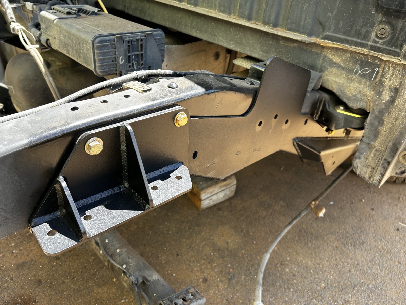

    Got the rear frame brace finished up and mounted. Moving onto mounting the fiberglass bed sides and prepping the axle for the SUA.
    For those who have installed the JD SUA kit, what were your pinion angle measurements? I took some prior to disassembly but figured it would be good to compare.
