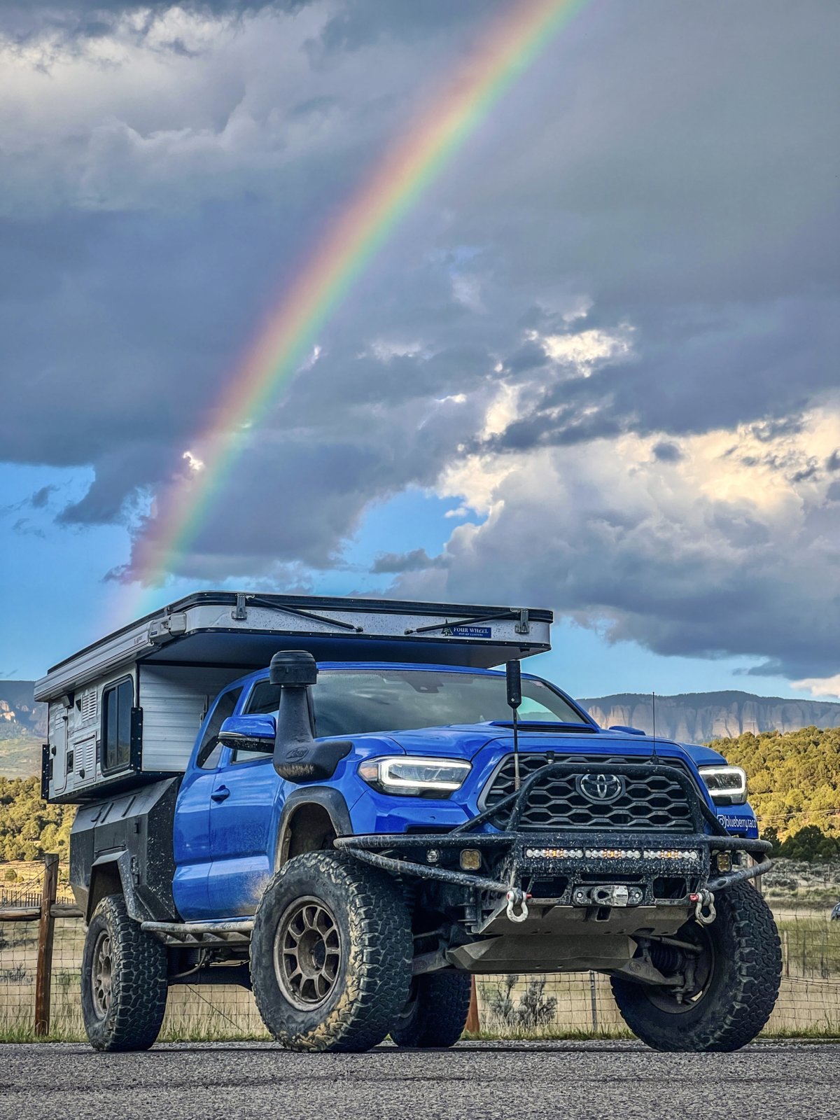

    Came back from a fun week of wheeling in the Colorado mountains, am 100% sold the 500lb springs are the appropriate choice now. they work really well for the colorado style wheeling we were doing at least.
    they didn't settle any more than the pre-trip shakedowns, (nor did the new leaf packs) which is a touch disappointing because I want to bring the ride height down a hair, but I'll figure it out. (3500+ miles since install)
    Unfortunately with the current front ride height I'm maxed out on alignment adjustments and having to compromise either camber or caster. For this trip I tried running 2.75deg caster to get +0.25 deg camber (yes positive) on both sides.
    This is with both cams maxed "outboards" and then dialing the front cam inboard just enough to eek out to 2.75 caster.
    When in low range the alignment was fine but on the highway I really wanted a bit more caster, so looks like I need to compromise with even more positive camber to get there. Anyone else running at the limits of their alignment adjustments? Or is this because I'm sitting pretty high currently? Crossing my fingers that maybe lowering it down an inch will give me some negative camber back

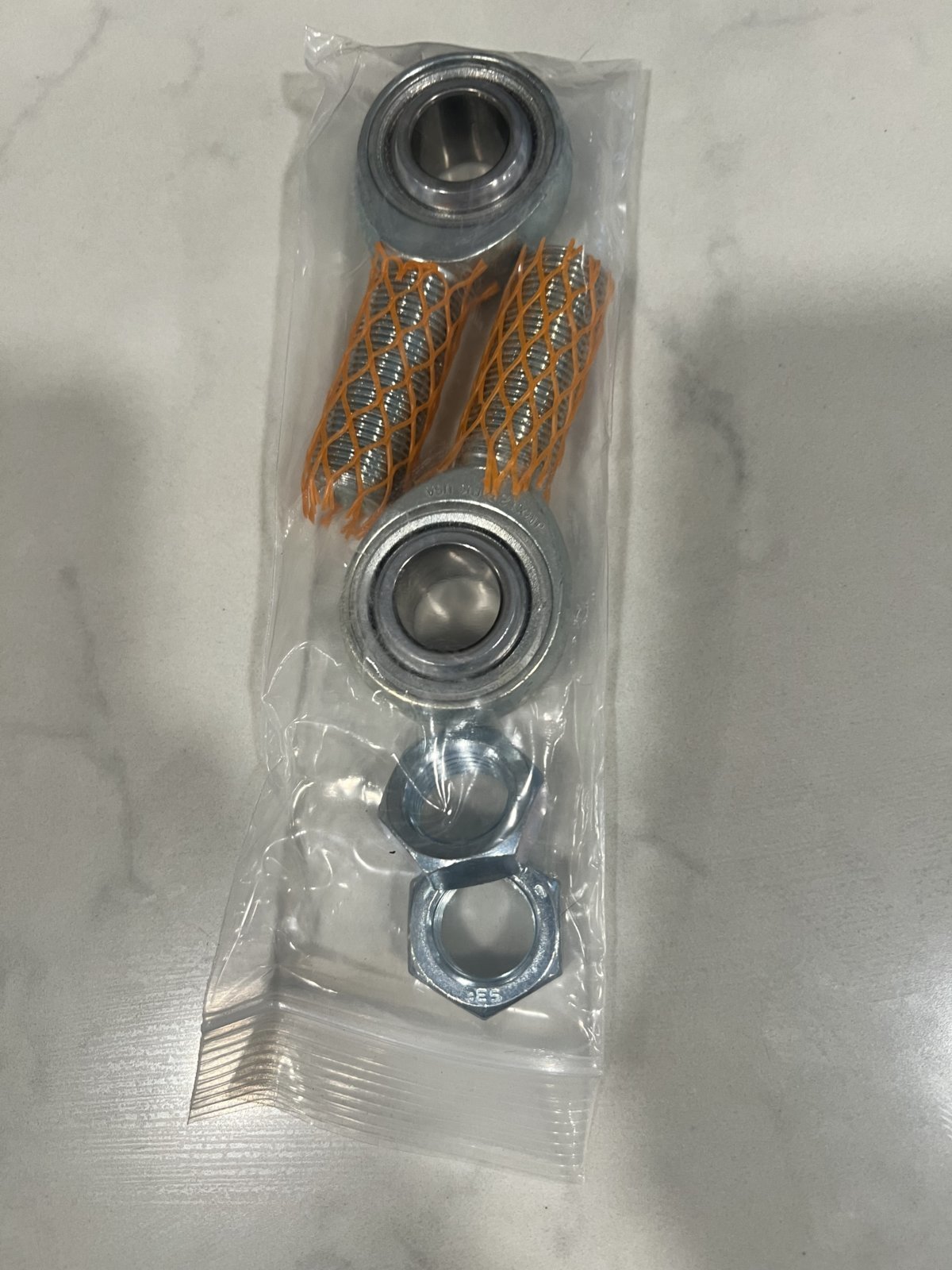

    Not sure why I got heims though?

    :rofl: and only one set?

    Other side is coming tomorrow haha I gotta know about these heimssss. The uppers are poly so that’s not it lol

    Ahhh, I see. Hard to tell what size they are in the photo, but they look big for steering.

    Well they do look to be the same size as steering heims I’ve used before. I don’t see any tie rod extenders. Might email Jesse after the second package comes in. Maybe more will be revealed lol
    Edit: found a parts list. Says two steering heims and two steering extenders. Little more confused lol
