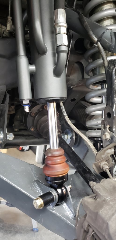

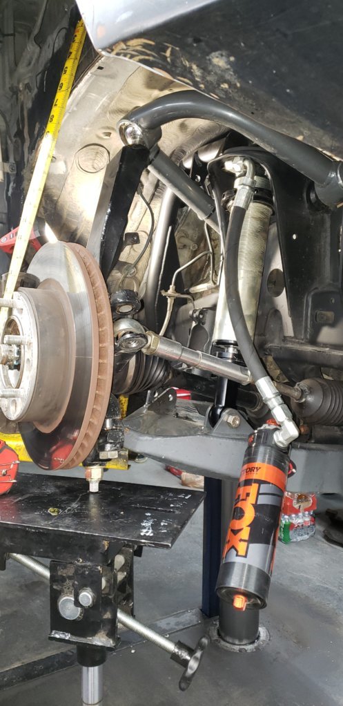

    Is this close enough?

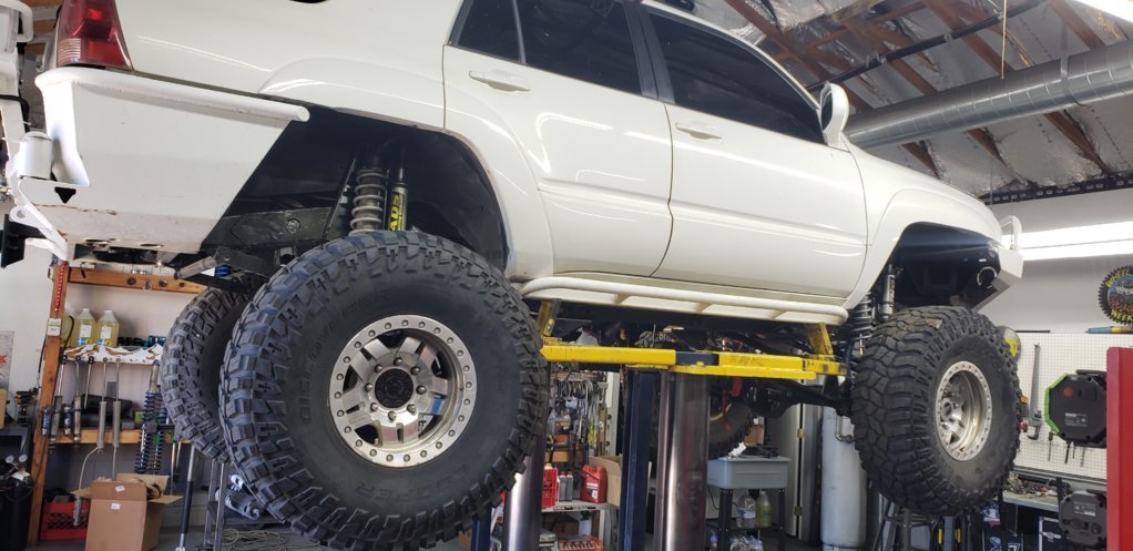

    12" travel without shocks, bumps or straps..
    The C/O's are not compatible with this kit, so I'm stuck until I get the correct ones. The travel numbers with the wrong C/O' will be in the single digits after properly setting straps and
    Bumps.

    So the uniball is limiting travel to 12”?
    Shocks aside that doesn’t match the claimed number of the kit. Surprising for a 4” over kit.
    MonkeyProof[QUOTED] likes this.
  4. Aug 24, 2024 at 11:49 AM
    MonkeyProof
    MonkeyProof Power Top
    Oct 7, 2008
    #9774
    12,839
    SoCal- SGV
    The binding at the bottom of the Uniball Cup and Misalignment is the limiting factor for sure. Im curious to know the diameter of the misalignments of the now obsolete EMF setup compared to the new design. Maybe the diameter is larger and making so everything binds sooner.

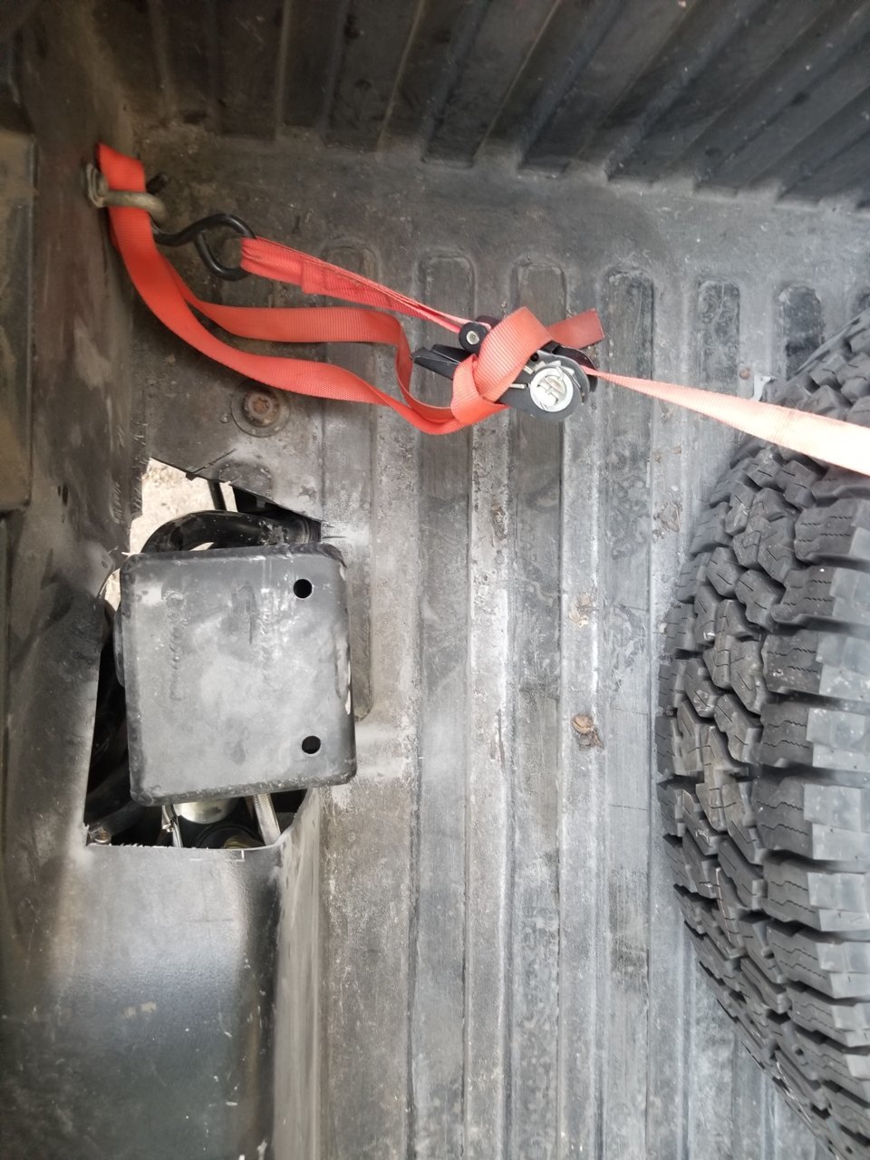

    Temporary Bump Stops courtesy of General Motors..

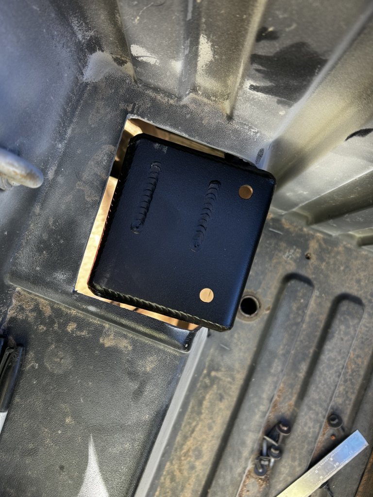

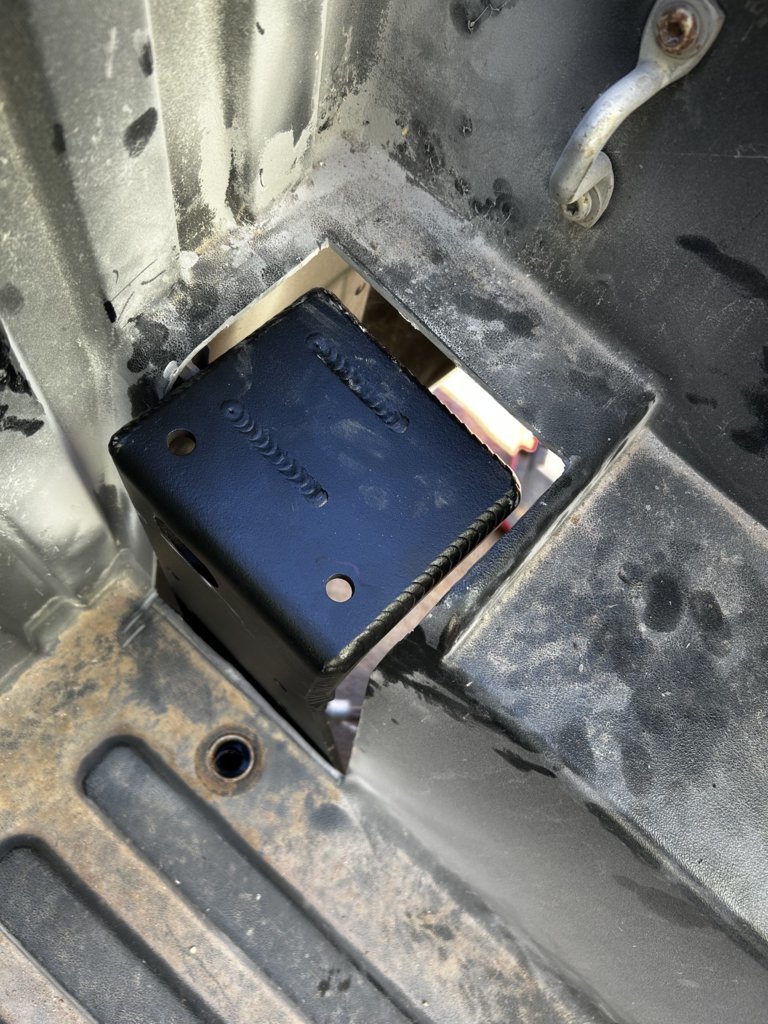

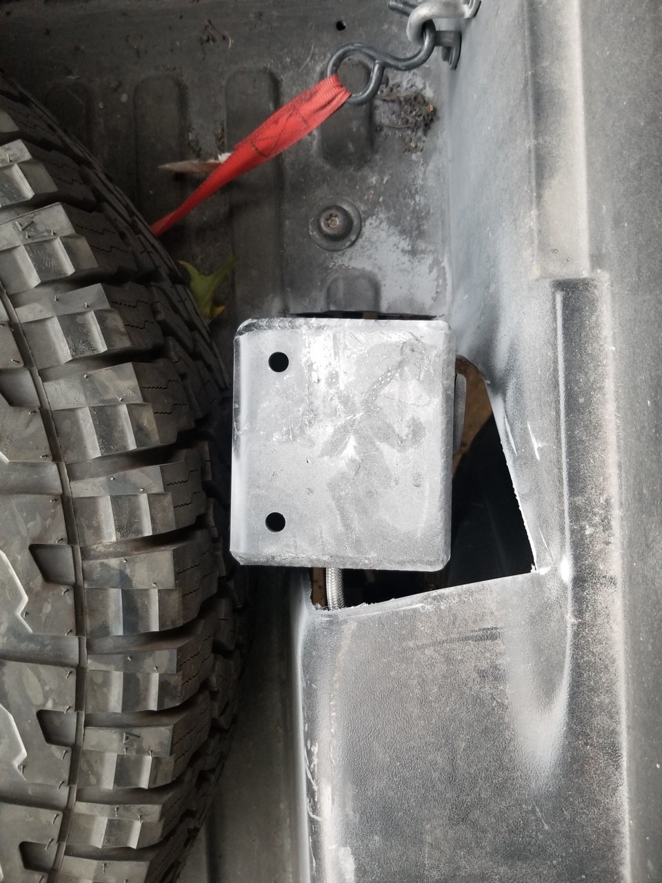

    I think I’m done cutting. Didn’t turn out too bad. Not quite as clean as I would have liked but I’ll accept it.

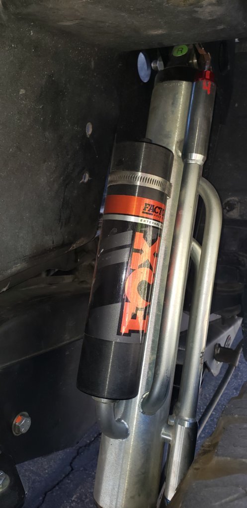

    I am getting more excited about this project…
    Now the fun begins.
    Standard layout Fox 3.0 x 14” (3 Tube) R/R
    MonkeyProof, Airdog and WormSquirts like this.

    I have the fixed resi on mine so I wouldn't be able to rotate the body anyways for the Adjuster clearance like we were discussing earlier..

    Still has a rotating body cap. Just depends on clearance you have between the bed & resi.
    I may have to rotate mine to clear the hose fitting when articulating but I’ll confirm when cycling.

    As long as it looks better than mine, I think you're okay.

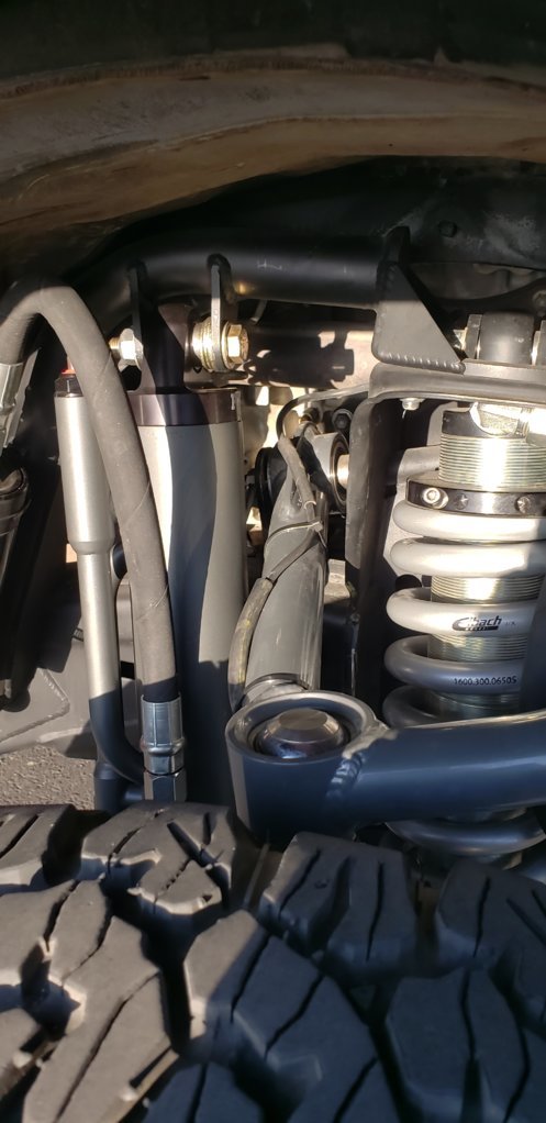

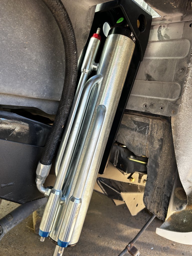

    Plenty of room for a 3.0 3 Tube Bypass.. Jimmied up an offset misalignment spacer using some washers

    Did you not receive the aluminum spacer that comes with the kit?
    Slashaar likes this.
  16. Aug 26, 2024 at 8:44 AM
    MonkeyProof
    Oct 7, 2008
    #9774
    12,839
    SoCal- SGV
    Pretty sure I didn't, ill have to check my box of misc hardware and what not that I got from RonRon. I know that for sure that they were not included in the box when I recieved the Bypass Mount kit from JD.
  17. Aug 26, 2024 at 9:01 AM
    desertjunkie760
    desertjunkie760 @DesertJunkie760 (IG)
    Apr 11, 2016
    #183963
    9,152
    Shane
    2011 MGM DCSB TRD Sport 4x4
    Check My Sig.
    Pretty sure they're supposed to be included with the bypass mount kit from JD.
    It's been awhile since I received my kit though so I may be mistaken.

    According to their description, the kit comes with shock mounting hardware and spacers. I recieved neither of that.
