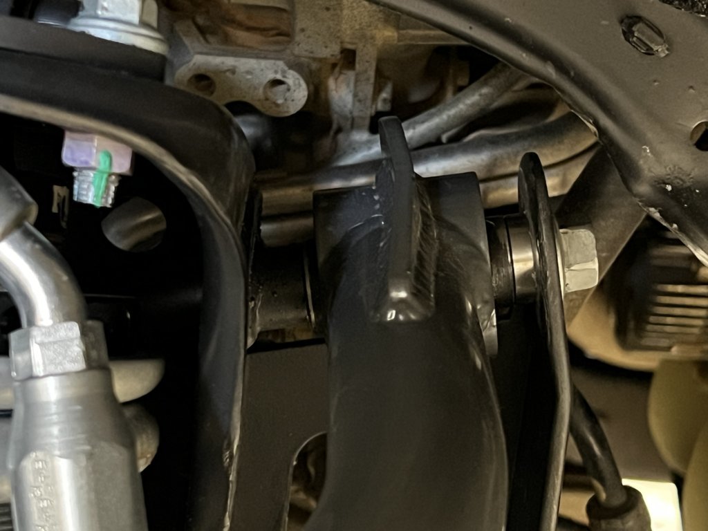

    I finally got around to machining the misalignment spacers for the JD UCAs and was able to move the UCA backwards by 0.250" to gain more caster
    (3rd gen, stock LCA tabs with marlin gussets, 2.25" kit on 500lb springs)
    prior to moving the UCA back I was maxed out on adjustments to get 2.25deg of caster but with this move i was able to dial it to 3.875deg. Street manners are much improved.

    You have to move the uppers forwards a lot to move the tire forwards but it’ll affect caster pretty quickly. I would be surprised if you can get the tire away from the firewall before making the truck miserable to drive.
    Do you have any room to run less offset?
