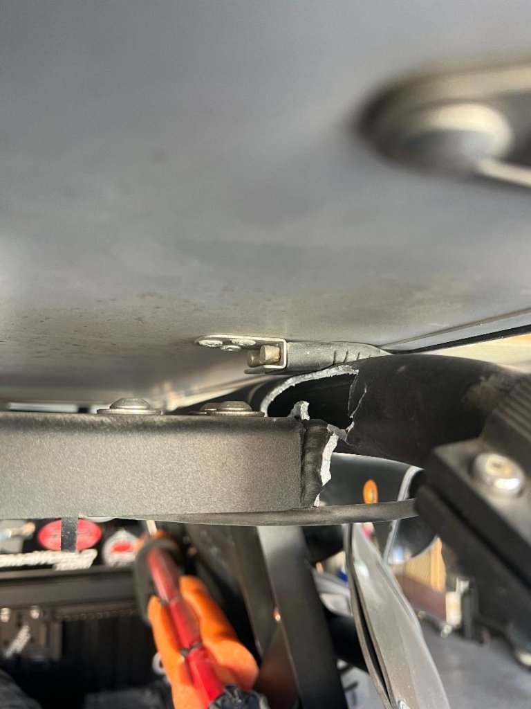

    Hey guys
    Long story short, was involved in a minor accident but one of the FR leaf hangers took some damage. Doesn’t seem to be sold separately for third gens so I’m looking at doing the JD SOA frame brace kit.
    Anyone that has done would be kind enough to send some pics? Interested in how much modification the sliders would require.

    I've done several. I don't know if I have any pics or if I did they'd be from way back, but basically we cut the rear slider support, and the frame plate, then shorten that one about 1/4", then reweld it, and weld a tiny filler plate to make the frame plate into one piece again. The frame support uses many of the same bolts as the sliders, so then it all just bolts together.

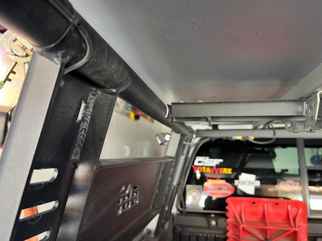

    Started out great was having a blast chasing @Airdog and @sicki around about hour into it my aluminum CBI rack blew out 2 of 3 cross bar supports completely ripped away front cross bar barley holding it together. Time to shed the rack and tent.

    That happened to someone in our group in baja last trip either RCI or CBI but same deal cracked all the corners where the tent was mounted.

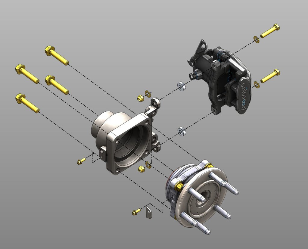

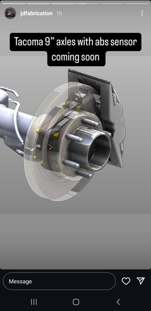

    Fits Wilwood with E-brake or 4 piston Wilwood Superlite
    01 dhrracer likes this.
  20. Dec 4, 2024 at 3:19 PM
    01 dhrracer
    01 dhrracer Well-Known Member
    Aug 27, 2013
    #111316
    1,888
    Palm Desert/Bermuda Dunes
    Still Shopping
    Would it possible to design it so it used the same unit bearing hub assembly as the front?
