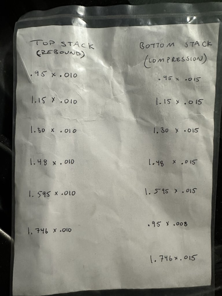

    Anyone running a +4 kit with a coilover only? If so any idea what your valving is?

    Btw as a single coil over this isn’t enough valving

    So you are saying that this is your valving with a single coilover and its not enough??? OR are you running a bypass and this is your coilover valving...

    Start with an 8/8 and walk it in if you need. I’d imagine you’d only really want to add low speed control.
    Maybe do 10s for the first two shims on the rebound side for some low speed rebound control.
    Open all of your bleeds.

    He’s talking about coil over with no bypass.
    I’m guessing this is his valving with a bypass.
    My old co only valving was
    Comp: 15,8,20’s with a handful of 20’s doubled up.
    Reb: straight 12’s
    but I am running 700# springs so depending on your spring rate you might need things a little different. But something like this would be a good starting point.

    I’m running the JD + 4 with coilover only. Valved by JD

    So you are running a 15/10 with a 8 flutter and you are not happy with it?

    Yeah it’s fairly rough in the small chatter bumps and then dives pretty hard in the bigger whoops. Trying to just wait it out until I can spend on some bypasses for the front

    Good catch. I overlooked that part.
