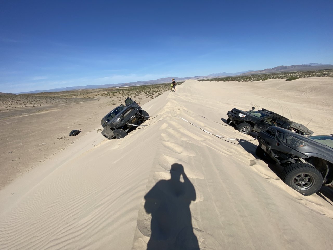

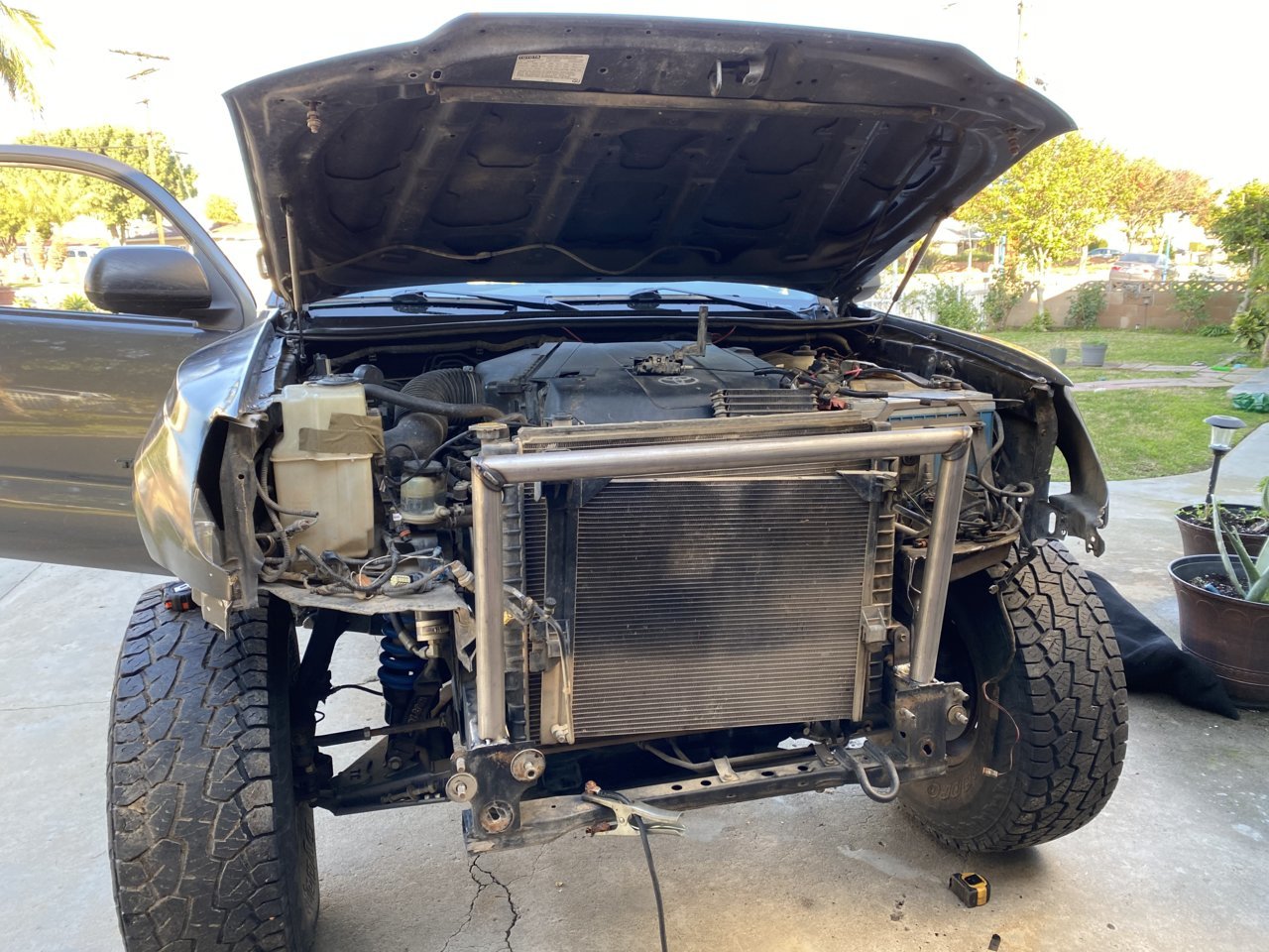

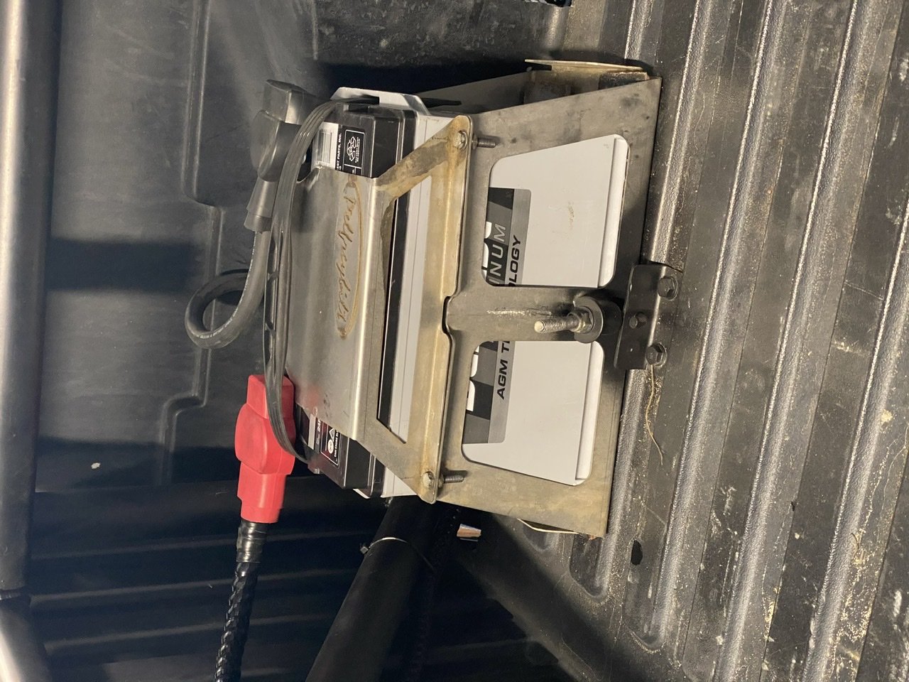

    Already ripped out the Core support and the battery...still need the inner fenders cause they are fucked too....and I’ll take on Shane in the wheeling hard/stupid competition
    I submit stupid item #1 here...super bad idea on a razor back sand dune.
    32E6970D-AFC1-401B-BEE4-B3296FA740E9.jpg 615F9A5C-97B4-470B-AD73-1786FB6DA02A.jpg 8788A0DC-3320-49D4-8F3D-A57A51C0B19B.jpg

    Luckily, I haven't done anything like that yet but I'm impressed. I'm not seeing how you even managed. o_O

    Well I fell into the stupid category thinking that side of the bowl was flat on top like the side I came from...it wasnt. My thought was to just kinda carve/turn at the “flat” top and drop back in...well it didnt turn out that way at all. Kinda launched it and did a bit of a kick turn and buried it on the other side of the dune. It broke the tire bead on the rear left side. Thought for sure I was gonna roll it. Some onboard video.

    Looks like fun! I would have liked the recovery experience.

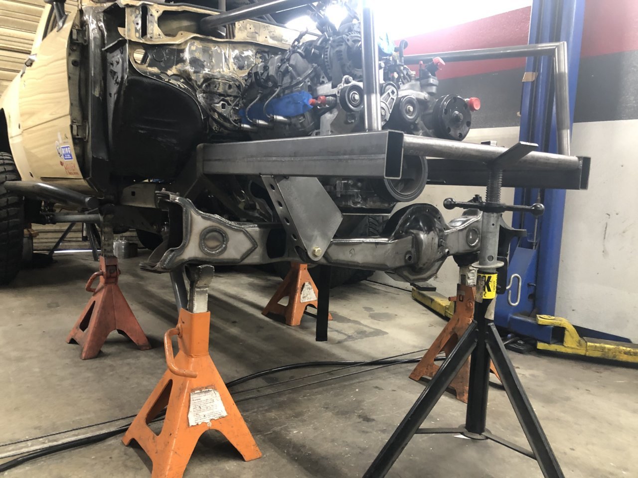

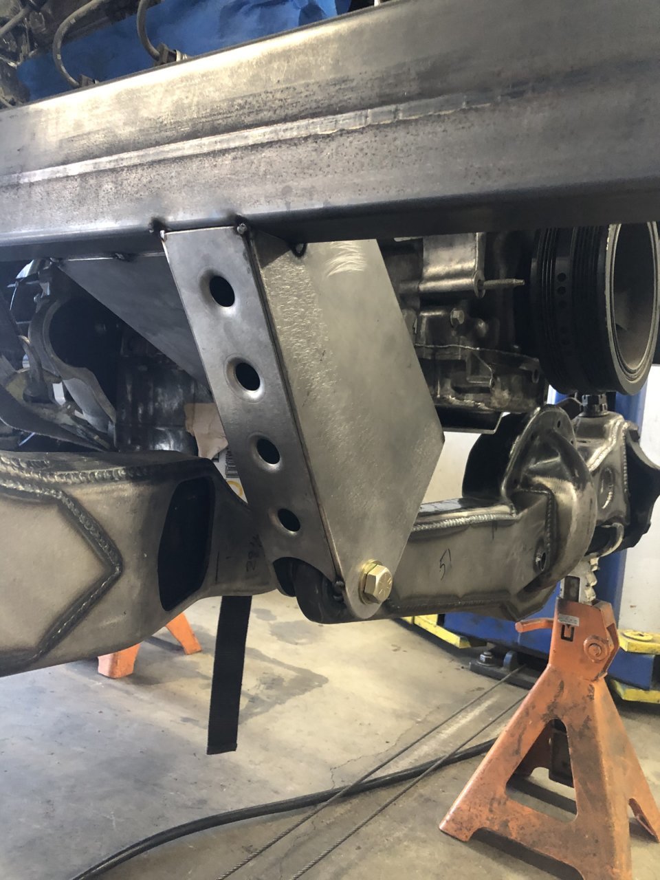

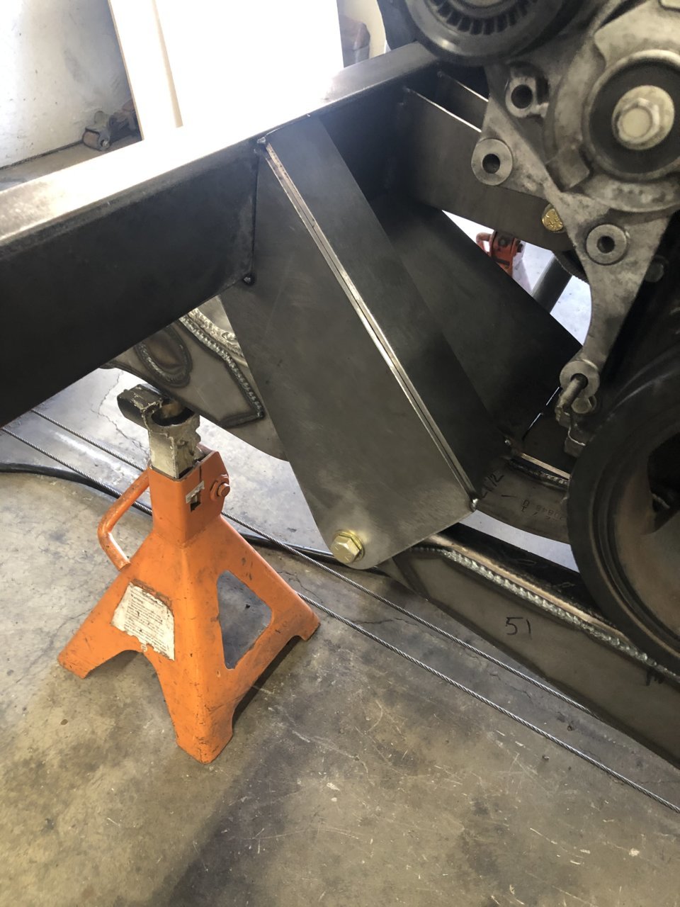

    I even managed to get the beams mounted on my 81 last night too...

    Interesting going with the ttb. What brought you to that decision?

    18” of independent wheel travel and 10” of uptravel with a very low ride height. Solid axles hit the oil pan way too soon. With TTB’s my 37’s rub the bottom of the hood at full bump and the truck sits much lower than a stock Tacoma at ride height
