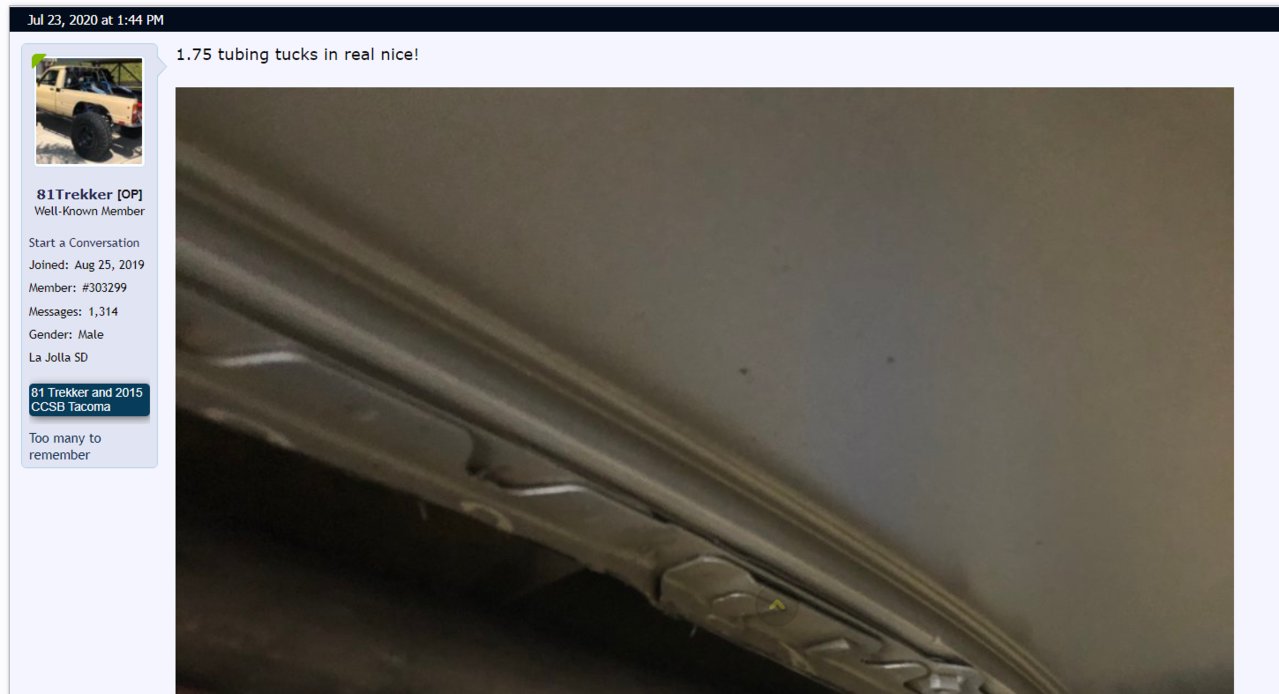

    Is this the build where you are trying to tuck the cage as much as possible?
    Edit, never mind just saw the comment above!

    1.75 tubing tucks in real nice!

    oh yes. I have seen the the cages on the other prerunners and that land cruiser...super clean. Must-have. Now. How much to jump @Evenflow in line?

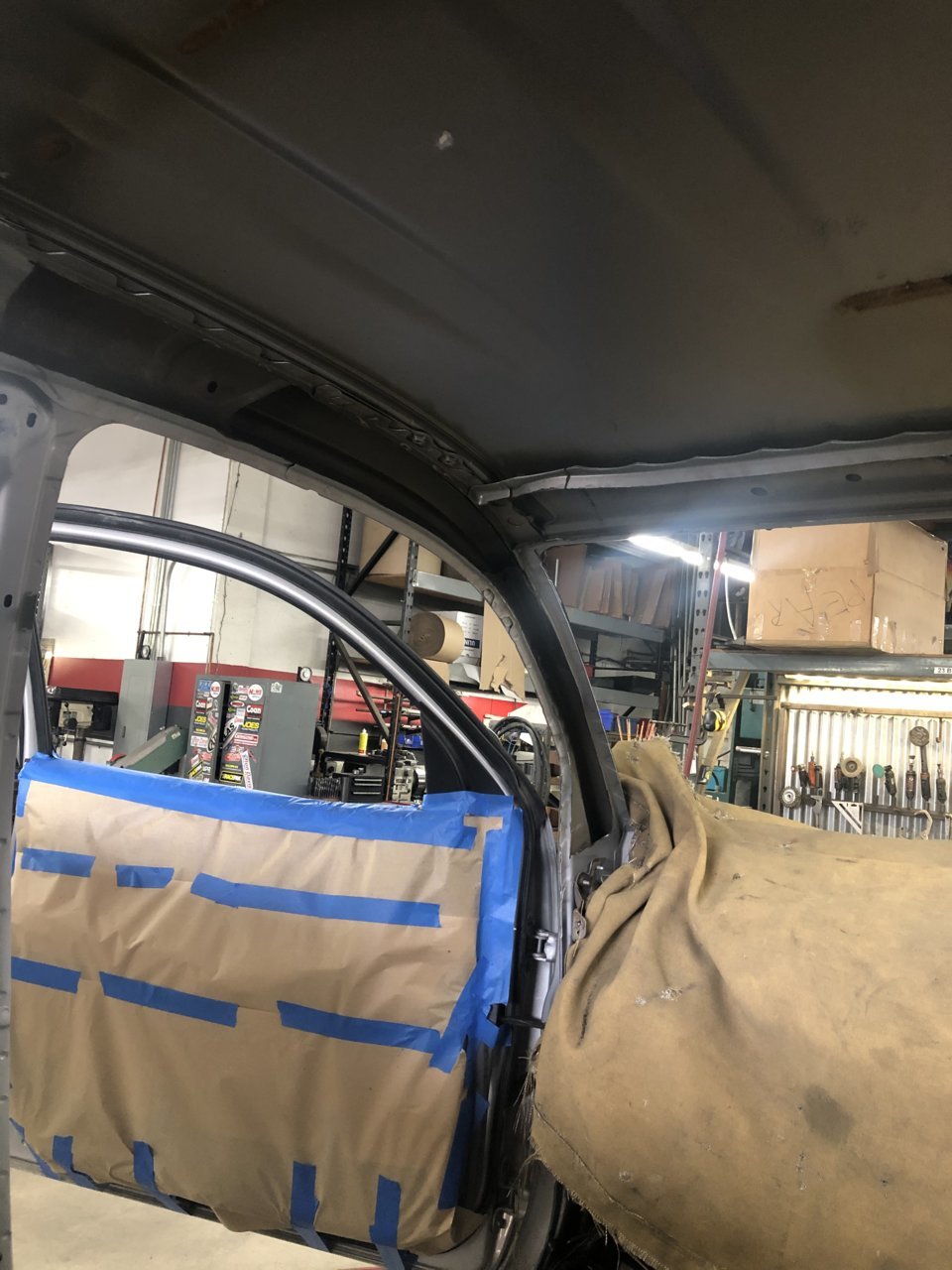

    Think you can put the airbag back in with that approach?

    Right, and airbags are a great answer to that problem. This is the first internal cage I've seen thats even close to tight enough to keep them.
    Otherwise I'll go my original plan, and build an exo-cage. Not as strong, but I'm not building a race truck, but it's better than no cage, and keeps the airbags on the inside.

    Never see guys with airbags and a cage really. I mean you could notch one in or mount one if you needed it.

    Looks like they cut a lot of the inner structure out to tuck it up and in that channel. But IMO that's the way to go as you can regain some strength back by tying the body to the cage if you really want to. It also doesn't kill visibility.
    Arcticelf[QUOTED] likes this.

    Exactly, the structure of the cab is a lot less important once you have a cage. Especially if it's properly built.
