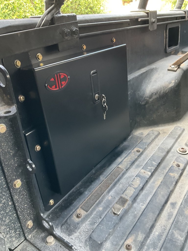

    Took advantage of the Memorial Day Sale.. wasn’t too bad to install

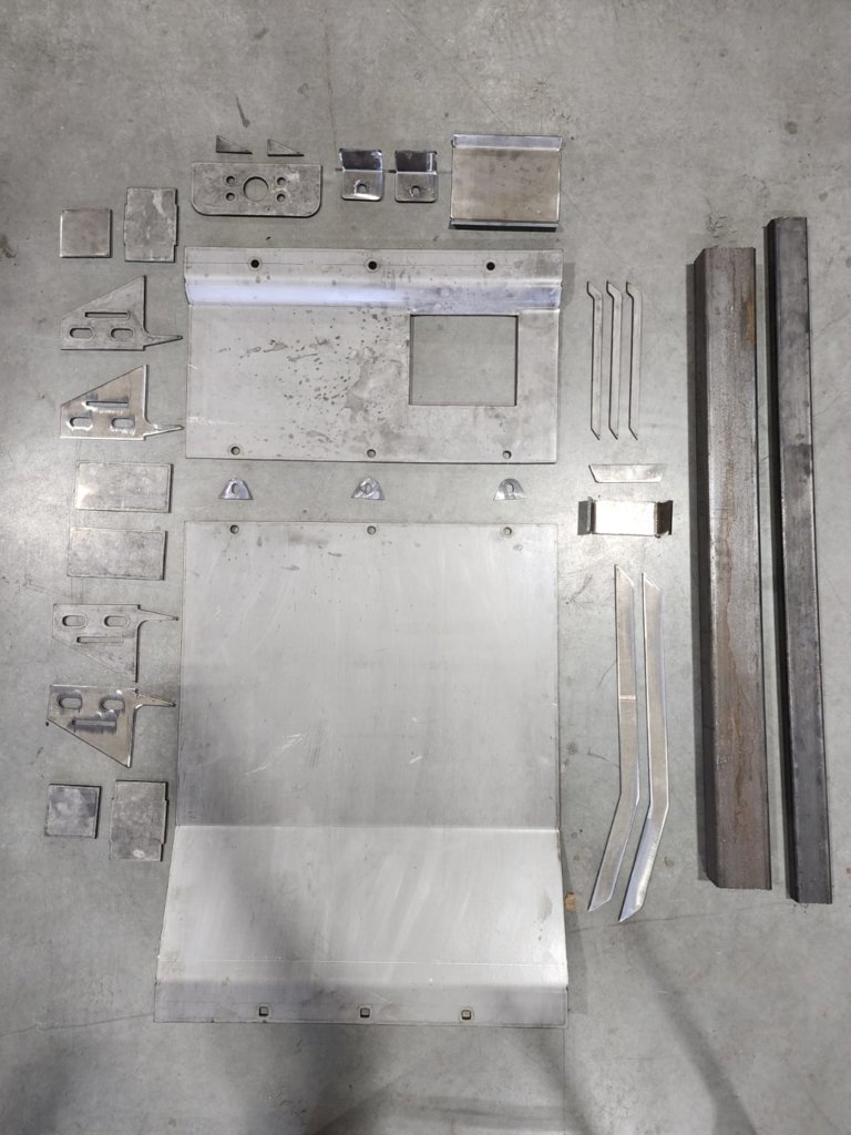

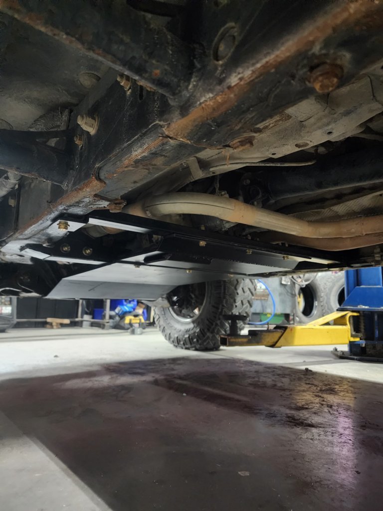

    We need to see more details on the skid plate and how it is supported along its length.
    Slashaar likes this.
  18. Jun 13, 2025 at 2:02 PM
    WormSquirts
    WormSquirts Armageddon
    Dec 18, 2015
    #172583
    2,939
    Braeden
    BC
    I probably won't make one, but the rear part of the skid would be relatively easy to make something.
    The skids have stringers. I made the original design (cad photo attached) with 3, but the middle one is a bit close to the trans for comfort, so I've only been including the two outside ones. Haven't seen the skid bend or dent yet from the 2 guys we tested it on that hammer their trucks pretty hard.
