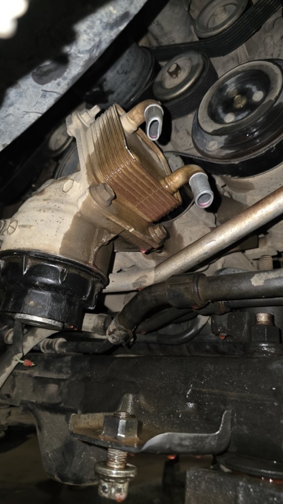

    If anyone can chime in here, struggling to get the HOWE TC pumps top bolt/bracket. The fitting keeps hitting on the oil coolers hard line. Cant missing about 1/4" of clockwise rotation to put the bolt in the top.
    Loosened as much of the hardline brackets as i could but still no bueno.

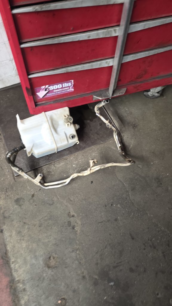

    Figured it out over time and headache. Had to remove the hard coolant lines (3rd gen) that snakes around the engine to the heat exchanger. Then redo rubber coolant lines instead. The pump wouldnt fit at all with the hardlines in there.
    I'm guessing the 2nd gen trucks may not have these lines in the way. But it's all installed now, will eventually change the rack as the outter end seals are sweating a tiny bit. Drives amazing and crazy how quick and easy the steering feels for the 35s now.

    These hard lines in question.
