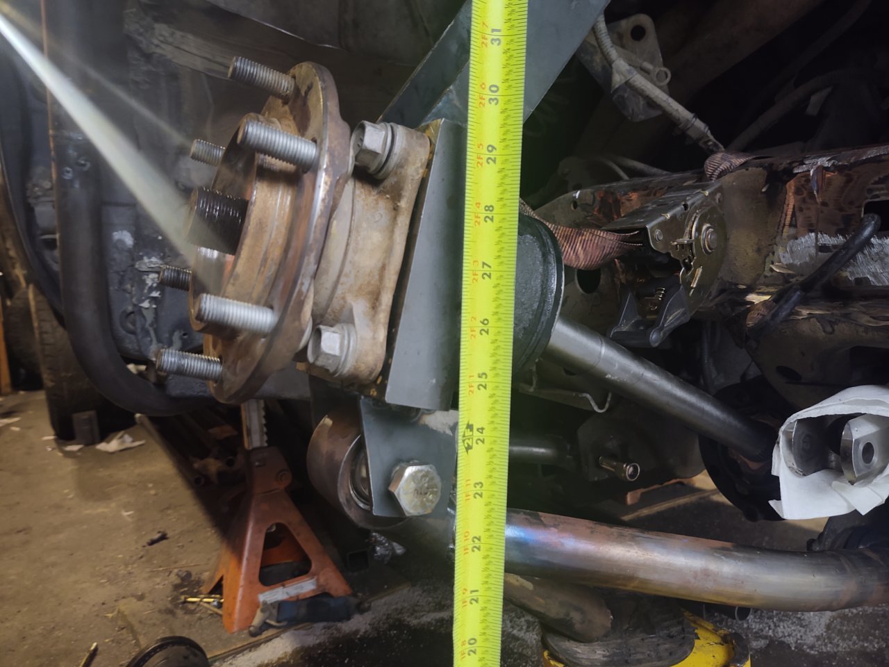

    Since I was measuring up and down travel purely based on feeling resistance in the CV while spinning it by hand? There was certainly articulation left in the inner and outer. We'll see what the angle meter says.

    The CV had better be the limiting factor in this design...

    You also run into the issue of the outer tie rod binding

    True. I can always make than a vertical orientation too, although I think I can get enough angle out of the hiem joint there.

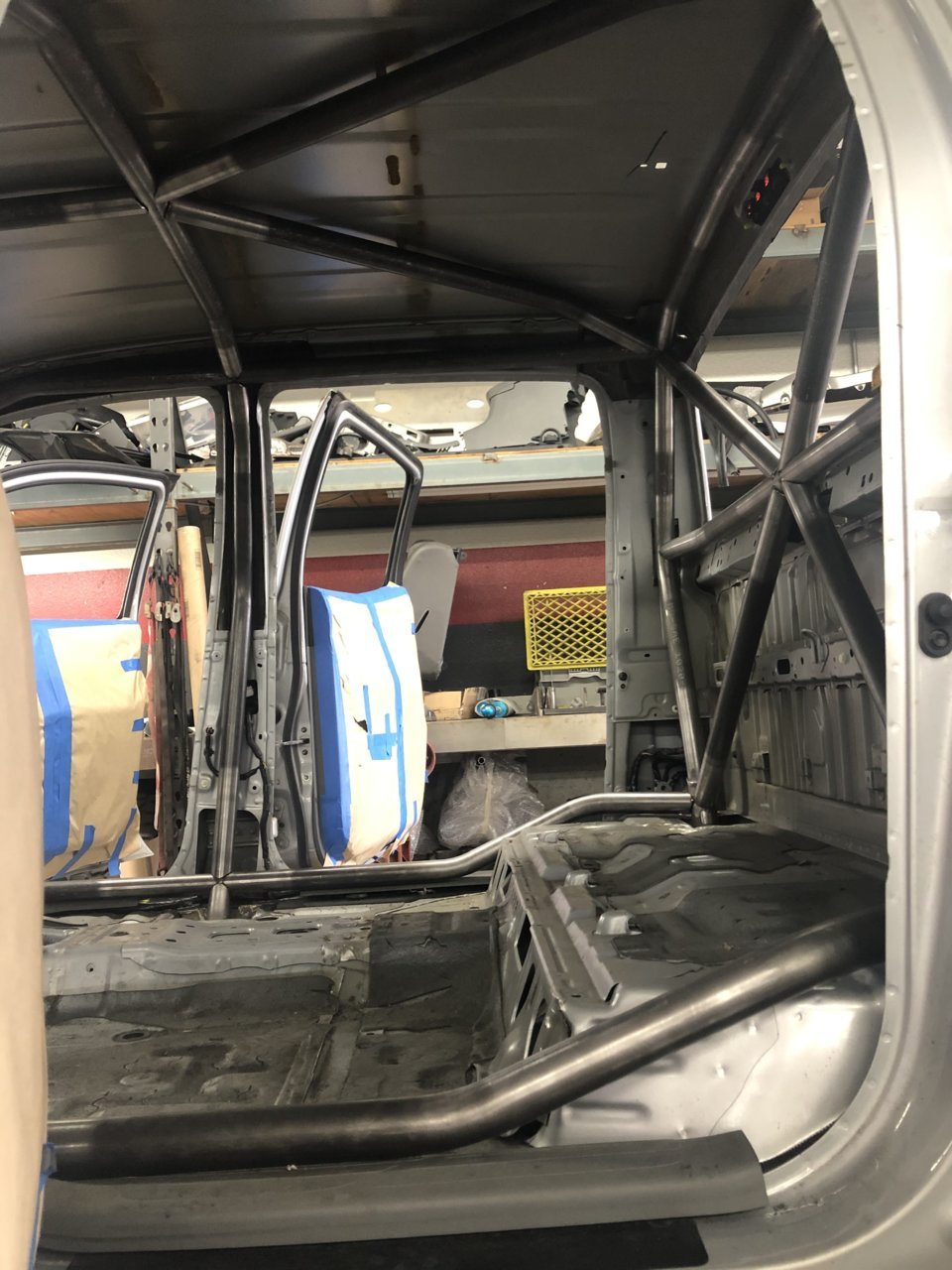

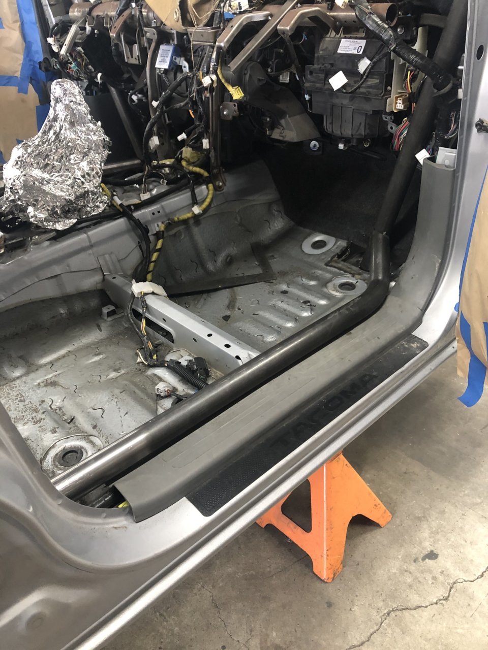

    Got the floor tubes in and b pillar done... the floor tubes over the rear hump were a huge pain in the ass- 3 bends all in different plains. I forgot to take pics but here is the one I did get

  6. Aug 3, 2020 at 6:43 PM
    #1926
    kasnerd
    kasnerd candied bacon
    Jan 2, 2014
    #119695
    2,498
    SoCal Yokel
    '14 SC LT Mall Runner
    Mods? Yes, oh yes..
    super clean. Tacoma cabs are a bit like origami in some spots. Next one should be so easy it could be a customer appreciation token guesture. I'll even strip the interior for ya. lol

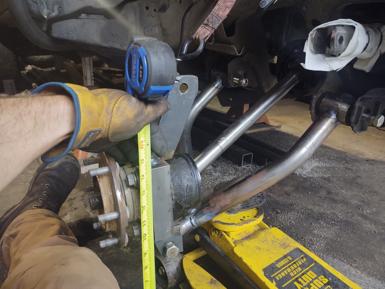

    Let's try that again actually measuring CV angle.
    Looks like just over 15" of usable travel.

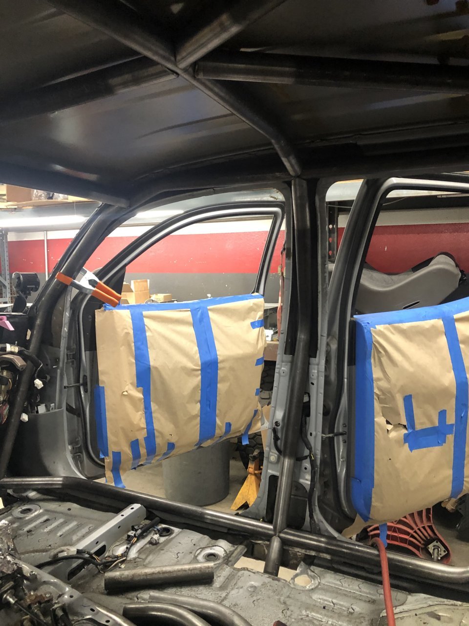

    Time to mount some seats

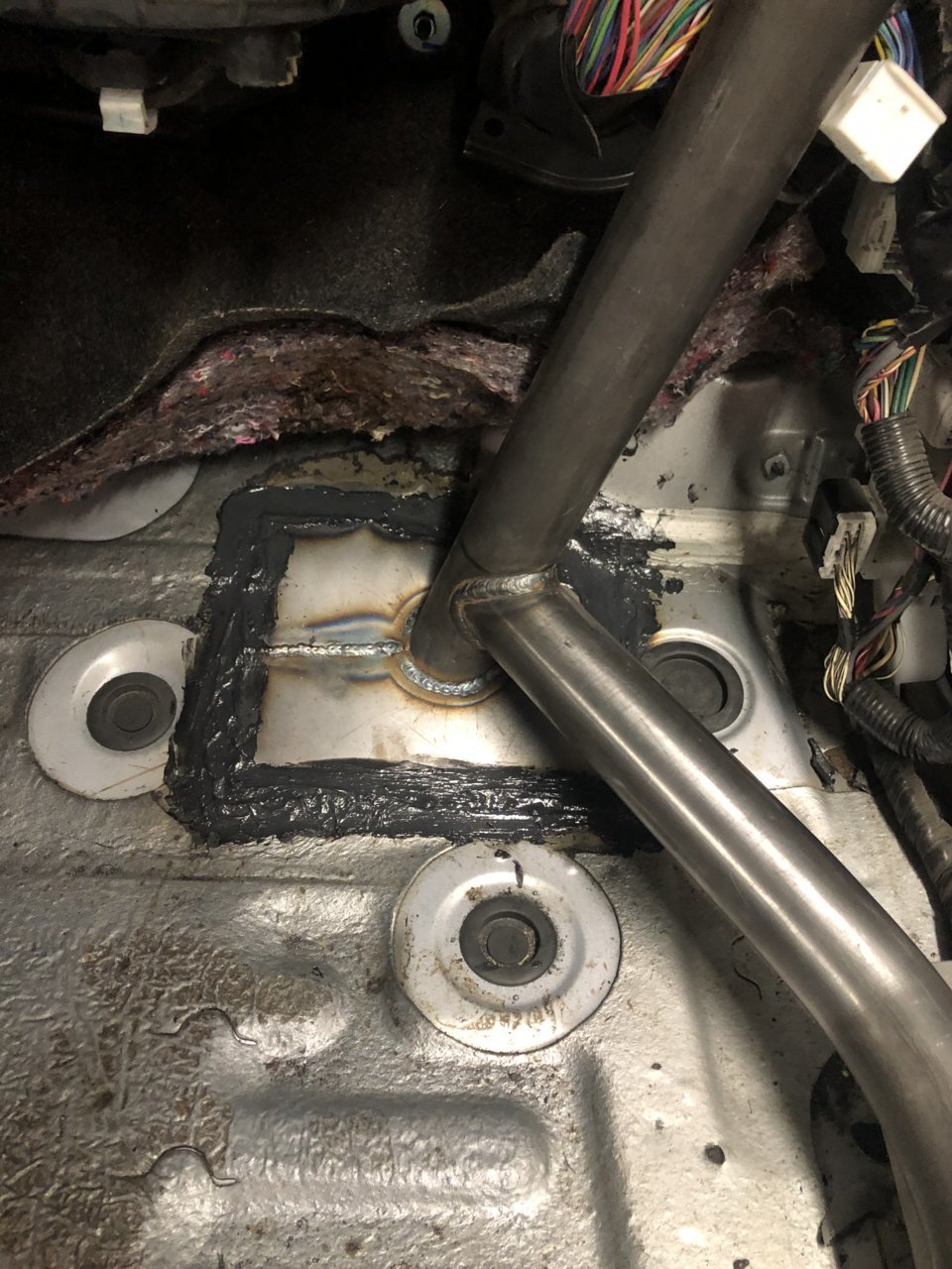

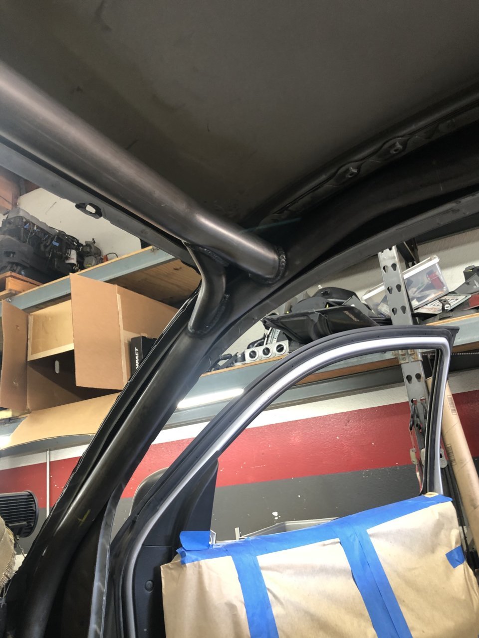

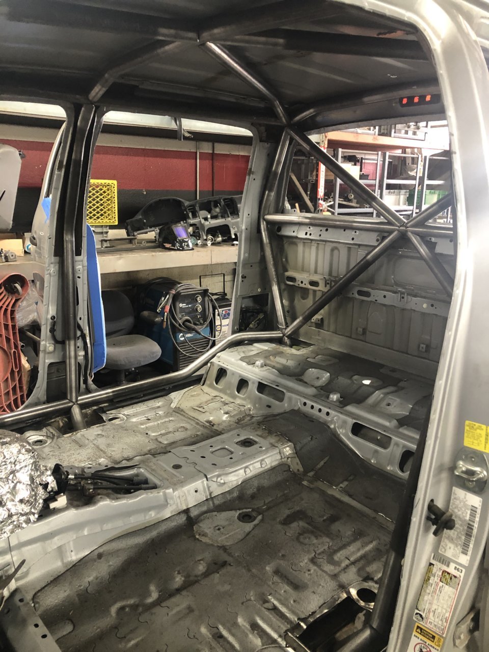

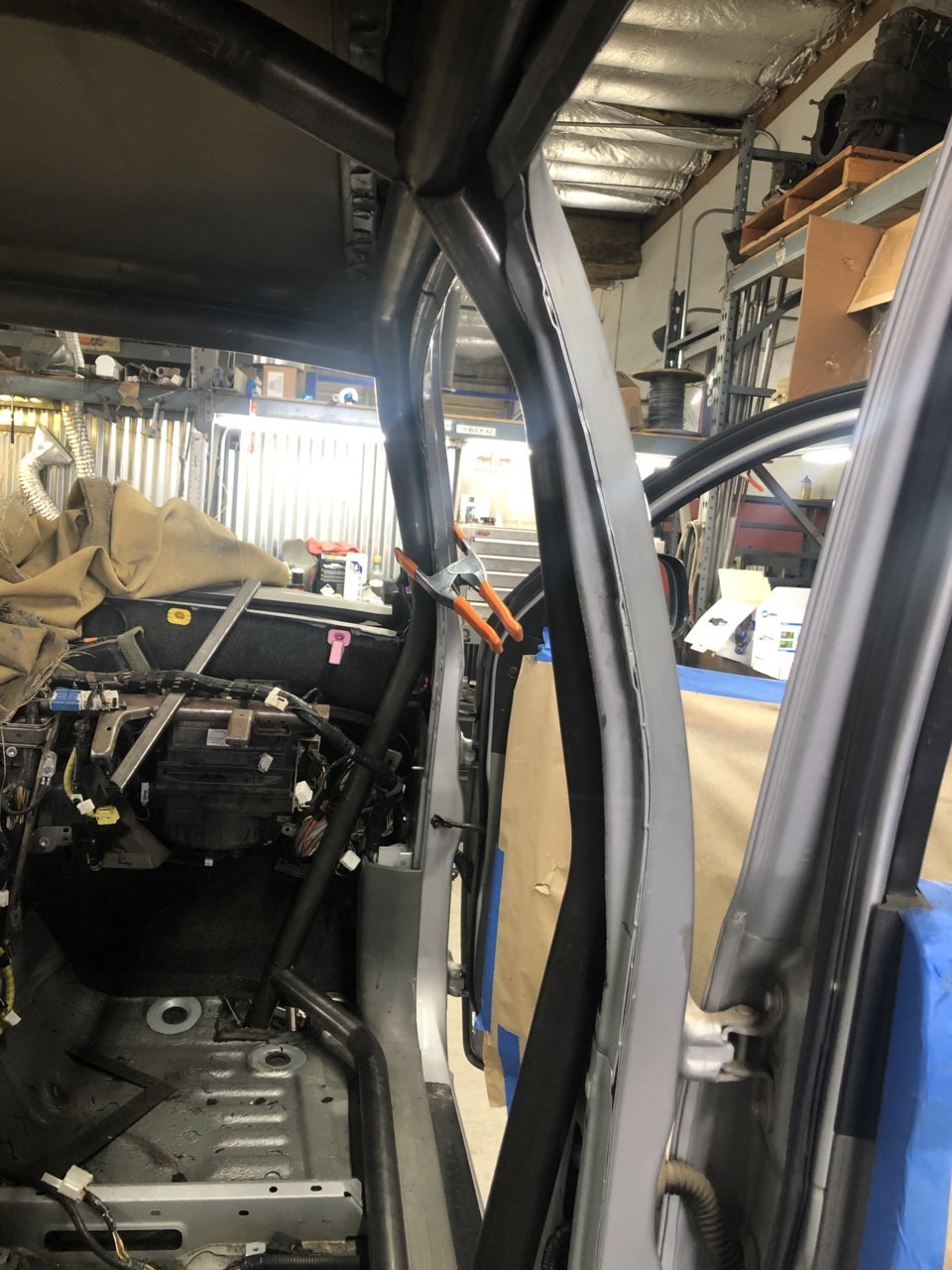

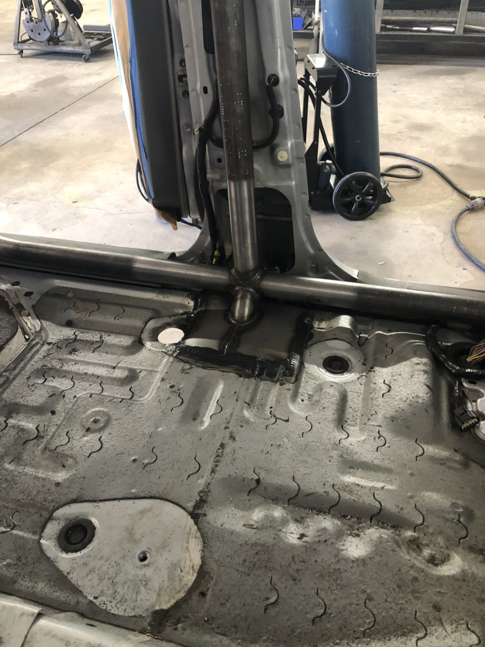

    Got the cage all welded up, floors sealed up and gussets in. Just need to mount the seats and then cover everything in dynamat before interior guy goes nuts

    What do you use for sealing?

    Painting it? No cross bars at B-pillar? How about center of wind shield? What is the scope of the build? Desert Pre-Runner, Rock or trail/overland?

    I weld everything to the floor and then use a 3M seam sealer

    The cage will get painted with steel-it before the interior gets done. Nothing in the windshield and there will be a tube at the b pillar behind the seats... need to get them mounted before that tube goes in.
    Truck is just a toy that can do it all and have the AC on and windows up the whole time
