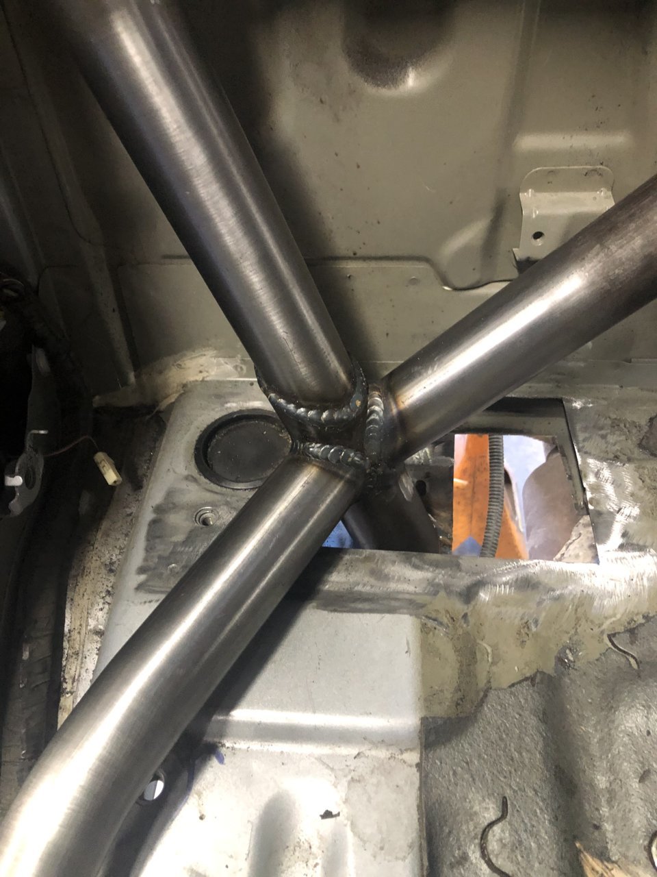

    When welding a really tight fitting cage such as this, can you comment on what is done on the backside/underside of some of the joints? I mean it isn't like you can strategically shift things around to weld the backside first as it goes together. Even with a mirror, or the angle of the MIG tip, or also using a TIG torch, there hast to be inaccessible sections. Even on the tubes that go to the frame, seems reasonable that they may not be weldable all 360 degrees? My only reasonable assumption is that those places don't get welded and the fact that they are all mostly welded makes it strong enough. Any comment from you more knowledgeable folks?
    It sure looks good. I'm not in any way suggesting it wasn't done right. Just asking out of curiosity

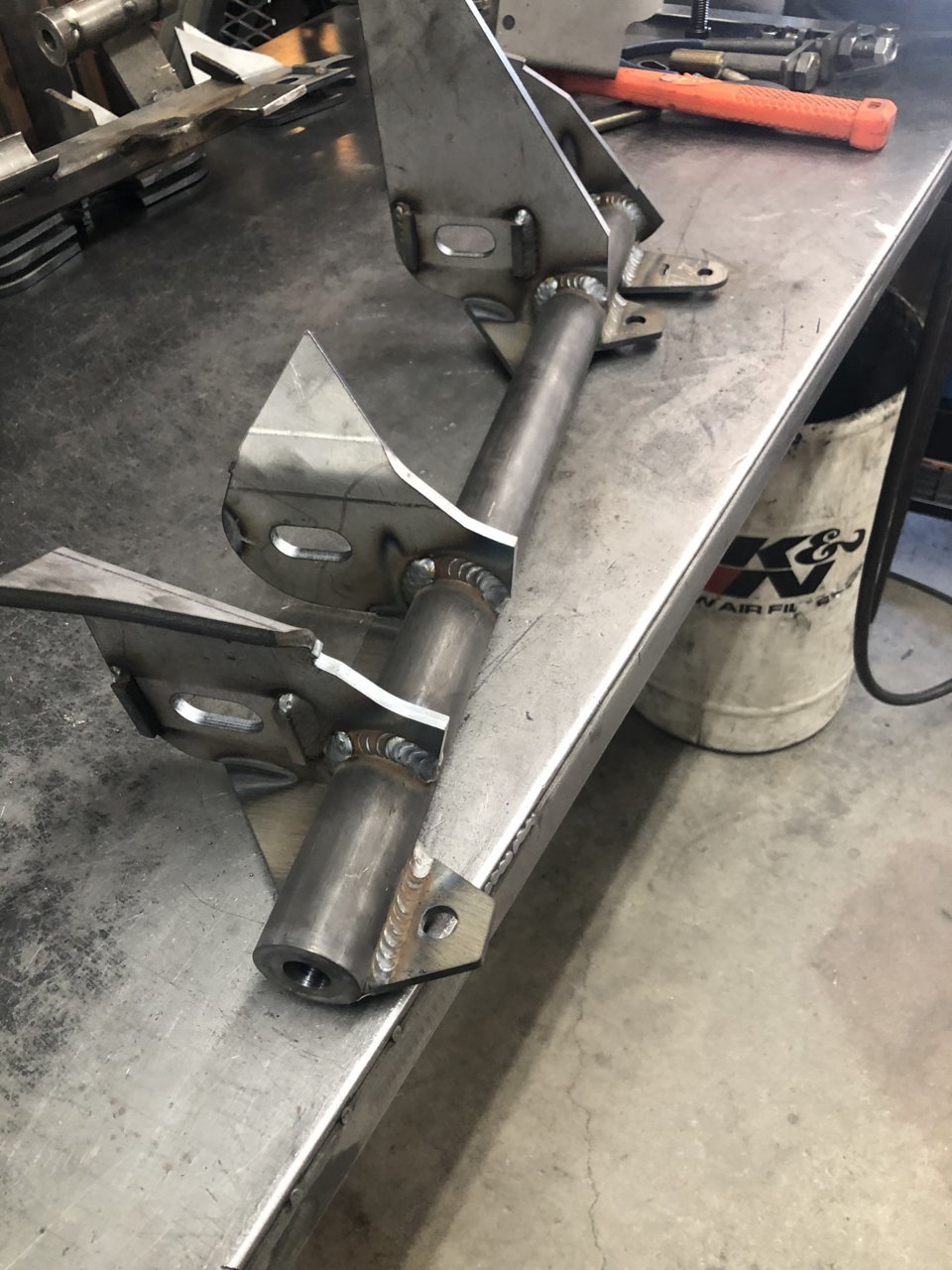

    Worlds first 3rd Gen LCA kit! Doing the first install for a forum member in the next week or so. The tab gussets have also been shortened up so the don’t interfere with Total Chaos arms

    Back when I did a couple of cages, we would lower the cage in the vehicle before it was welded to the rails below. This would allow for complete 360 welds with good quality. Then jack it back up and finish the structure below.

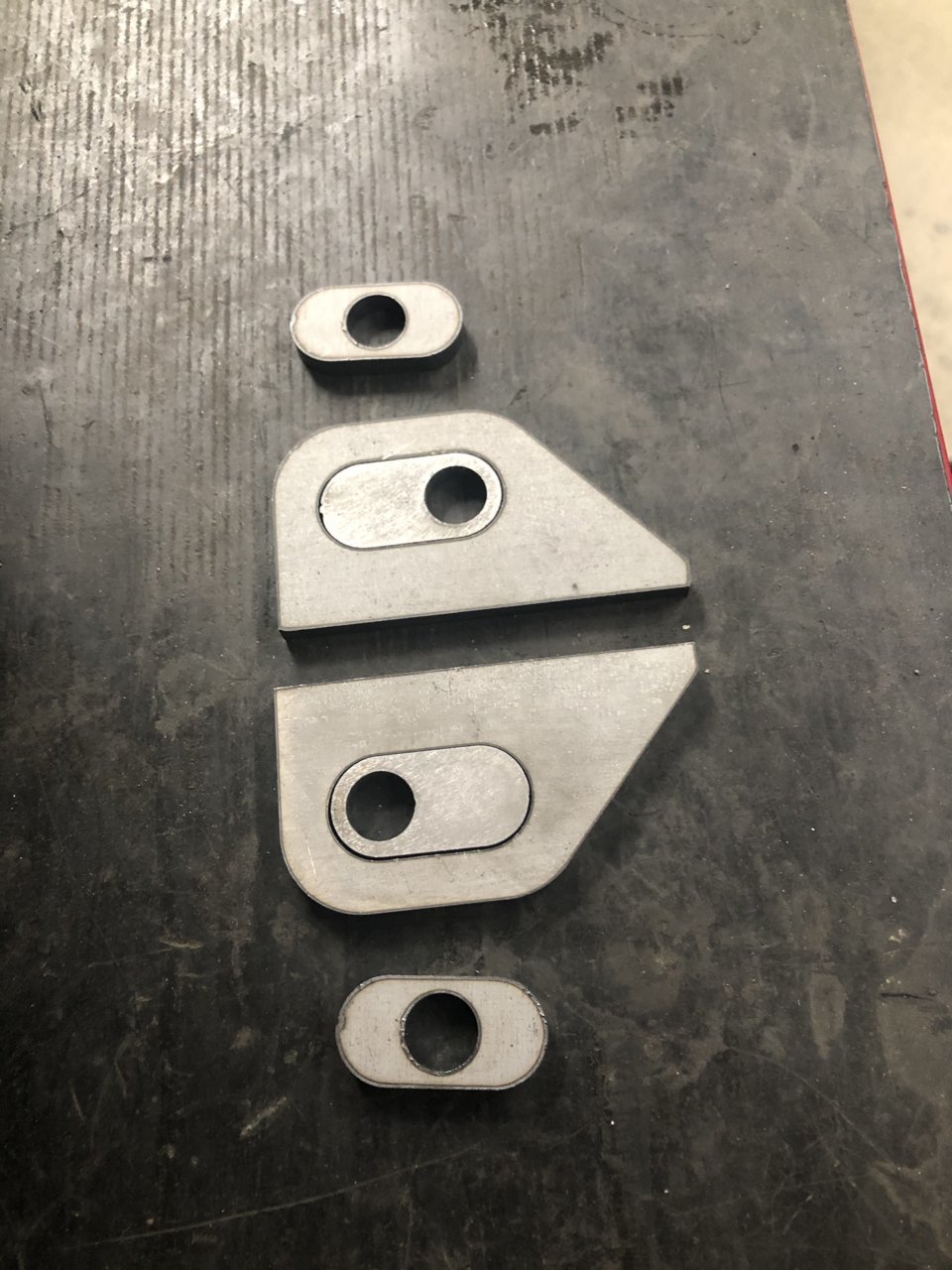

    We also just got a batch of 1/4” limit strap tabs with flip chips!

    The secret to being able to weld everything almost 100% is the 2” over sleeve in the rear. This allows me to drop the cage down 2” in the rear and weld everything up. Once it’s welded the cage is pushed back tight against the roof and the over sleeve is welded.

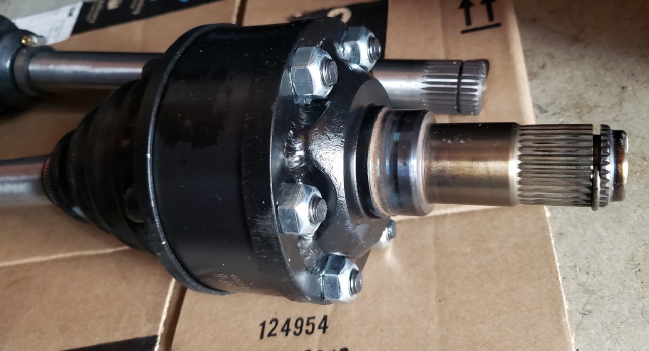

    @81Trekker You guys are killin' it. Many thanks for going above and beyond, sharing your build, and taking time to explain it.
    Can't wait to get my axles on!!
