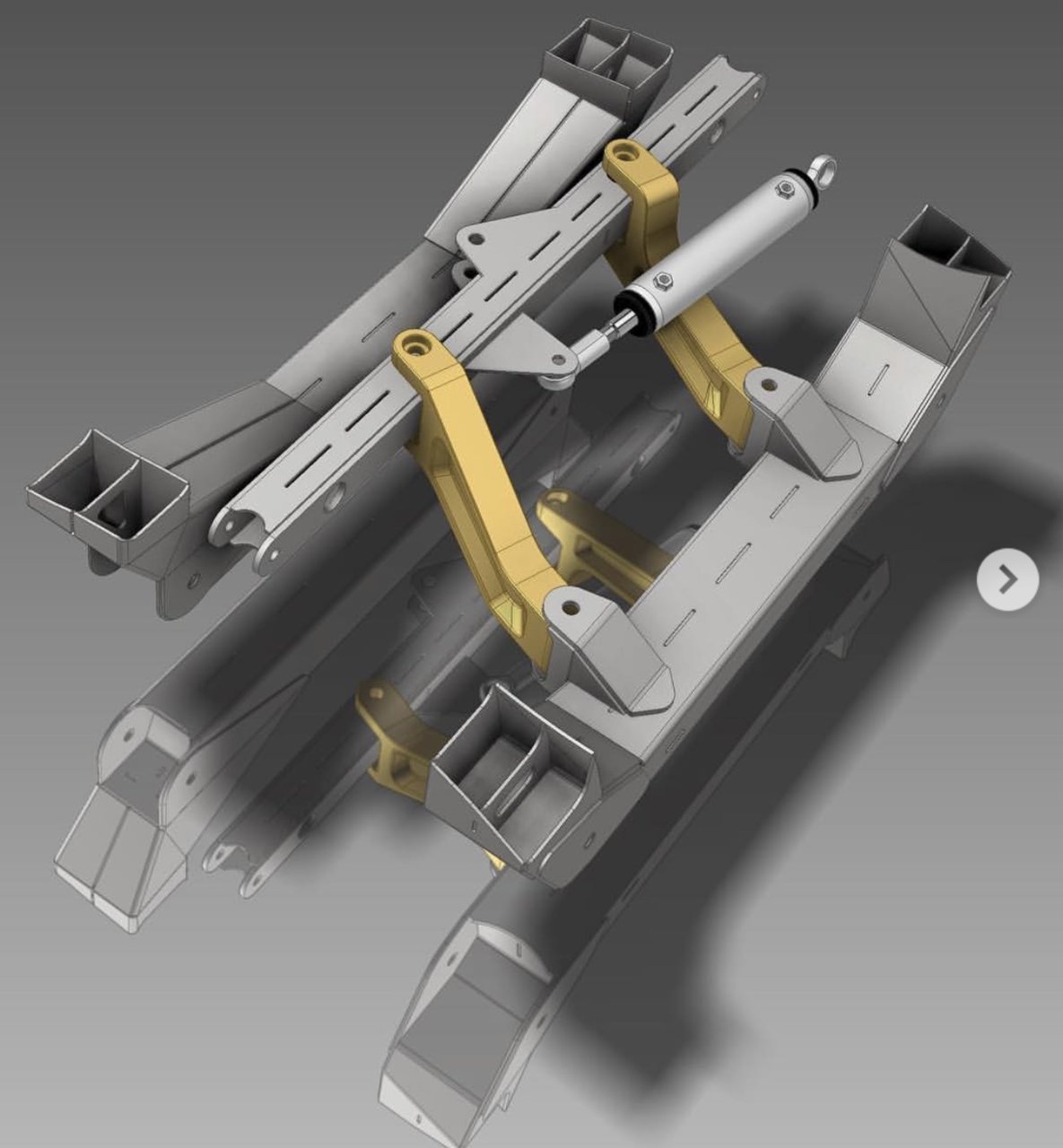

    This is a rendering of the style I’m talking about... very common on luxury prerunners that need the strength of a Howe TT rack but want the feel of a steering box. The swingers can either be parallel or vertical depending on the setup

    I'm going to build new arms this winter (gods willing and the creek don't rise (or my wife decides it's time for another home improvement project)). Relocating the pockets is interesting, but the second order effects become a major headache. Front half the truck at that point and get rid of all the other road-oriented stuff toyota designed in.

    Tundra rack from either @Basikbiker or Solo Motor Sports are really the only game in town. Other than a howe setup or something like what you show up-thread, and I don't know of anyone doing either in the wild. There isn't much room in there, and the Tundra rack solves most of the issues. Add hiemed tie rods and the rest are solved too.

    Relocating the pockets is easier than it sounds and the geometry will be much improved

    If you relocate the upper pockets and make new upper arms to eliminate the anti dive geometry it will help clearance a bunch at full bump

    The upper mounts stay the same, the revised geometry is built into the arm. The lower pockets are relocated to improve clearance and geometry. I’m also trying to reduce the amount of positive camber when turning to help the truck feel more planted

    I'm going to do a new LCA to push the hub forward 1", new UCA to make the caster not suck, engine bay cage to support the UCA mounts, upper shock mounts, and hydro-bumps off the UCA.

    With the UCA mounting points on an angle how do you change the arm to eliminate the anti-dive?

    The antidive cant be fixed thru the arm it has to be the upper mount to fix that...and you want the tires to "lean" into the turn....not turn like if it was a castor wheel.... and that is affected mostly with your KPI which is the relation between the upper and lower spindle pivot and that relative angle in relation to the contact patch of the tire
