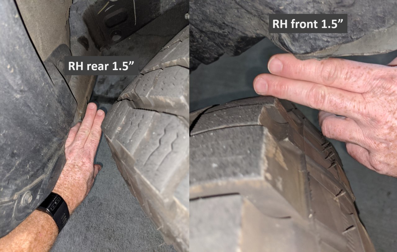

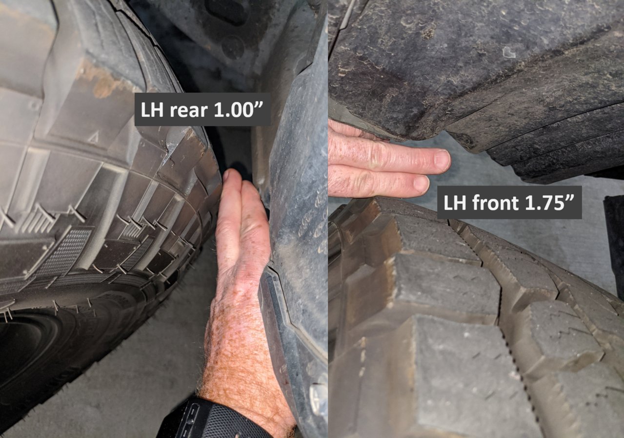

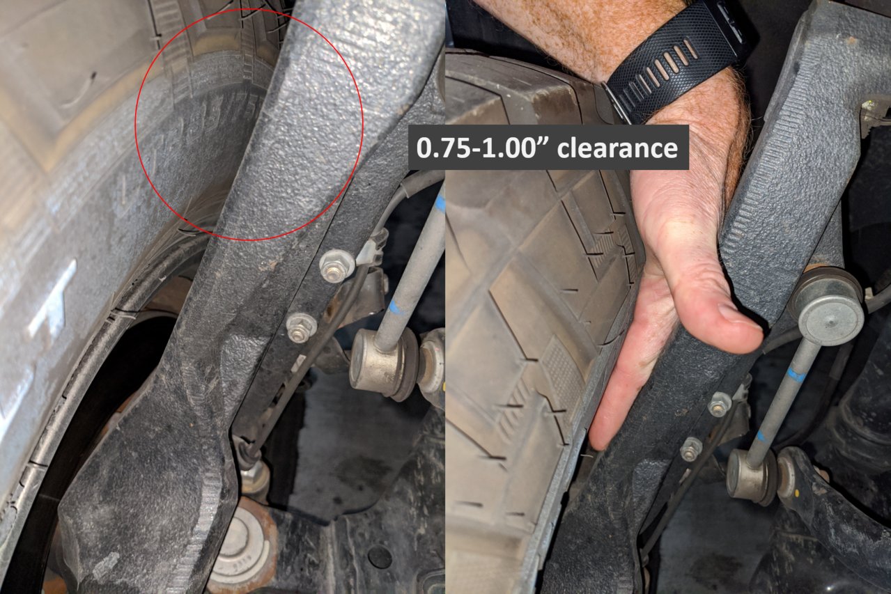

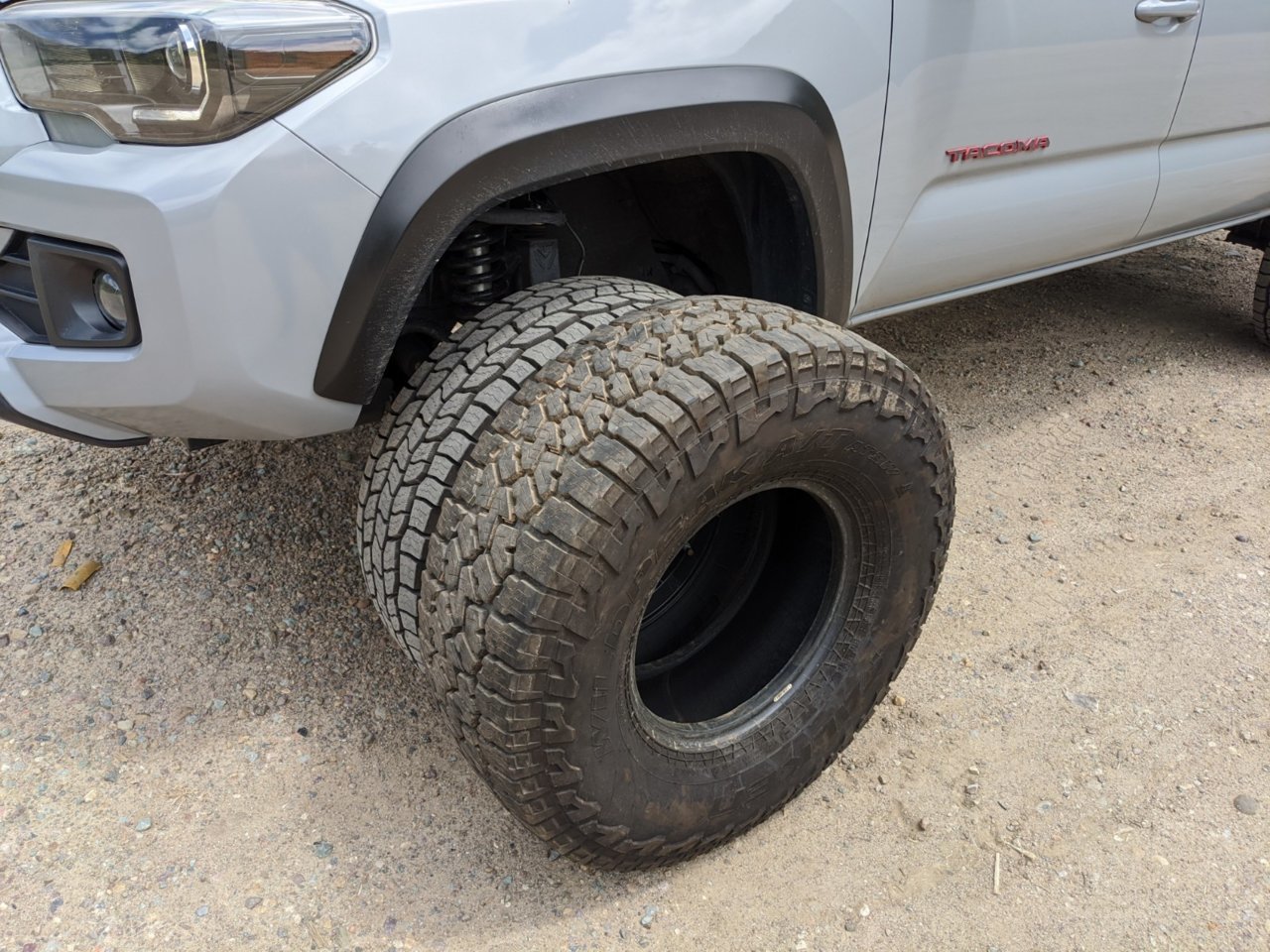

    Backstory. I am in shelter in place and working from home. I have Internet access which includes access to Craigslist. About 3 days ago, some basically new 315/75R16 Falken Wildpeak AT3s came up for $100/ea. The guy bought them for his Chevy 3500 and they wouldn't fit without a leveling kit which he didn't want to do. I had no intention of going to 35s, but out of curiosity and for something to do, I bought the tires (using appropriate social distancing transaction of course). There is no reason to do this besides the fact it will be fun, it will probably look really cool and I can resell the tires for what I paid if I can't make it work.
    Full disclosure, my truck is a RWD TRD Offroad. It has front 4" spindles with the 5100s and stock springs up one notch from bottom (.65"), so around 4.5" front. Rear has add-a-leafs for around 2.5" rear. Wheels are 16x8 -1mm and current tires are Cooper Discoverer 285/75R16 atr3 XLT. The tires can fully cycle with no rubbing anywhere. The front fenders and inner liners have already been well trimmed when I was running a wheel with a -30mm offset.
    First think I thought was, damn these are big.
    On paper, here are the specs between tires:
    Cooper Discoverer AT3 XLT 285/75R16- 32.56" OD, 11.6" width on 8" rim
    Falken Wildpeak AT3 315/75R16- 34.6" OD, 12.3" width on 8" rim
    So, the new tire's radius is +1" and the width is .7" (.35" more on each side from centerline).
    I measured clearances. It looks like I will only get rubbing on the LH cab mount.

    On 4.5" of lift you'll rub minimally while street driving, I would assume. Are you on stock UCAs?

    Stock UCAs, yes. I do want travel for light offroading though, so I will have to do some more trimming and possibly CMC. You can see that the spindles remove any UCA clearance issues.

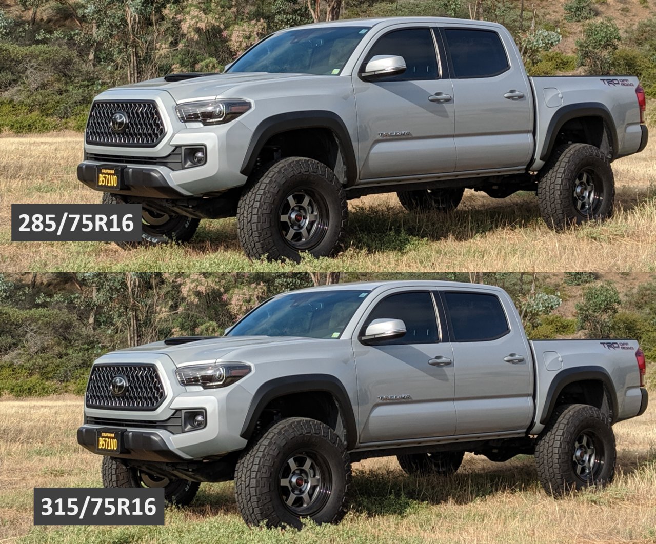

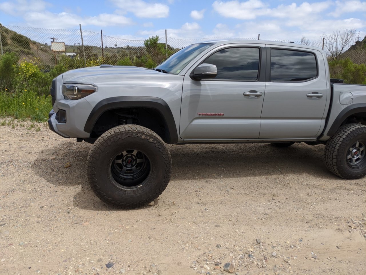

    I chopped the 35s on there. I think proportionally it will be spot on with the lift. The 33s looked a hair small with the 4.5"
