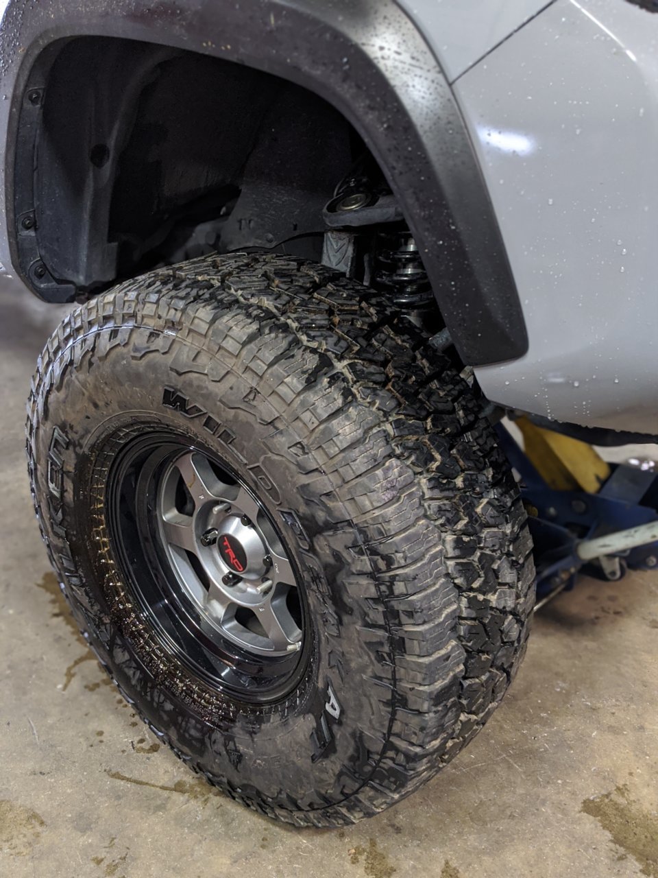

    You're going to have issues off pavement when aired down. You need wheels with more backspacing. What’s the backspace on your current setup?

    How? The tire isn’t going to compress at the top near the spindle when aired down unless im missing something. On or off road, the tire will not be any closer to the spindle. Airing down will only increase the width on the bottom of the tire, so how would that contact the spindle up top?

    Under articulation and offcamber the side roll of the tire can cause the upper part to shift also. 1/2” isn’t enough clearance. I speak from experience.
