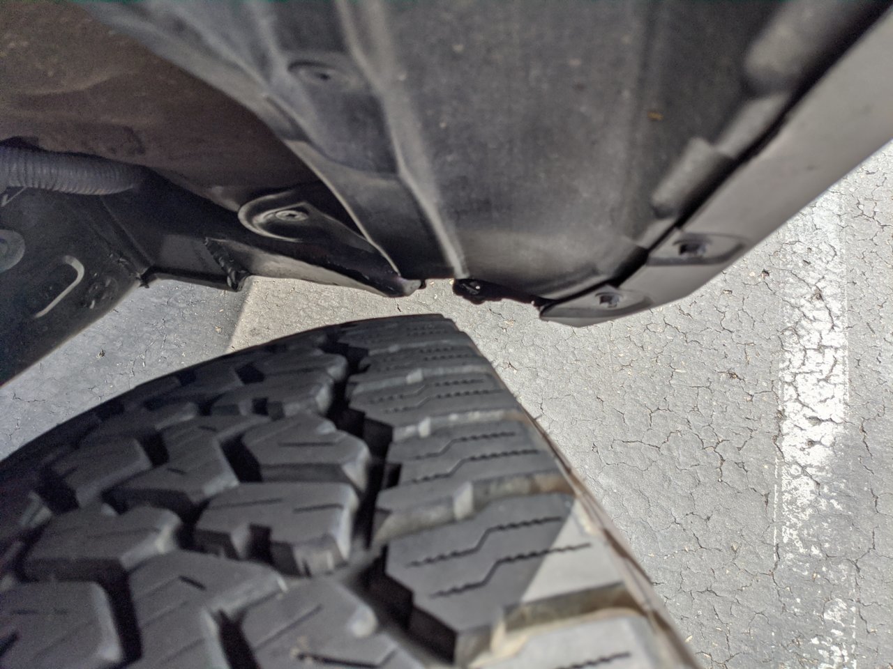

  14. Jun 25, 2020 at 7:07 PM
    #114
    dal3_gribble
    dal3_gribble [OP] Well-Known Member
    Apr 14, 2018
    #250494
    1,202
    Crew Cab SB TRD Offroad
    Hey guys, fyi, this is what 1 additional degree of positive caster does for tire clearance from the cab mount. It was contacting here before out of an angled driveway hard. 1 degree forward caster push on LCA bought about .5" clearance.

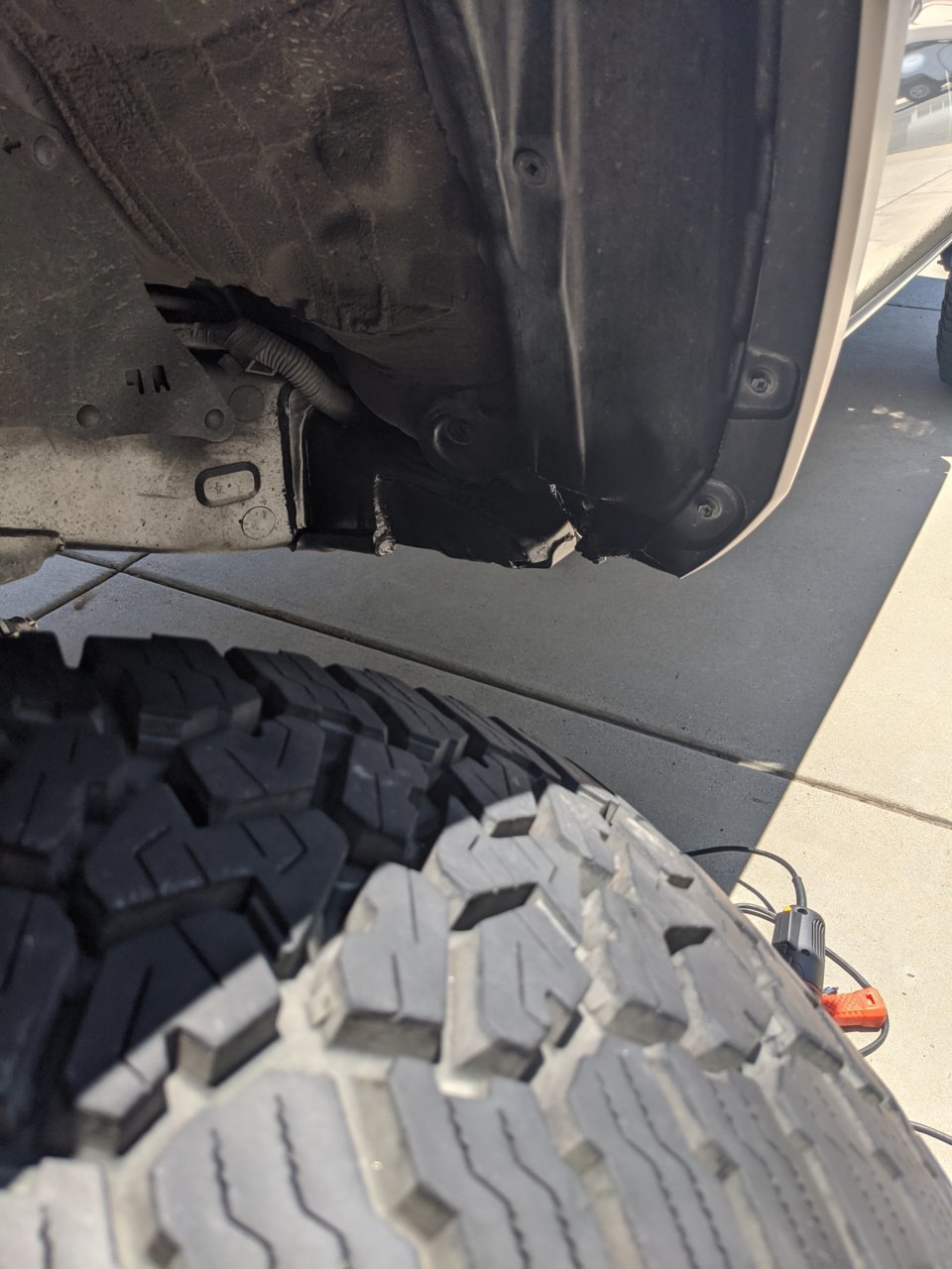

  15. Jul 19, 2020 at 1:05 PM
    #115
    dal3_gribble
    Apr 14, 2018
    #250494
    1,202
    For anyone going to 35s, just fyi this will be your life for a while. Cut. Rub. Cut more. Rub. Cut more. Rub. Hammer pinch weld. Fingers crossed now.

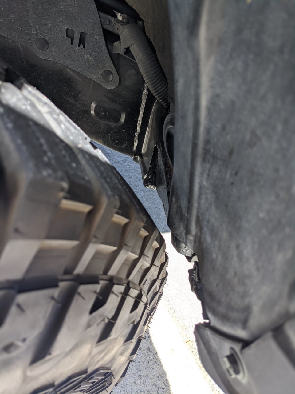

  16. Jul 19, 2020 at 4:47 PM
    #116
    Ol'gray mare
    Ol'gray mare Well-Known Member
    May 13, 2019
    #293171
    427
    West, Tx
    2017 MGM DCLB TRD OR Geared, locked and tuned, rear disc brakes. 2018 TRD PRO White boss' bone stock
    Build thread coming soon.
    Can you get a picture with that same tire turning to the left?
