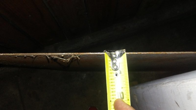

    Good thickness for the tub?

    Most people have used 14 - 20 gauge.

    Neighbor gave it to me. Have no idea what size it is...lol...noob, i know

    Still dont get it...haha..i think its about 1/16

    If that's true it's around 16 gauge according to that chart. Plenty thick, but will be harder to form into the firewall compared to 20 gauge. And it looks like Monte didn't opt to use that thickness for that reason, and he knows his shit better than me. :p
