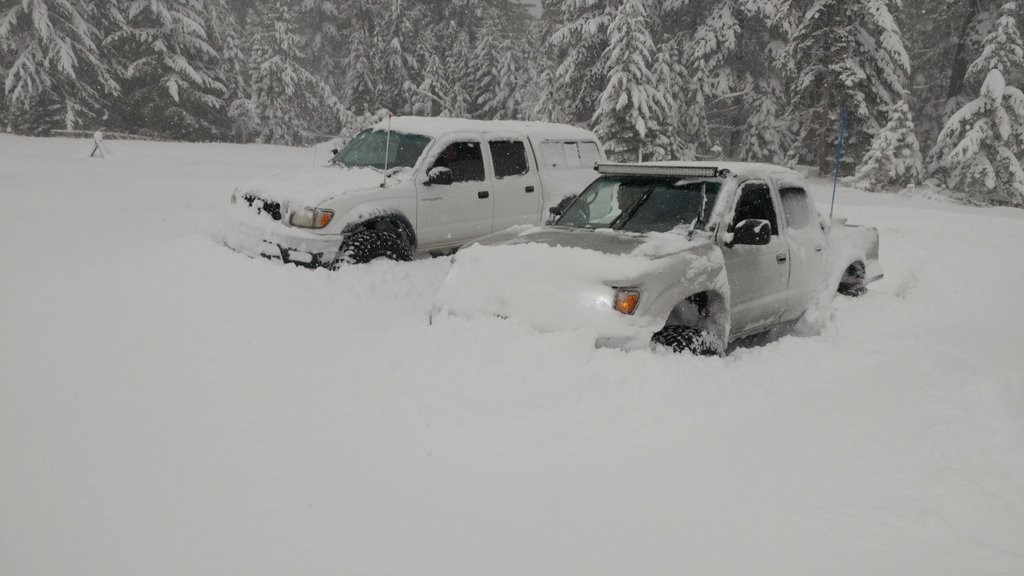

    2003 tacoma double cab, prerunner, 4wd conversion, 5 speed conversion, dual cases with inchworm clockable adapter, toytec ultimate coil overs, trd supercharger with urd 7th injector, 37 inch mastercraft mxt's, arb front locker
    silver tacoma is on 35s and the white one is on 37s. silver tacoma has since lost the fiberglass fenders
    Yetimetchkangmi and Dalandser like this.

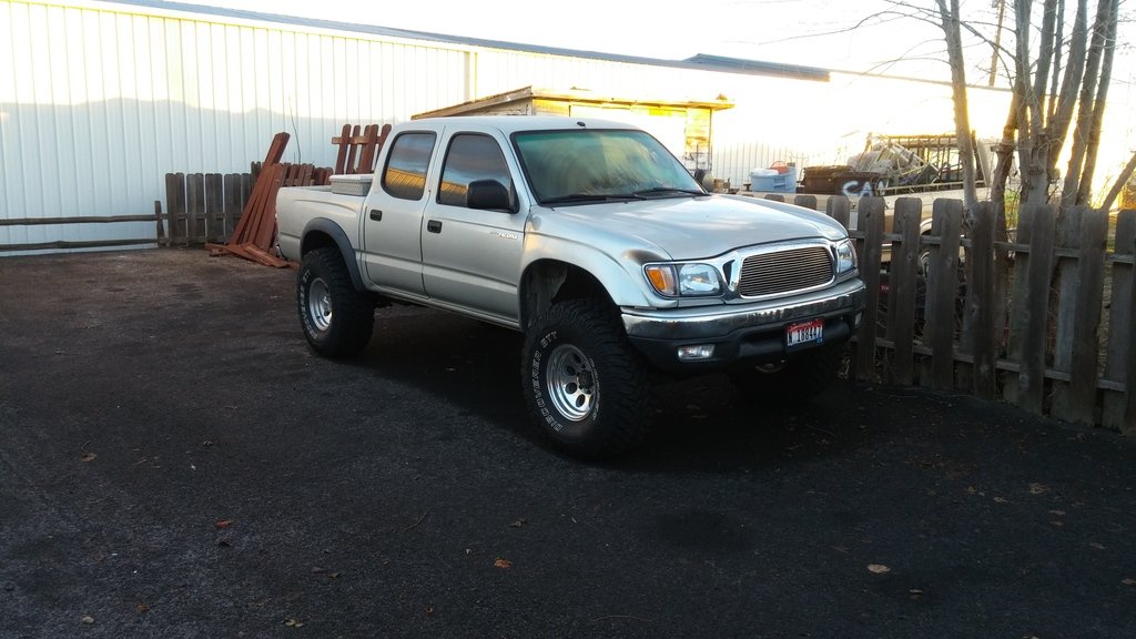

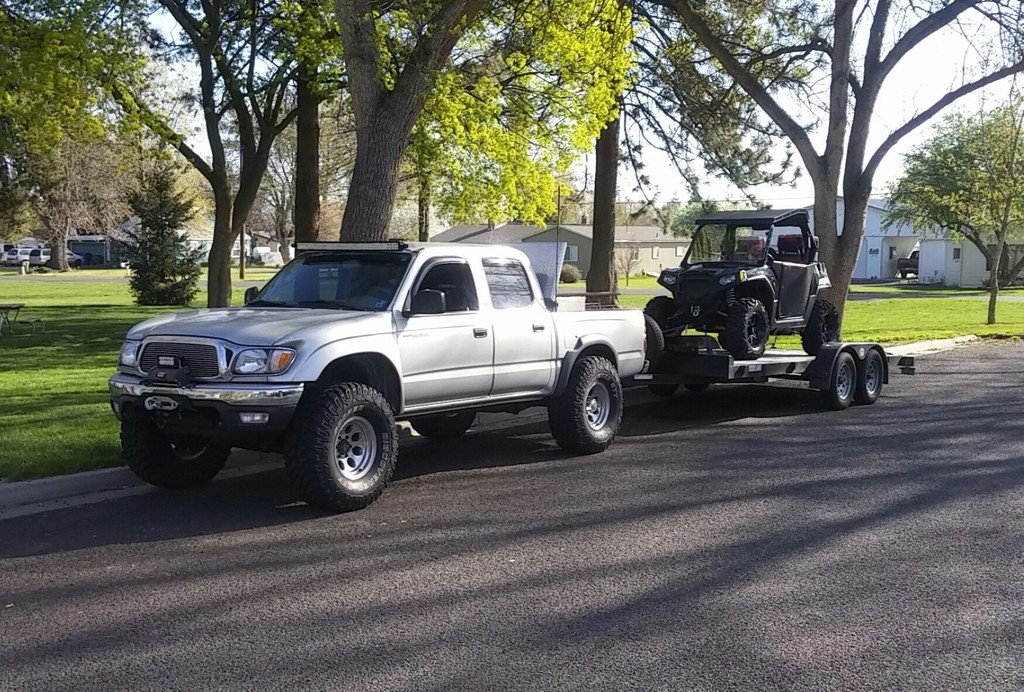

    Ask and you shall receive
    Pre body lift
    Snapchat-25284407923023872382_zps4lkatos_68aa801e1822252c692ac0917070f5358940ea5c.jpg
    After body lift
    Also did some firewall trimming after the body lift, before it was just massaged with a sledge
    Dalandser and DustStorm4x4 like this.

    How the hell did he turn with just a "massaged" firewall?

    a airhammer and sledge can do a lot of work. didnt solve all the rubbing, but with 15x8 wheels and -27 offset it was really only at full lock when it would.

    I never needed to modify any of that. Only needed to bash under the fender with a sledge. The front should have no rubbing, typically it's only peoples bumpers that need to be cut.
