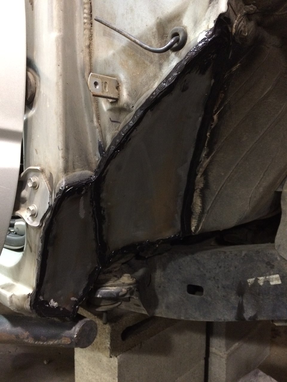

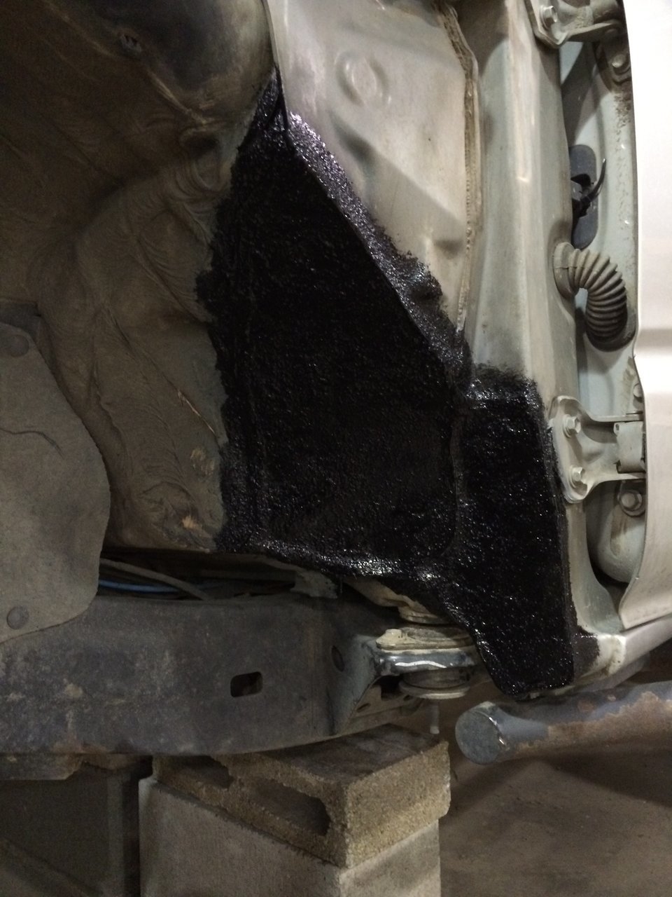

    What did you guys use to seal your truck from water?
  13. Jan 11, 2018 at 11:03 AM
    #313
    jubei
    jubei would rather be doing something else
    Mar 17, 2016
    #181549
    6,062
    Jason
    NoCo
    White 2002 XC TRD and Yellow 1971 JEEP CJ5
    Stuff. Also things.
    Hell yes, Mike!
    I don’t, but I have been for a few weeks while I work on my DD. Mileage isn’t great, but I love driving this truck, so it’s all good.
    I did seam sealer along the welds inside and out, and then bed liner outside. I shot Flex Seal over the entire tub plate and past the welds about 2” on the outside as well. So far so good.

    I think ima do a bunch of sealant and that flex seal too

    Ditto, fully welded the tubs and used 3M seam sealer inside and out, then herculiner bed liner over the whole area on the outside. Added extra sound deadening to the inside to cut down on tire noise.

    I learned the hard way the first time that the seam sealer on this inside matters just as much as the outside. I didn't go high enough the first time around and got leaks (I do a fair bit of water crossings too). Inside was 3M automotive seam sealer, then flex seal on top. Outside was the same. Very liberal with both.

    All of that seam sealer gives me flashbacks. That was a messy job.

    Wow that’s a lot. Guess I’ll just need some more sealer. I did some water crossings last week and I had a few water drops but nothing major. But I’d like to keep it all out if possible.

    Lol was awful.
    Do it right or do it twice. It's a shit job, and I had the interior out for vinyl so I went ham.

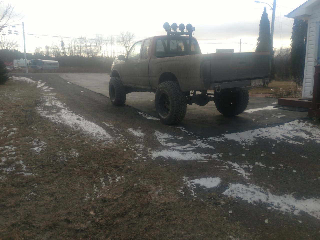

    Forgot to post. 35s!
