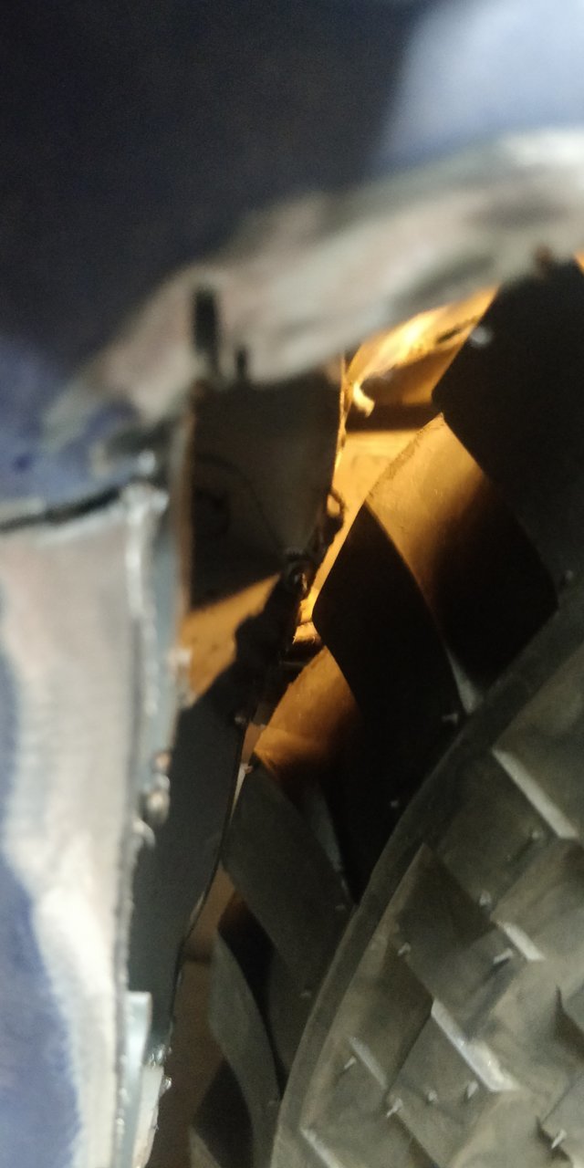

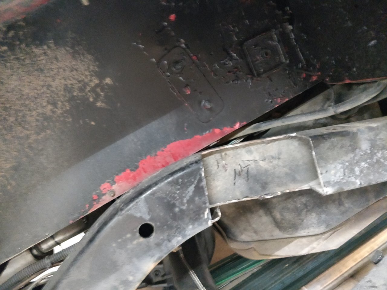

    I am actually only running spacers on the front since the rear doesn't have clearance issues. I double checked and they are actually 1.5"
    I stacked both which gives me 2.83" BS just to check where clearance is at and it looks like I'll have to hack off the entire front bolt of the cab mount: garbage photo but the tire still isn't turned all the way into the frame

    I'll probably make sure the cab tub fits at 2.85" BS and call it good. If I decide to run that wide in the future I'll address the body mount then. I'm not too worried since 17" Procomp steelies, SCS, and Battle born wheels all have 3.5" BS

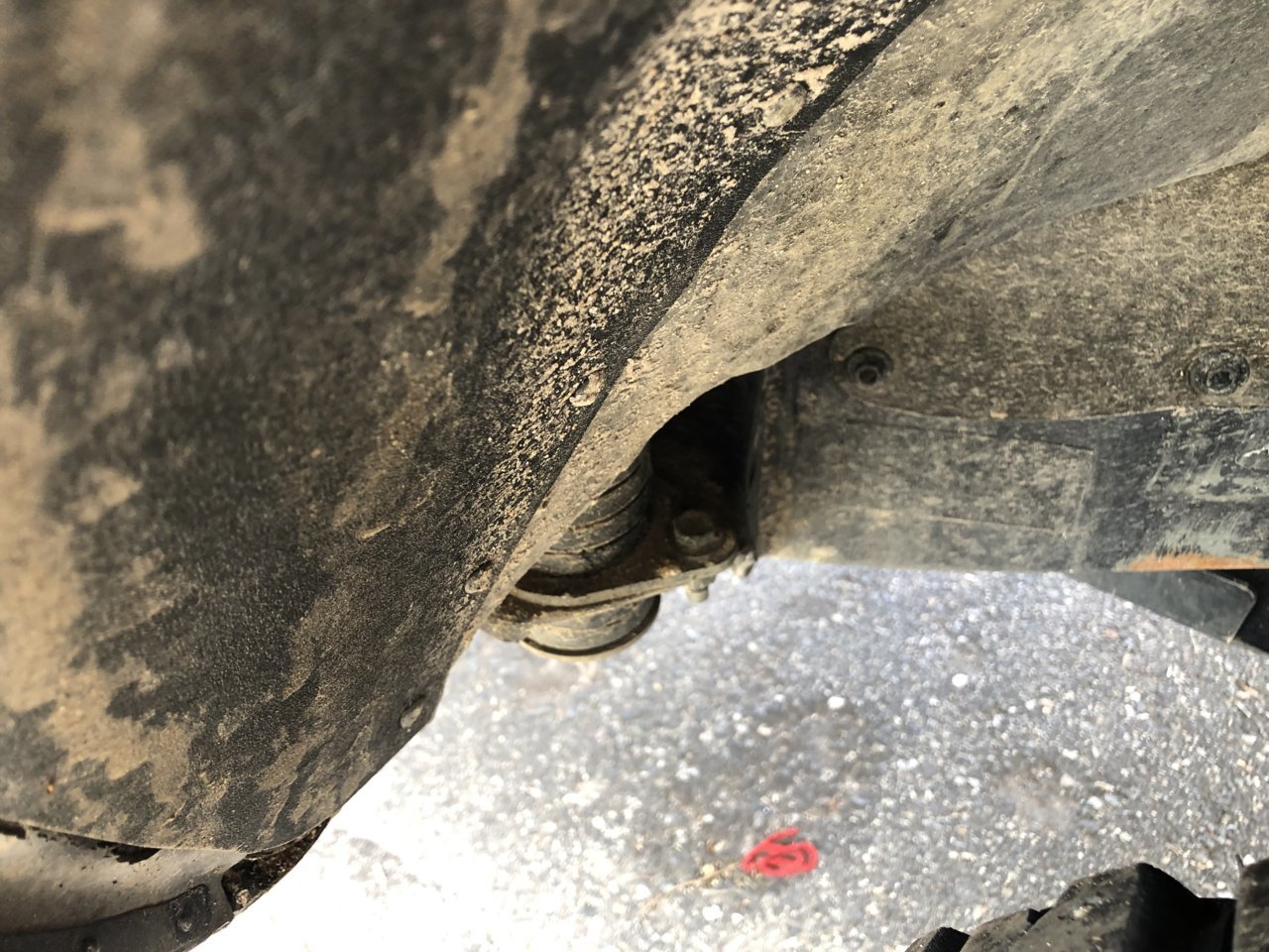

    Jake, this is what I ended up with after shaving the cab mounts on the frame. You can also see where I’m rubbing the frame where the surface rust is showing.

    Oops, forgot to quote/tag you, @Wulf .
    See above.

    Looks like I'm about on par

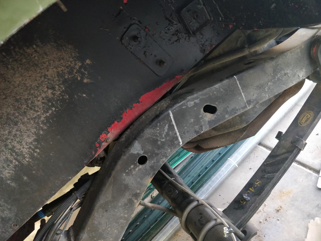

    Has anyone notched the frame to clear the tires? I frenched the frame on a Jeep I had to outboard the rear shocks so it could be feasible to do something similar but obviously not as extreme. It would have to be paired with some extra support welded on the insides of the frame. I'm nervous about the thought though

    Yep, that looks like mine for sure. Just enough material left to clear the washer for the bolt.
    As for frenching the frame, I personally don’t think it’s worth it running IFS, but if you had good access to the inside of the frame, it’s certainly doable.
    Part of the reason I don’t worry about frame rub is that I really go out of my way to avoid doing much at full lock in 4wd. I know it’s unavoidable sometimes, but I also know that that’s when shit usually binds and breaks. On the road, who cares?
