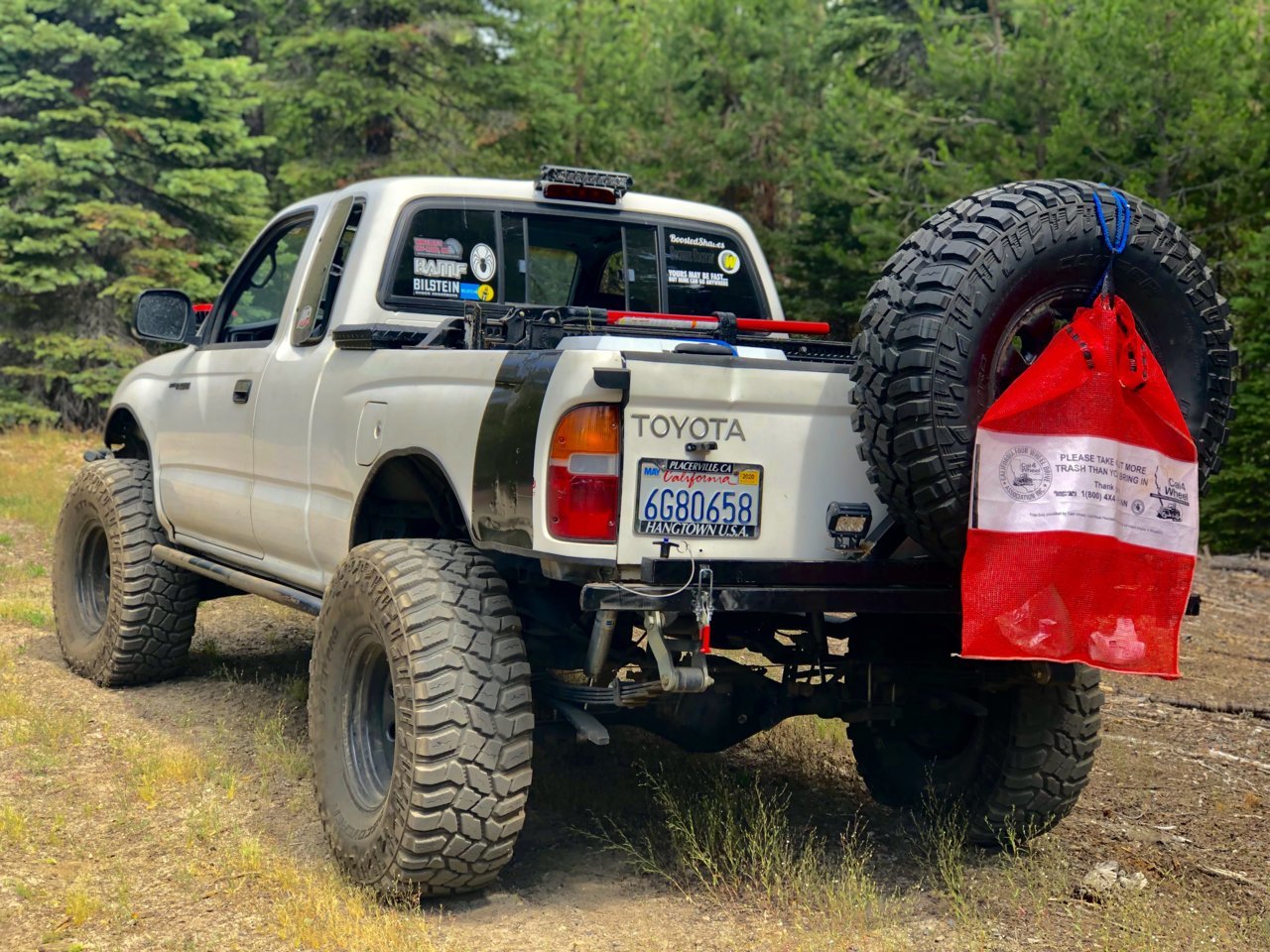

  12. Aug 17, 2019 at 12:00 PM
    #372
    MichaelsTacoma
    MichaelsTacoma Well-Known Member
    Feb 2, 2015
    #147725
    493
    Michael
    Sacramento
    00 TRD 4wd e-locker
    donahoe racing coilovers, Camburg upper control arms, rear bilstein 5100, wheelers leaf pack, wheelers super bumps, 33 inch Cooper discovere stt pros
    35’s with the bobbed bed.
    78D2BDFB-9FBB-476B-8383-3D7B2E999DD2.jpg 0C235025-EAFB-459F-A229-95242123EDD5.jpg
  13. Aug 17, 2019 at 12:54 PM
    #373
    Fernando
    Fernando Hammerdown
    Aug 25, 2012
    #85507
    23,432
    Fernando
    Sacramento
    04 Tacoma DC 4x4
    Too many, See Build
    Dis is sexy
    BeLance89 likes this.
