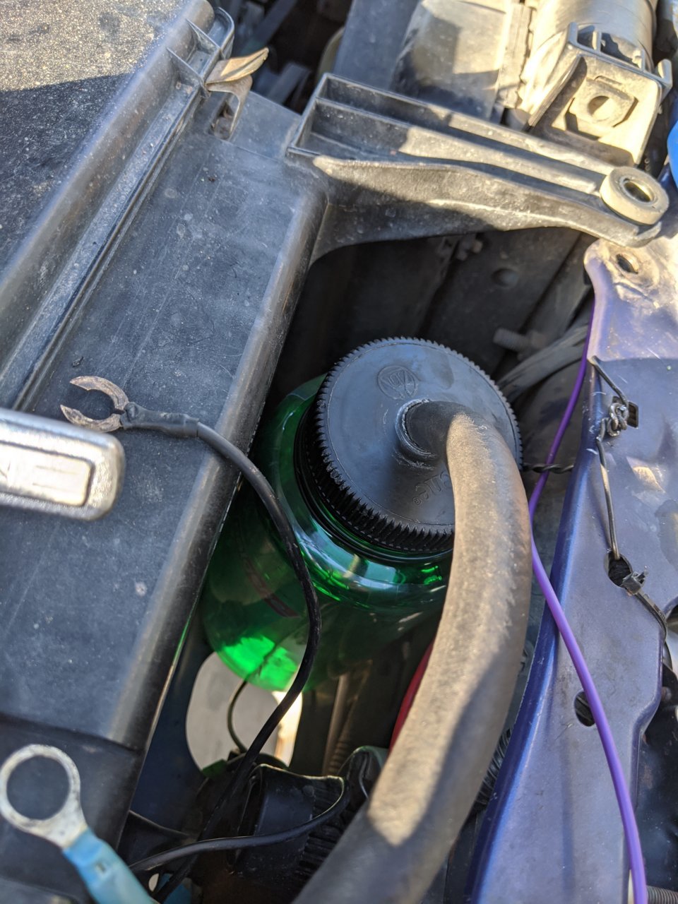

    I fit a nalgene between the air box and the core support. I need to drill the side and put the pump at the bottom like a factory bottle. It doesn't have enough suction to pull from the top when fender mounted

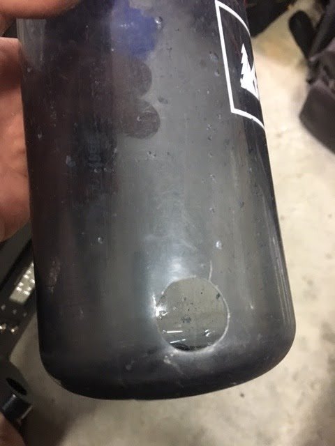

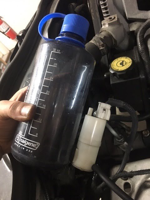

    I got the idea online. You can reuse the factory pump and washer gasket

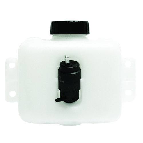

    And +1 to the bottle.
    I like this one because it's like it was made for the space but it's on the flimsier side so getting the gasket perfect is harder after it's aged a bit. It went in perfect though.

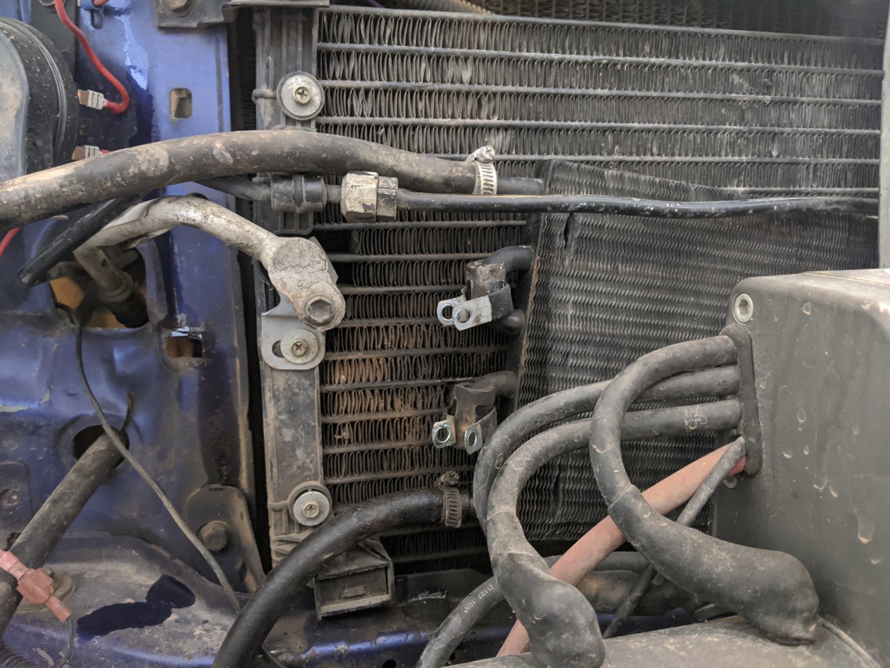

    Now I remember why I mounted the cooler so high. The outlet clearance becomes an issue. Maybe I should get a smaller cooler?
