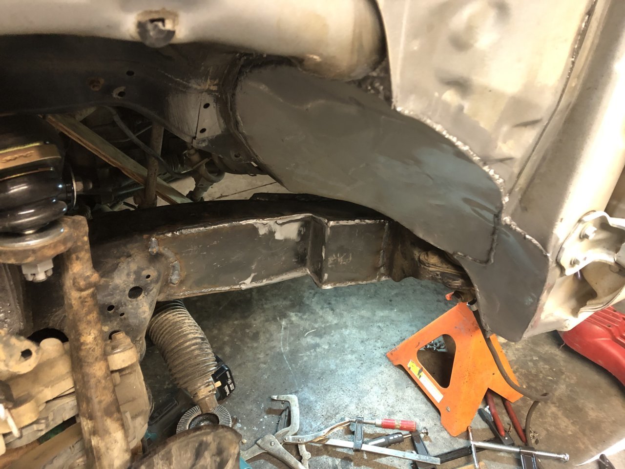

    good lord that is the biggest damn hole I've ever seen haha good job patching it.
    Love the notch job too. I've considered doing that too on my next truck. but was assuming 37s haha

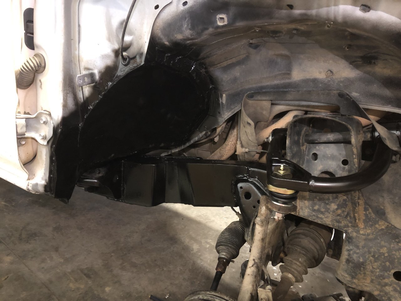

    One side done. Plated the inside of the frame and the bottom with 1/4" and the outside with 3/16". A guy would need to lift the body off to plate the top. I think this will be plenty but Ill just have to watch it and see what happens.

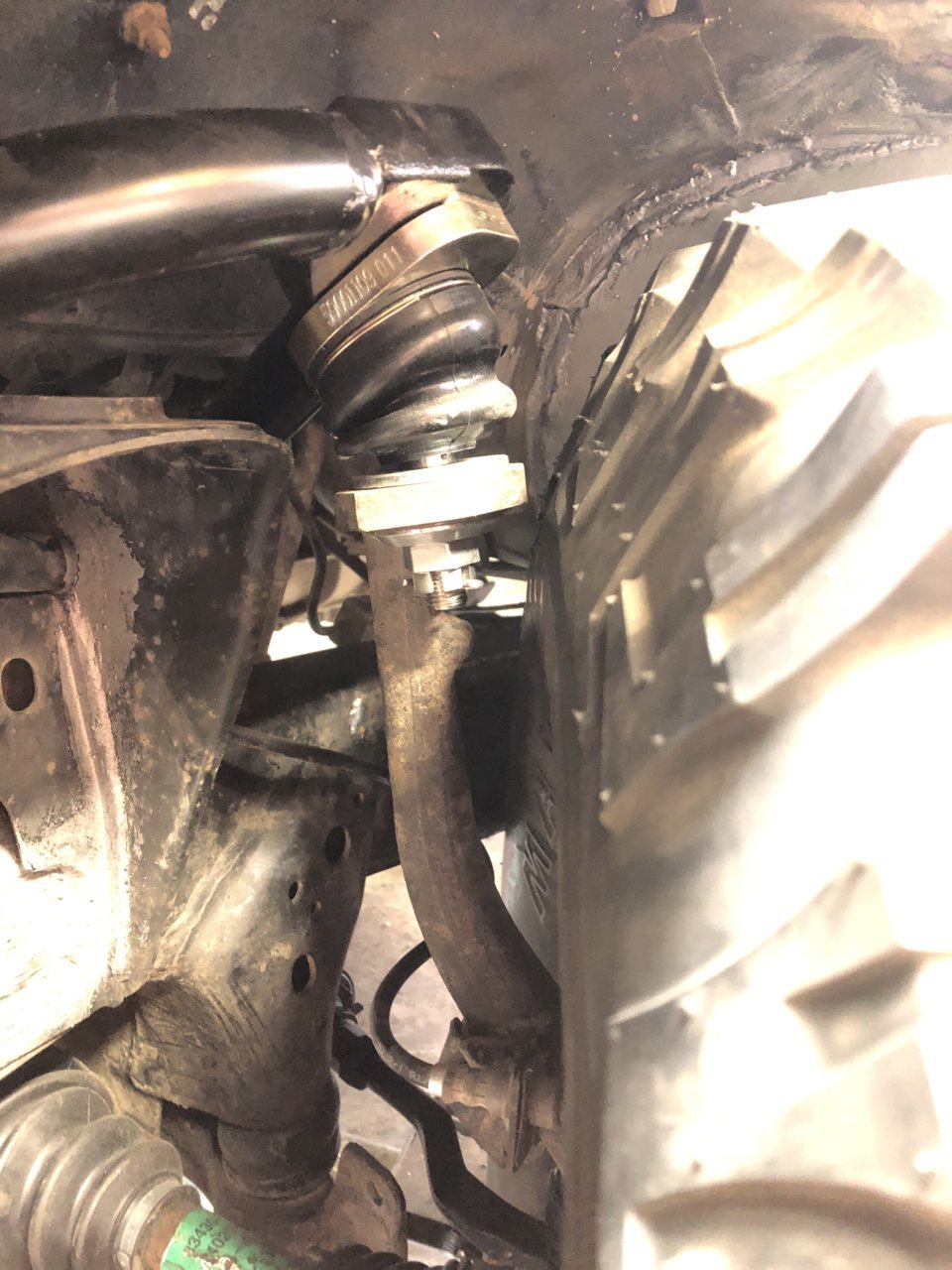

    On her way back together. I had to remove my cross over pipe/exhaust and front drive shaft and Ive also addressed about three years of matienance backlogs during this tear down, so just putting everything back together is time consuming.
    Passenger side.

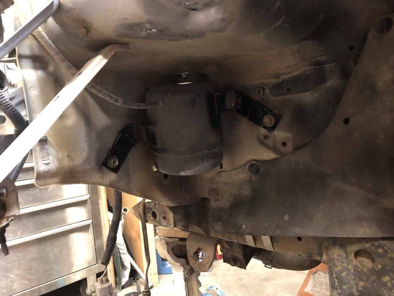

    This is how I addressed to vacuum reservoir, just add wings to the mounts to move it up tight into the corner. A3C5AB86-29AA-4664-BC8F-BFA35DE55BFD.jpg
    And this is my tire to spindle clearance, its not the 3/4" I previously said, closer to 3/8-1/2".

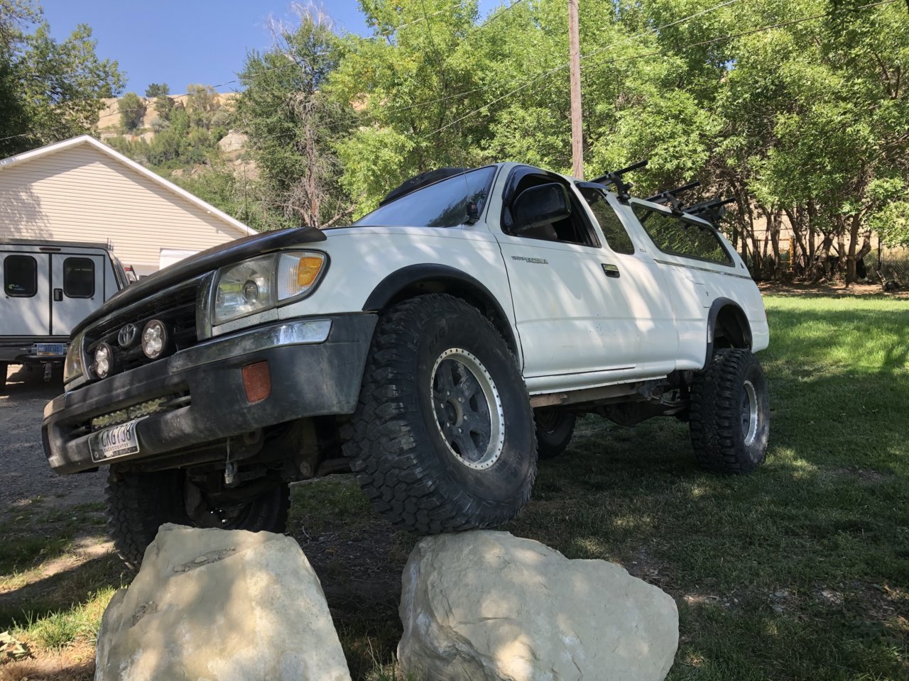

    And she’s back together. Still rub the frame, just barely at full lock. I think less than I did with the 255/85s. There just isn’t enough room to take out any more though. Overall happy with how it came out.
