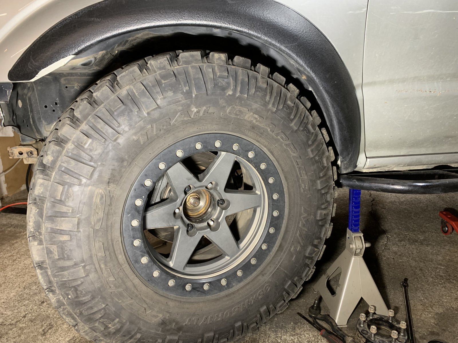

    Thanks man! Fender flares are the original ones that came on the truck. Just trimmed for the tires and recoated with Rust-Oleum bed liner.

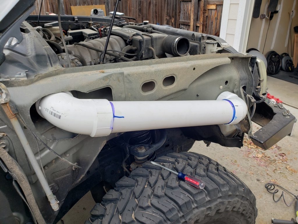

    Any good solutions to avoid burning through air filters without a passenger fender liner?
    Could do a snorkel but I would rather not right now.
    Moved to 35x10.50s and I have them clearing ok for daily driving with a couple hours of cutting and hammering but I’ll have to pull the fender liners and tub before I take it offroad.

    I don't recall going through air filters when the liner was out, but I suppose if you frequent gravel roads it could be an issue. Was far more concerned with water intrusion. You could do an undercover snorkel with PVC or flexible pipe, and have the inlet run under the windshield cowl.
    This is the dorkel I did on my Tundra for reference.

    I ran something similar to this for a long time and it was mint

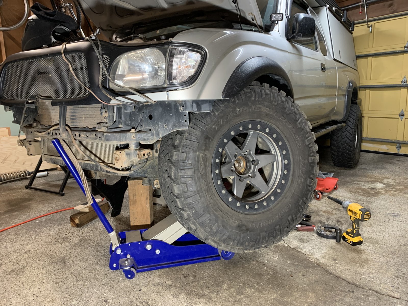

    Yes, I have Nitto trail graps in 35x11.5r17, although I do like the 12.5 wide tires I have to say that 11.5 fits better and works very well.

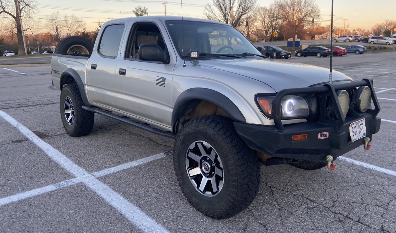

    That looks pretty good! What backspacing and width are you running on the wheels?

    I run x10.5s in front and x12.5s in rear. Fronts still rub frame with 2" spacer on 3rd gen 17" rims

    Thanks! They are 8.5” wide, with 4” BS, and I also have 1” spacers. So 3” total BS, which I can tell you from experience wouldn’t work with 12.5” wide tires but I have no frame rub with the 11.5’s

    Are those pics post-Solo lowers? Curious how much they helped after moving the lower ball joint forward.
