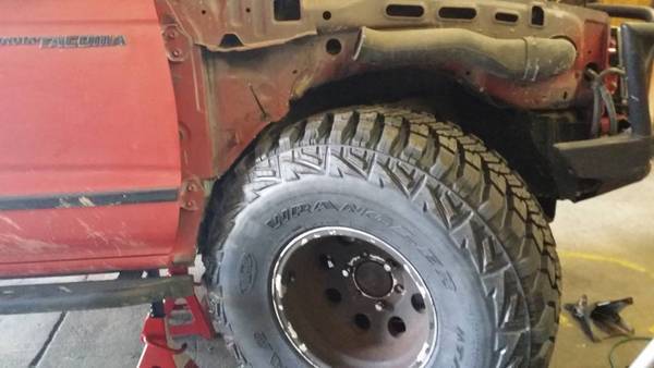

    Joined the 35 club this weekend!!! Now I just need to get the other 4 tires mounted....lol
    Ran out of time Sunday night and didn't want to rush trimming the flares, so I'll take my time on that part this weekend once they're all on.
    One issue that I didn't pick up on is the cab mount. I'm rubbing up against it at full compression and full lock. I'm going to use one of my unlimited alignments to see if they can push the tires forward a hair or two. If not, I'll need to cut a piece of the mount and weld it back further. Only need a 1/4 inch.

    I cut my mounts a bit. Just like the 2nd gen cab chop mount.

    Good to know. Thanks Monte

    Yea you don't have to relocate it or anything. Just chop that face a bit

    Exactly, I chopped my mount off just in front of the forward bolt. It clears fine..

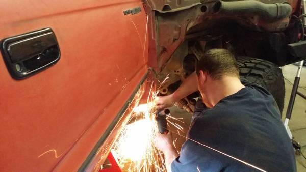

    So when you cut your fenders to clearance for tires how do you keep your fender paint from chipping off after you cut them?

    I taped off a 1/4" line following the arch and hit it with rocker gaurd from a rattle can. Hasent chipped yet and looks pretty good.

    Rotation of the cut off wheel is important. You want it cutting into the paint not pulling it. I didn't repaint anything cause I didn't have too.
