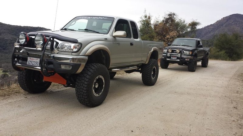

    1. MTR's are super quiet and ride a lot better when compared to my previous Firestone MT's
    2. Lost about 1.5mpg's......I drive about 200 miles per week and this is acceptable to me
    3. Stock gearing is only a little less useful than my 33's, lol. I do find myself using my twin stick more off the line though. Looking forward to getting the crawlbox installed
    4. Had to cut a lot of my Bushwackers off to avoid rubbing when compressed
    5. Wish I could fit 42's under the fender :D
