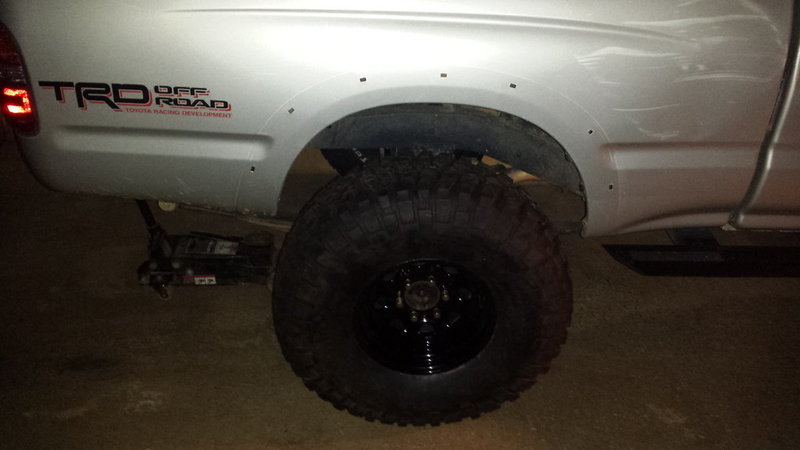

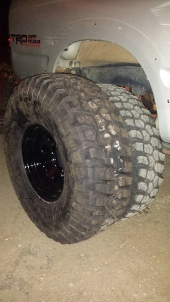

    Engine freshly rebuilt due to blown head gasket, built my own CAI, EGR delete from LCEngineering, Billstein 5125's in the back with GM leafs, I can't stand paying for something that I can make in my garage so I built my own spacers for the front and tweaked them for 3" of lift.
    Has anyone else had issues with tires rubbing only on drivers side?

    I don't have 35's but yes I had/have that problem

    You didn't cut enough.

    I can understand that, but why drivers side only? I corrected the "taco lean" but its back again, I guess I need to put a solid spacer on top until I can SAS?

    Did you fully compress the suspension when you got to cutting sheet metal?
    Or your A arm bushings are trashed and the lower arms are moving around.

    Yep, Im leaning towards the bushings, it seems to be getting worse by the day.

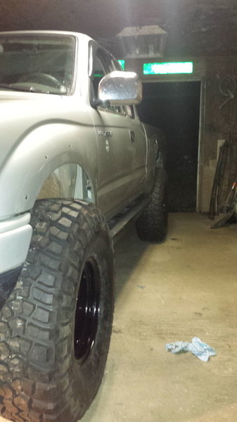

    Well going to pick up a set of new 35x12.50 km2's on 15x8 soft 8's this weekend. Only thing I'm up in the air about ifs what size wheel spacer to run. 1.25 or 1.50? Also front and back our just on the front.

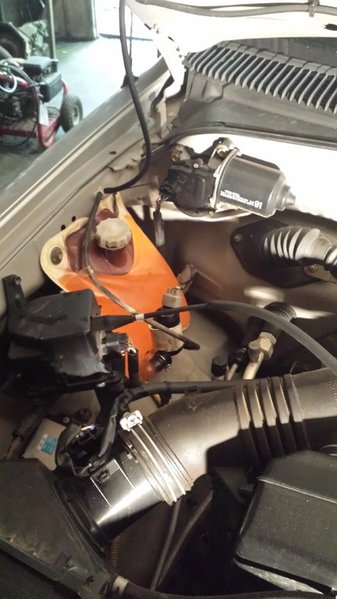

    Another option for your washer fluid resi. Used one from the rear of a 1st gen 4Runner.

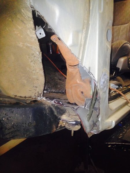

    Trimming yes, and the firewall tub of course. The flares no, it will stay flareless.

    Cutting has begun.
