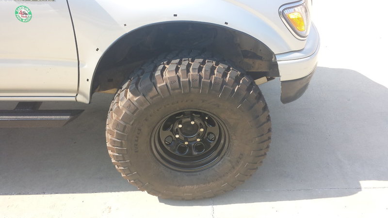

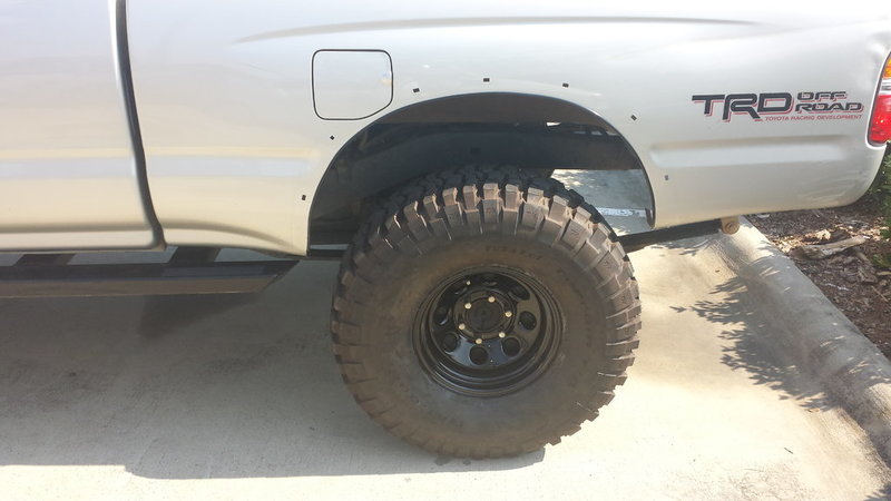

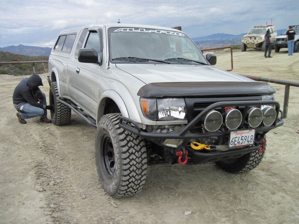

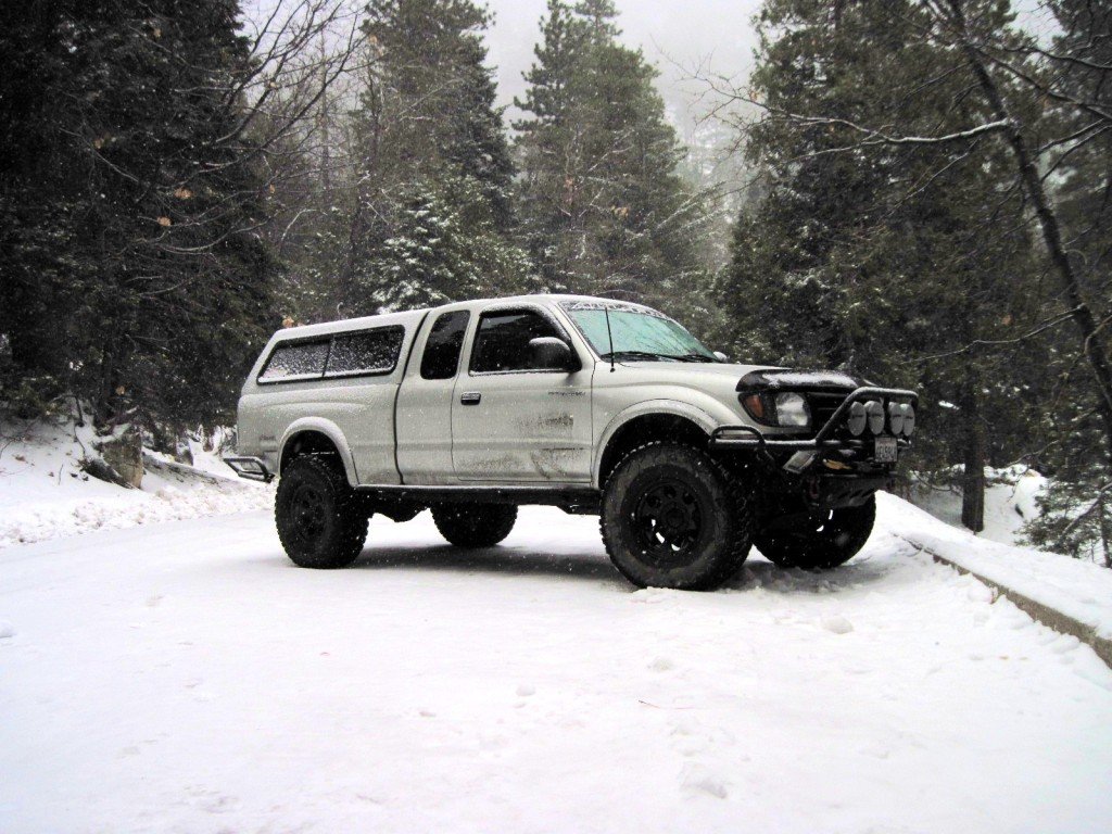

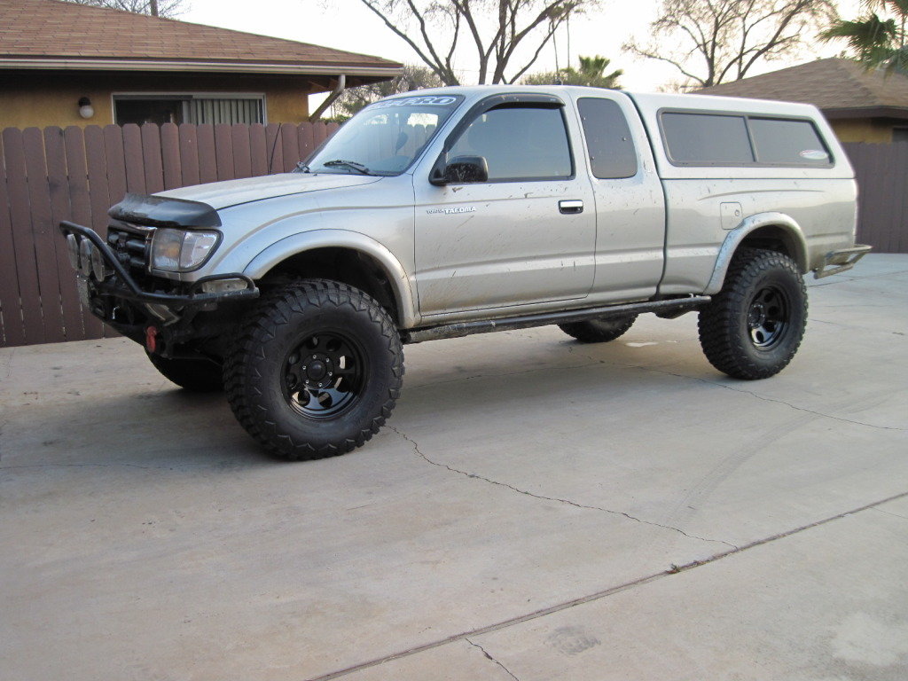

    295/75/16 "D" Load Hankook MT RT03's tend to be closer to a 34" IMO
    33.6" X 11.60"
    most 35's measure less then 35" as well
    Much bigger/heavier then my my BFG KMII 285's were.
    I'd recommend 3.75" backspaced wheels for the 295's.
    ^ I used 6mm billet alloy spacers to avoid a new wheel purchase
    Also had to lengthen the lug studs = not hard but still a pita
    My suspension is between 2.5" - 2.75" of lift.
    still rubs some at max compression (moderate trails)
    as I haven't cut the inner fender(s), yet.
    No serious rub for street duty and lite off road...
    'cept the driver's side scuffs the frame a little at full steer lock.
    4.88's are what I roll... manual trans.
    that with the 5vze rolls 295's fine.
    Still... a 285 was easier to fit...
    and rubbed very little on difficult trail runs.
    Like these RT03 Hankooks...
    but think I'll step back down to the 285's
    next tire purchase.
    If I ran 35's... I'd want 5.29's

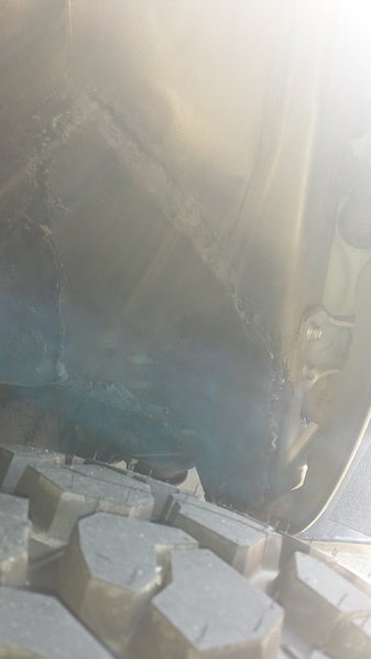

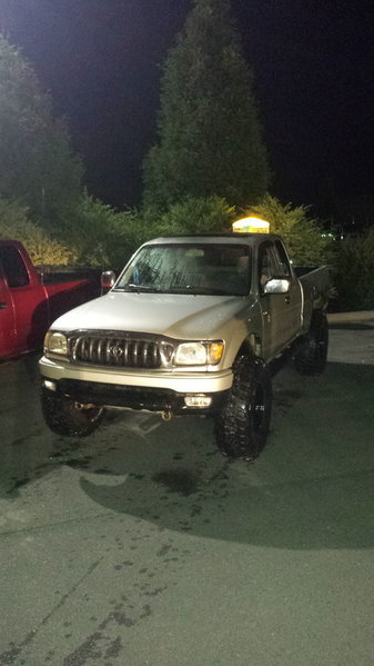

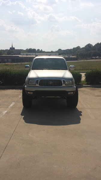

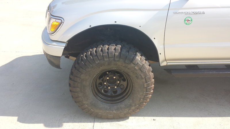

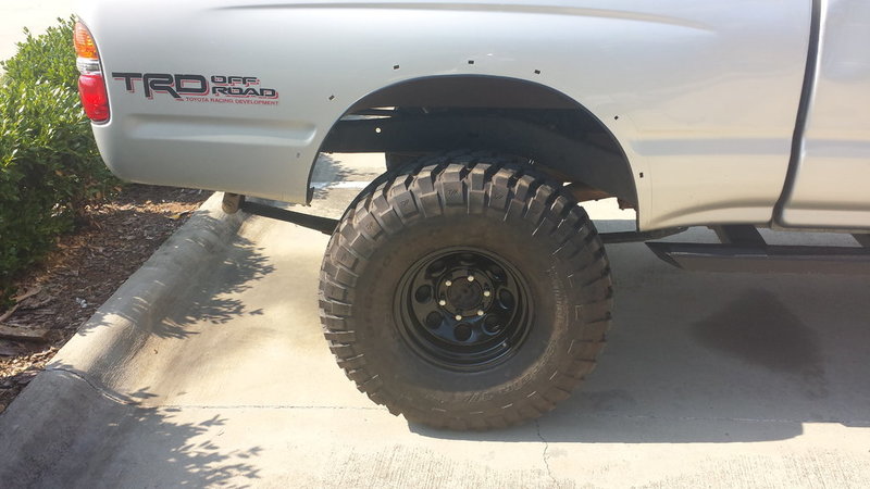

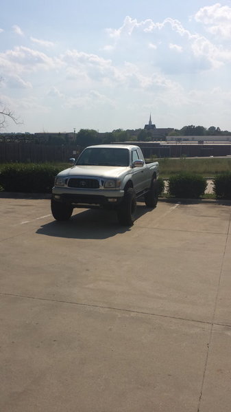

    Just the norm skids, sliders, & 35's

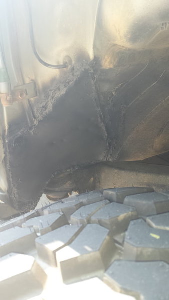

    Sorry for the dark pictures. Next time will budget more time than one day to tub and trim. Will have more pics tomorrow but I'm really happy with how it turned out.
    Moar pics

    However, don't forget, 35s ARE an expensive endeavor. But not due to the tubing. Its the regearing and tires that cost a lot. And the temptation to throw in a front and rear locker(If you're elockerless). That can bring the bill of going to 35s up to 2-5k easy, depending on buying new parts/DIY.
    You don't have to remove the dash lol Just cut slow and you'll be fine. You have to weld slow cause that shit is thin..

    Yeah and keep a fire extinguisher close, caught the harness on the passenger side of my truck on fire. 2 grand seems high but for the time and labor involved that's prob about right. Tires, gears, and material I'm into to mine right at 2500 I think. The gears I paid someone to do but the tub I did my self with help from two buddies and still took ALL day with short breaks.
