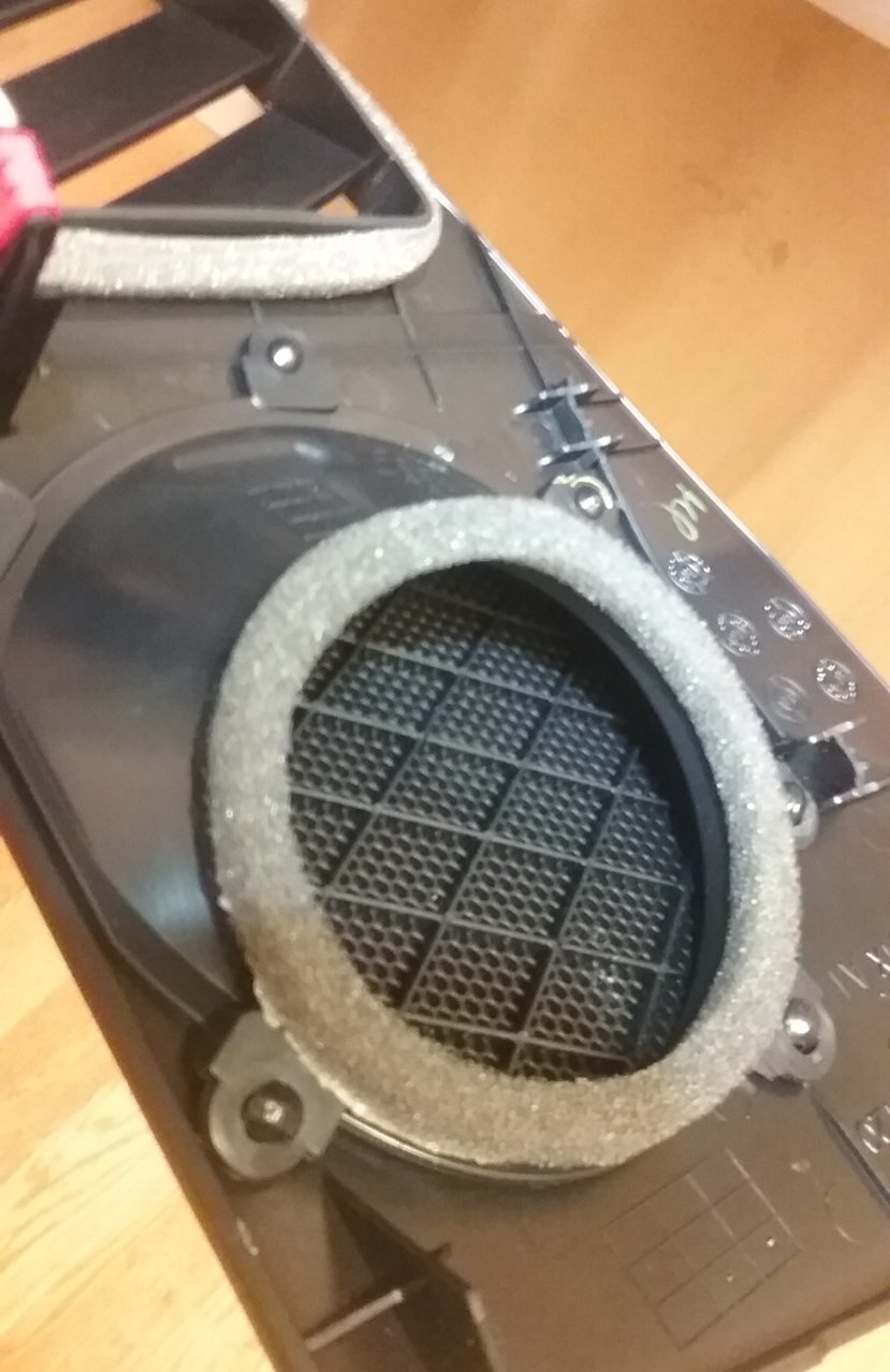

    I did not use any kind of adapter when i installed my illusion audio c3cx. i laid them in with foam around the top.

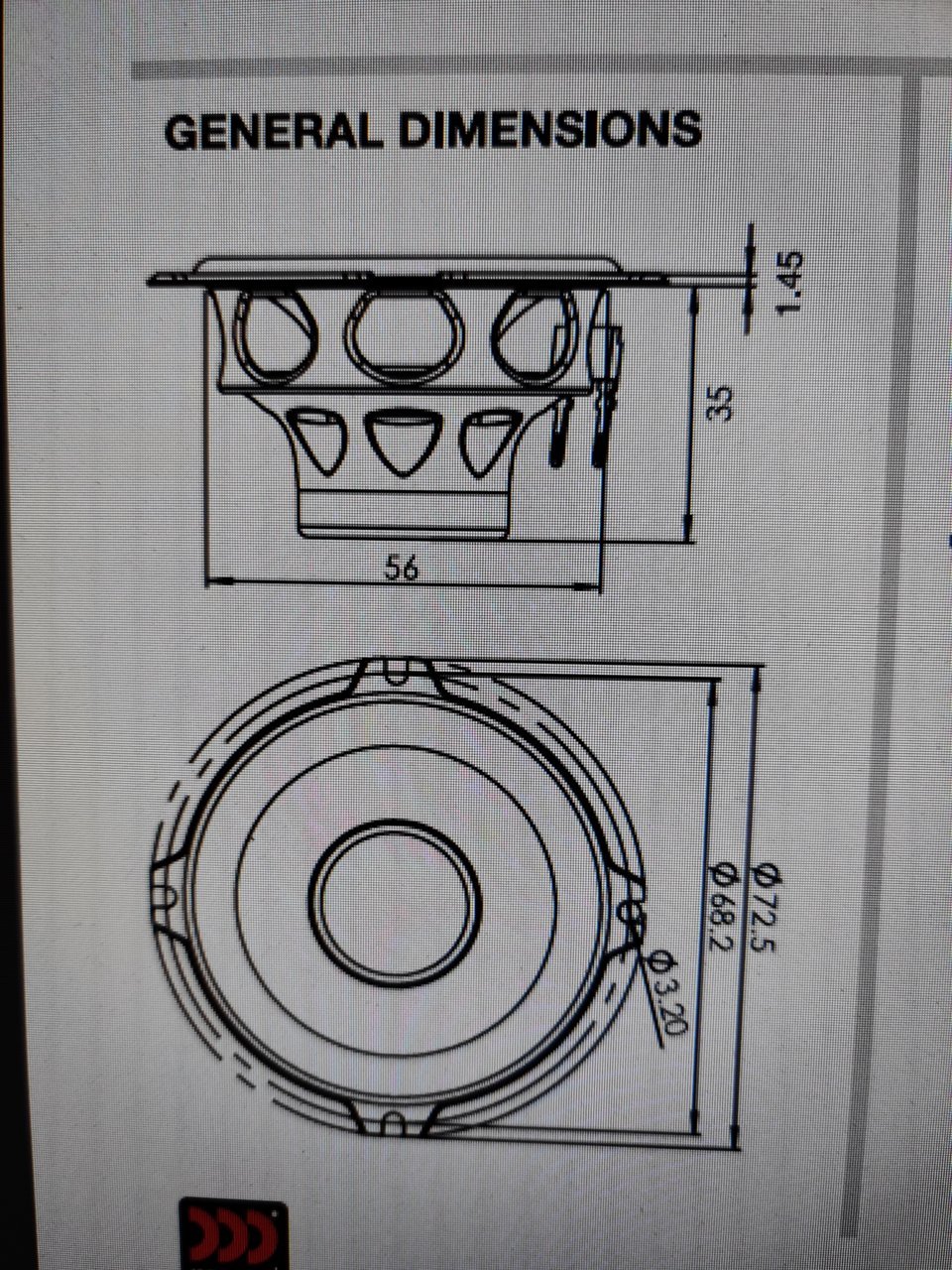

    What are the dimensions hole to hole on the tweeter mounts? The CCWR254s 68.2mm for mounting in the drawing.

    this is all i did with mine. didnt mount it since the grill will hold it down.

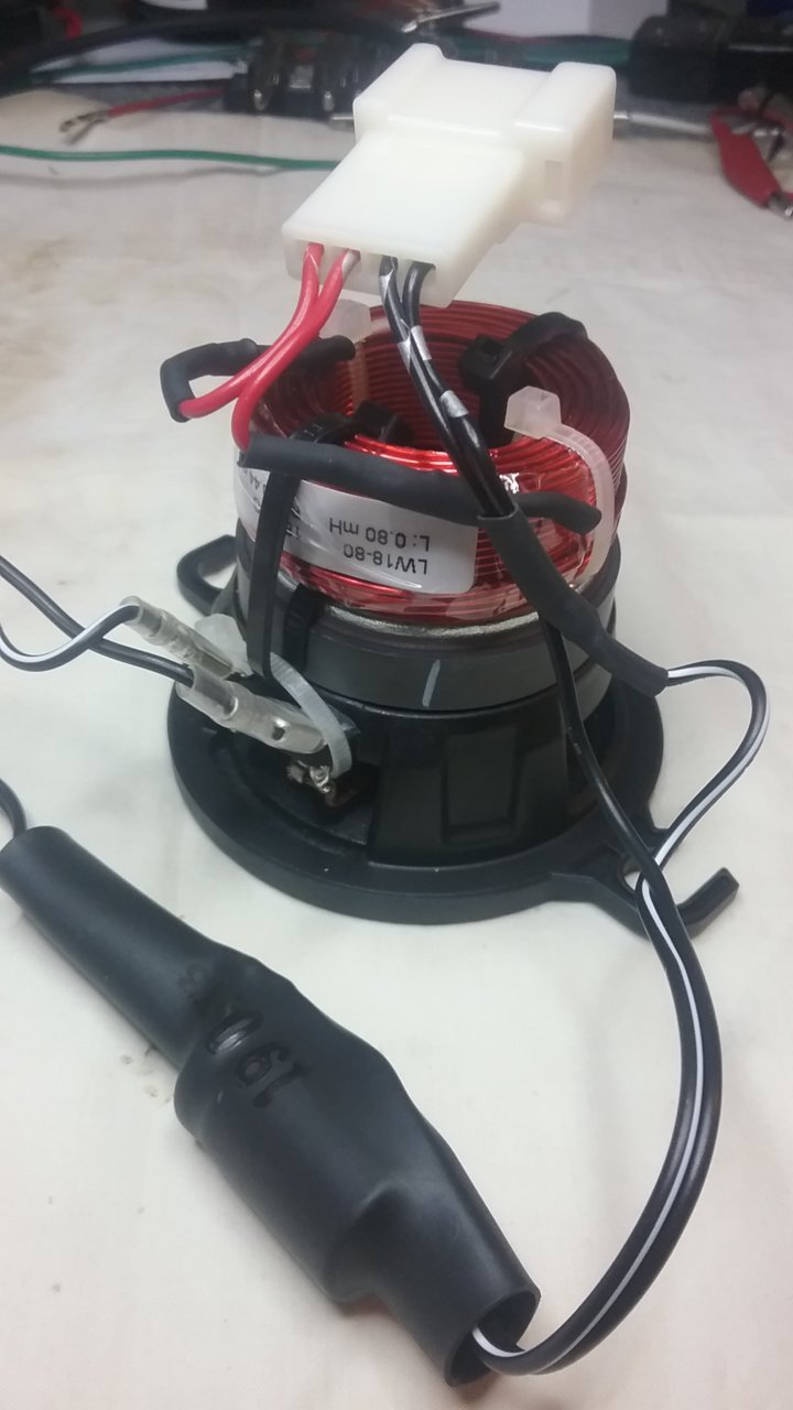

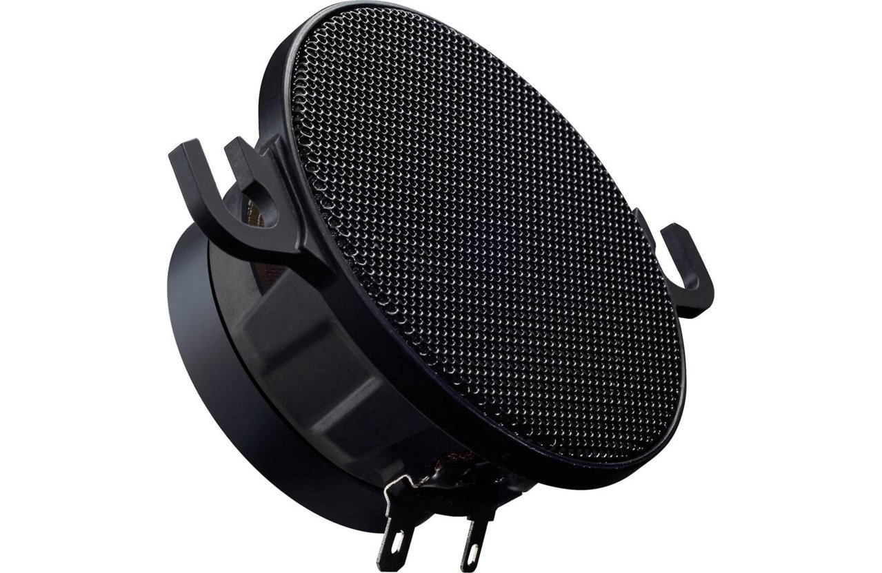

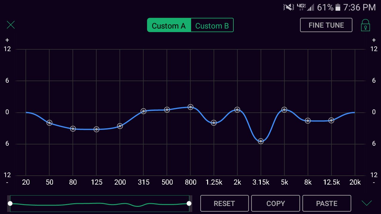

    After living with the Subaru/Kicker tweeters for almost a year, I decided to give the Kenwood Kfc-x2c a try.
    Mainly because of the wide range advertised at 800~20kHz. The goal being, increasing separation in the front stage. I was noticing that listening without any rear fill, the fronts sounded downright monaural!
    These widerange drivers accomplished that goal, but smooth sounding they are NOT! I found they do extend higher than the Kickers, but with a huge spike in output right at 3kHz, combined with a lot of combing . (Probably due to the nature of being bounced off the windshield?).
    Still working at it, but here's where I'm at now with attempting to smooth it all out.
    The Kenwoods do bolt right up, but I needed an adapter harness so I could also add a 0.8mH coil for the door speaker, crossing it over below 800Hz.
    I reused the foam from the original tweeters and added it to the speaker grilles.
    I'm loving the better imaging right now, but the overall response is still far from perfect. On top of that, their low sensitivity
    of only 83dB, means I'm maxing out my little amplifier, adding distortion to the problem.
